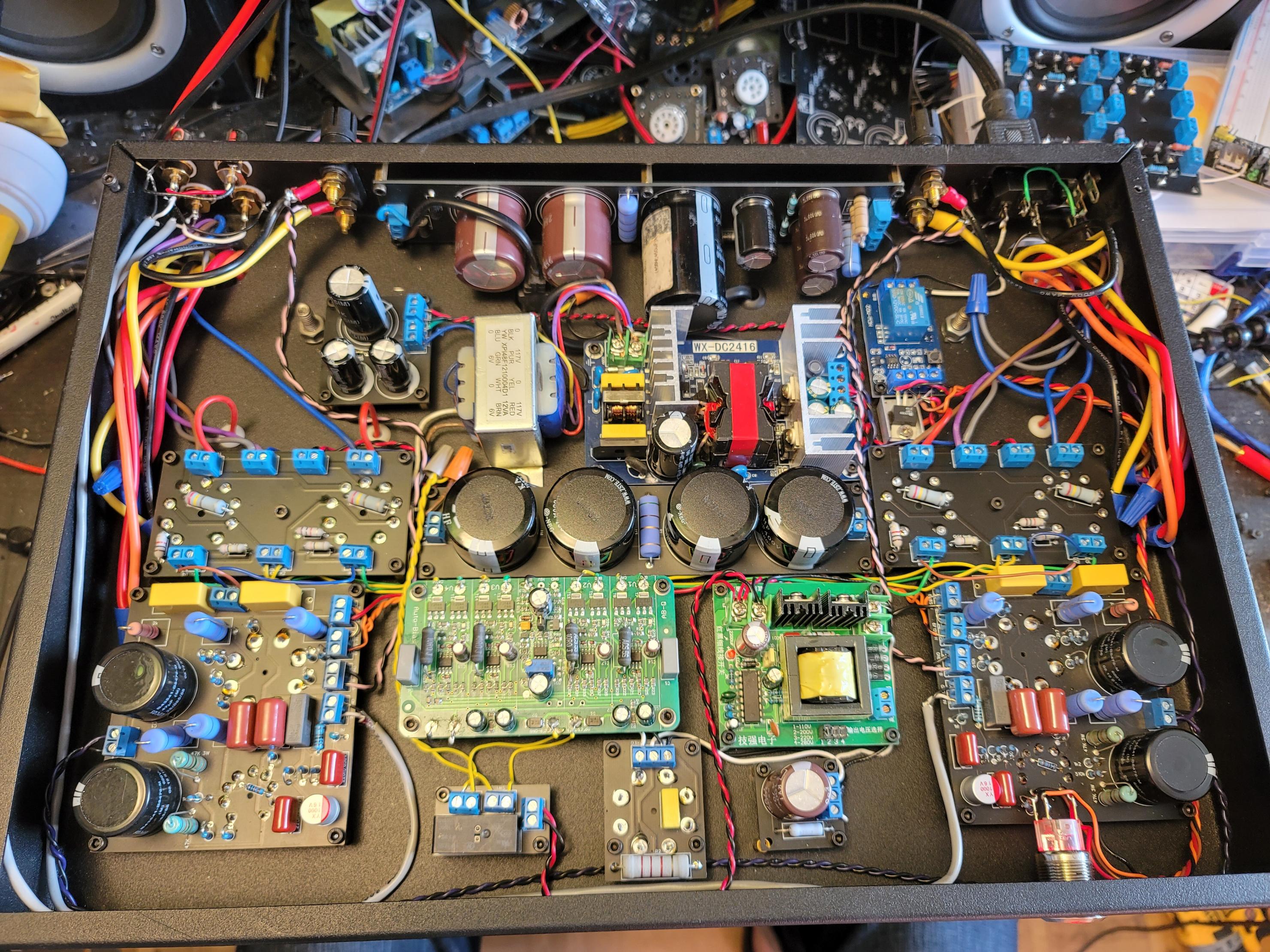

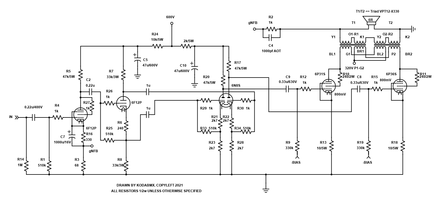

The MA-1 modular amp is born. The 6P31S boards were swapped for the 6P36S boards, and voilà! More power and less distortion. Almost 30 output tubes supported so far.
Actually, I designed it myself with help from the community.
There's a voltage amp using a triode strapped 6F12P pentode section, there's a split-phase inverter, a driver, and then the output board. Pick your board, pick your OPT. It's designed mainly for pushing sweeps as triodes, but one board will work with any typical octal audio tube conplete with jumpers to connect pin 3 to plate ot 1 to 8 for EL34... Sky is the limit really.
I don't think anyone has quite done it like this.
This is version one which requires B435 47u/600V caps. Seeing as nobody else makes one, I made a revision to use normal parts in series.
This is also the first build that uses some nylon fasteners instead of brass... So far, so good.

Certainly. R2 and C4 (the gNFB network) are on the VA/PI board. I've been told if you get replace C7 and R16 with a red LED, distortion goes down.
In theory, you could replace 6F12P with 12AX7 or something, but I think it'd probably be crap. a 6F12P is like 10 12AX7 in parallel based on transconductance alone. OTOH the 6N8S buffers it anyway. Miller might be an issue but it's an audio amp so probably not? Some of the people on this forum have lots of math. I don't but I like to think I make up for it in creativity AOT = adjust on test. if you use the triad coils you don't need to test anything.

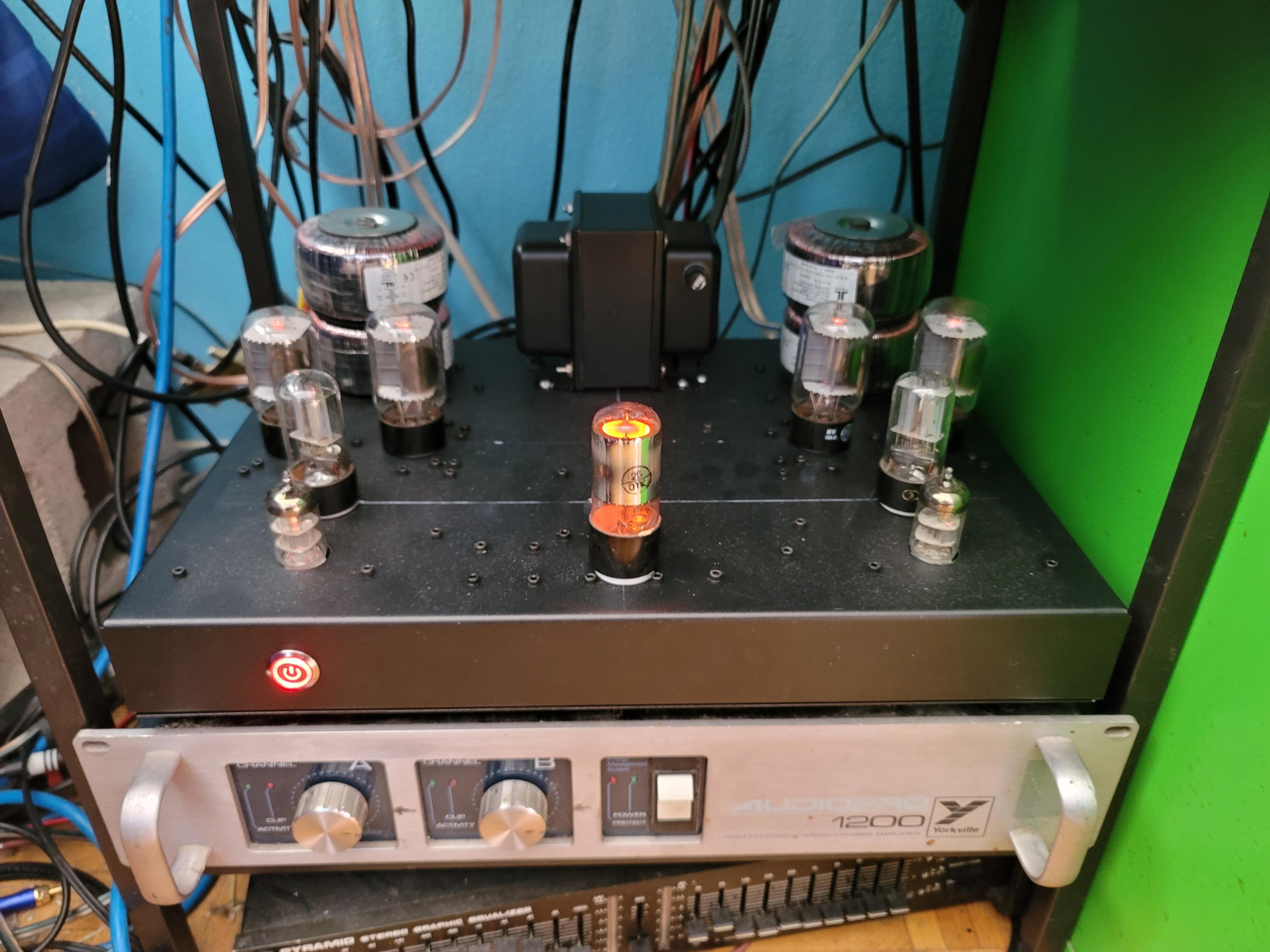

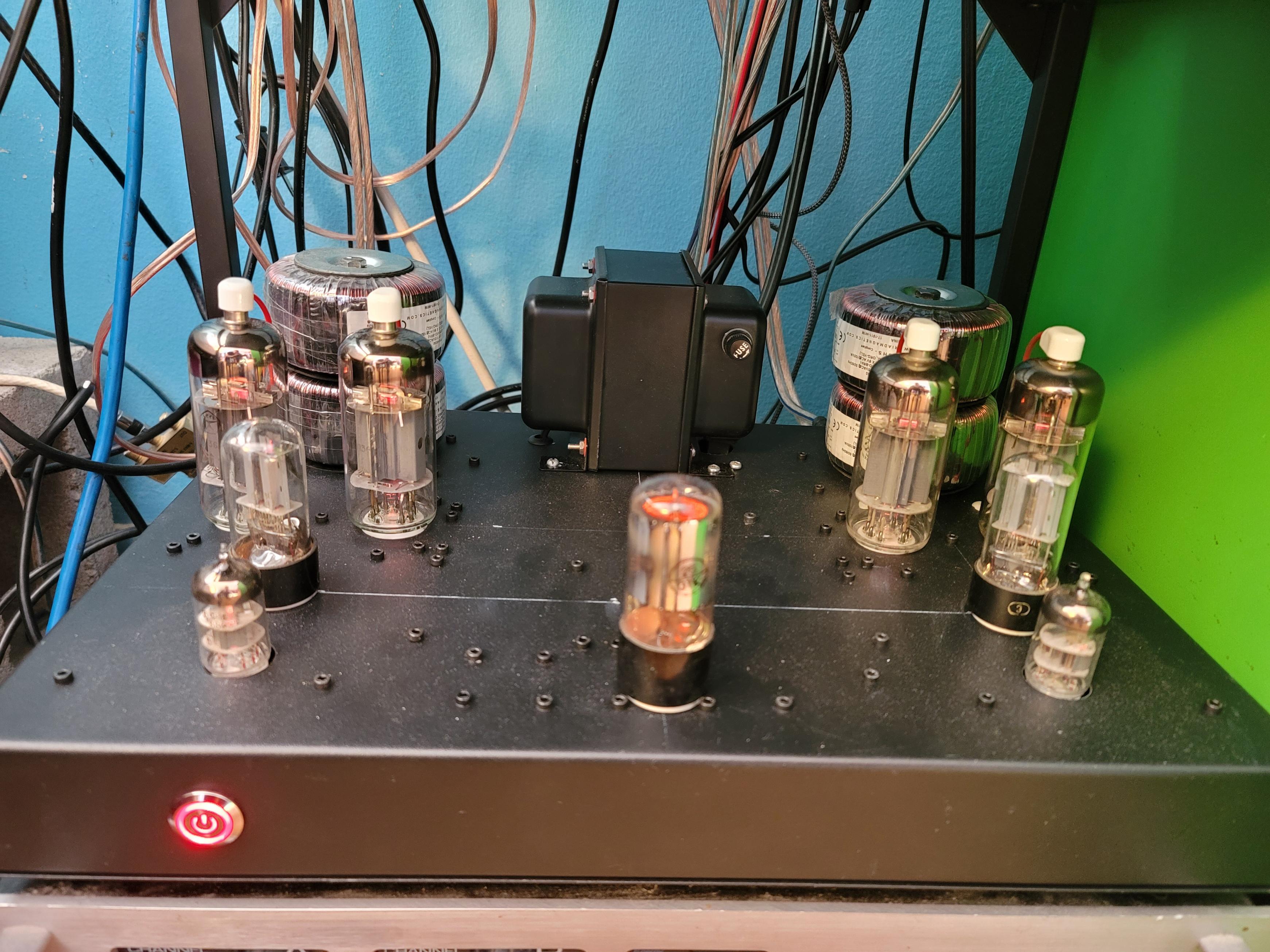

Golly!The MA-1 modular amp is born. The 6P31S boards were swapped for the 6P36S boards, and voilà! More power and less distortion. Almost 30 output tubes supported so far.
Octal sockets came so I built the 6CK octal output boards and installed 12AV5GA tubes. I've never seen Soviet tubes glow like that
They aren't red to the naked eye though. They are running at 320V@60mA.
Photo taken using night mode on a Note 20 Ultra.

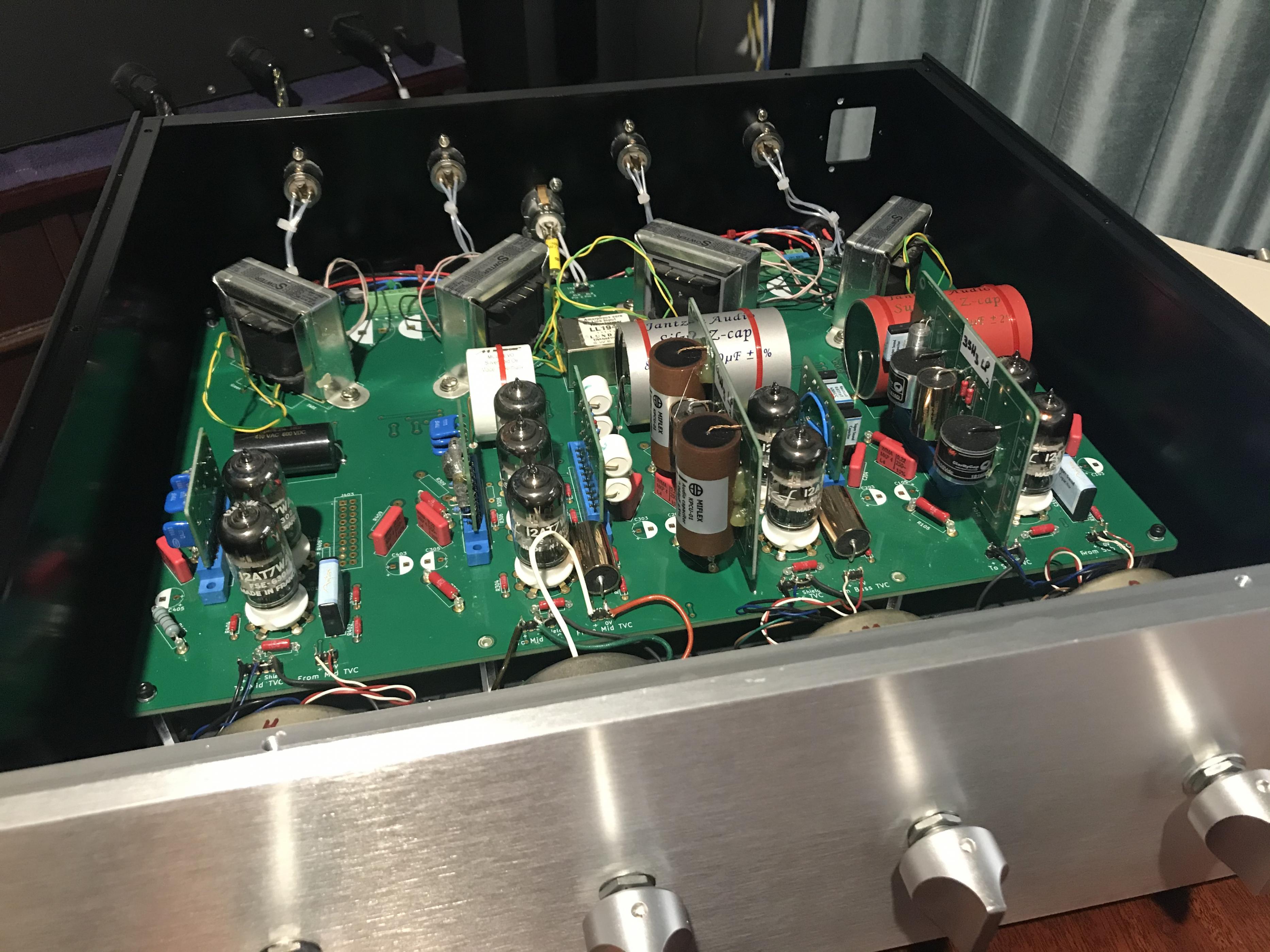

4-way active crossover
Something different. The picture shows 1 channel of a 4-way, 12AT7-based, active crossover.
Removable cards to set the crossover frequencies. Facility for different slopes. Currently building a mechanism to hold the 2 large cards in place.
Balanced in and out. 20dB or so of gain in each section followed by a buffer.
There's heater regulators and ±150V Maida regulators under the main board at the back.
Since I took the photo I've tidied-up the wiring around the output transformers and between the board and the TVCs at the front.
There are 2 separate power supply boxes as well.

This is very interesting for me. Could you share more informations?

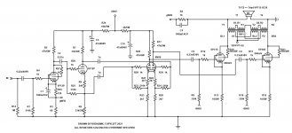

Here's the schematics and measurements. Crossover points are 30Hz, 30Hz to 90Hz, 90Hz to 14kHz (full-range driver here) and 14kHz.

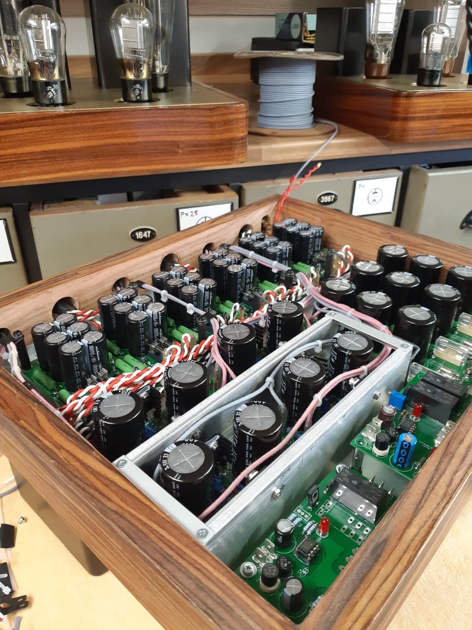

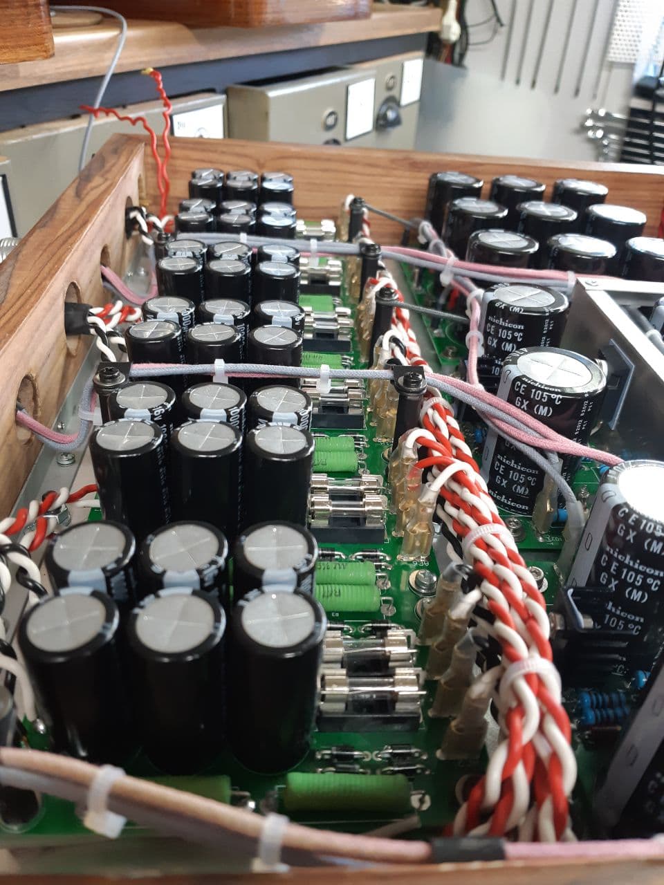

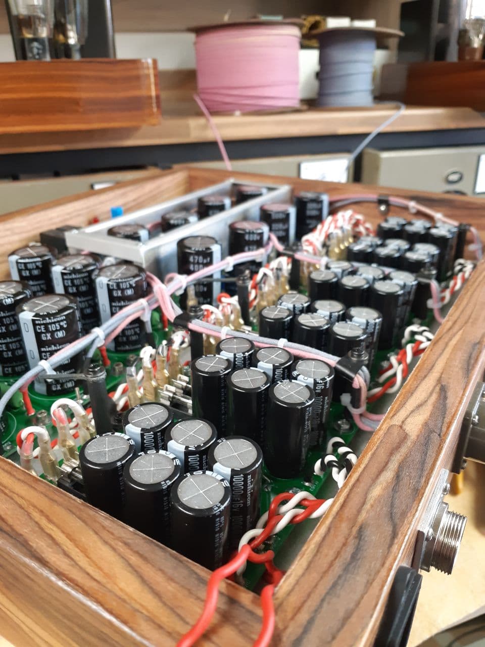

Some photos from someone i do board design for.
This is a build in progress. This is just the underside of a tri-amp system he is building.. Couple of UniversalHV2 boards in there, some delays. Oh and some custom CRCRC boards for feeding six regulators. For Six DHT outputs..
All boards are drawn by yours truely.
