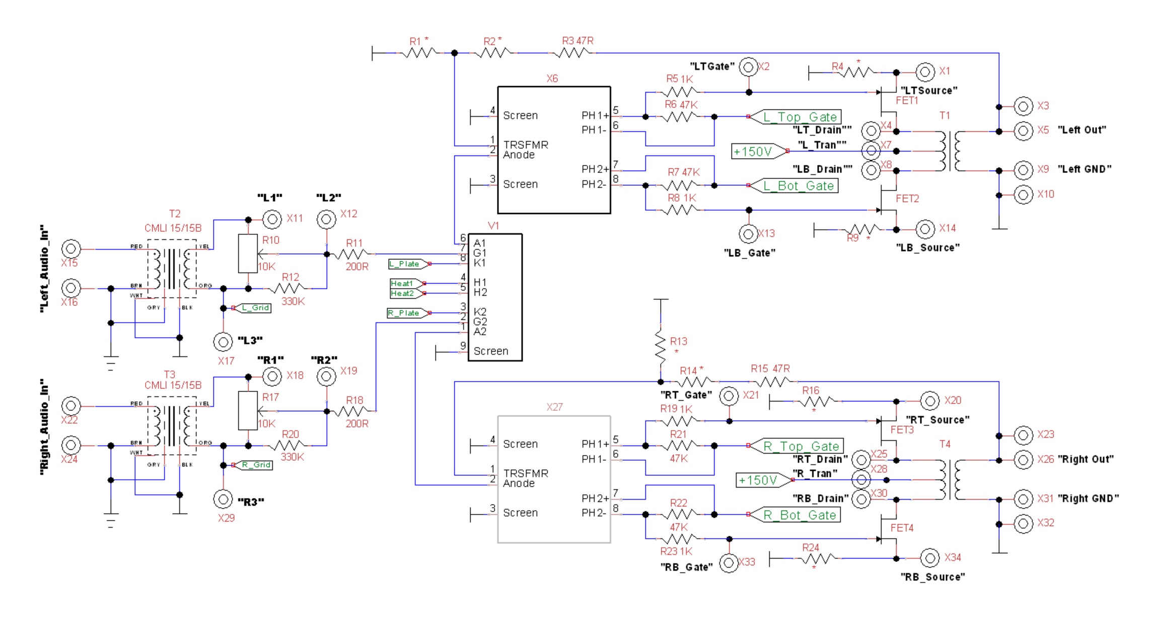

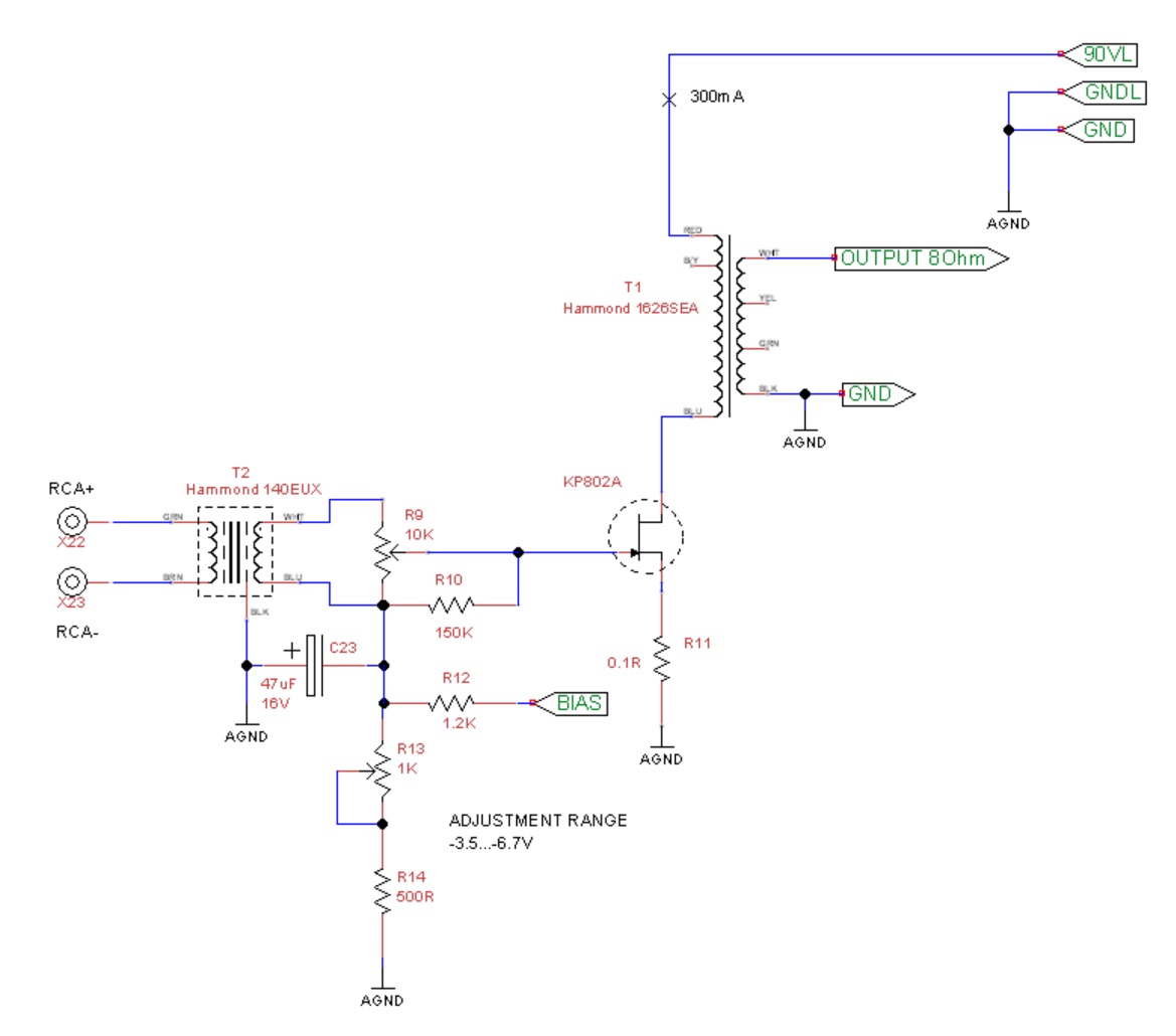

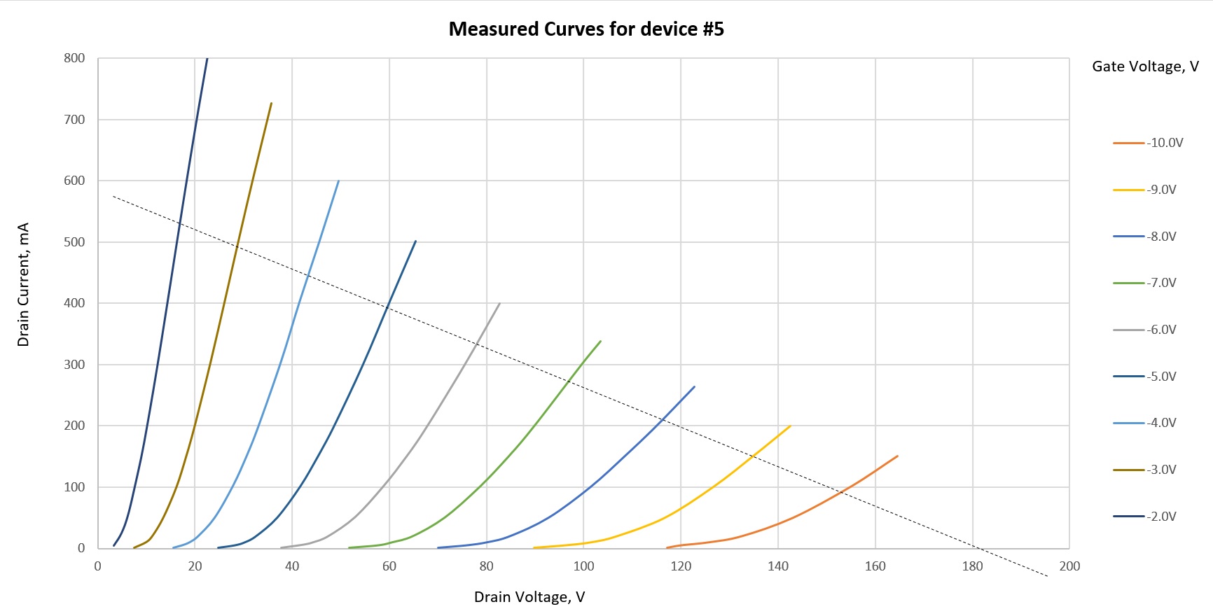

Here is the amplifier circuit, just in case. The SIT is KP802A. The trick is this thing is nowhere close to what is published in the datasheet (it even got the pinout wrong...). I am adding measured curves for one of the devices which is inside. The tube is 6N6P.
A few resistors ended up adjusted for value during debugging and listening. No measurements have been done yet except the max power at 8Ohm - app. 25W and I checked that nothing wrong happens when it is clipping, attached.
Output transformer - Toroidy, the one for 6C33C.

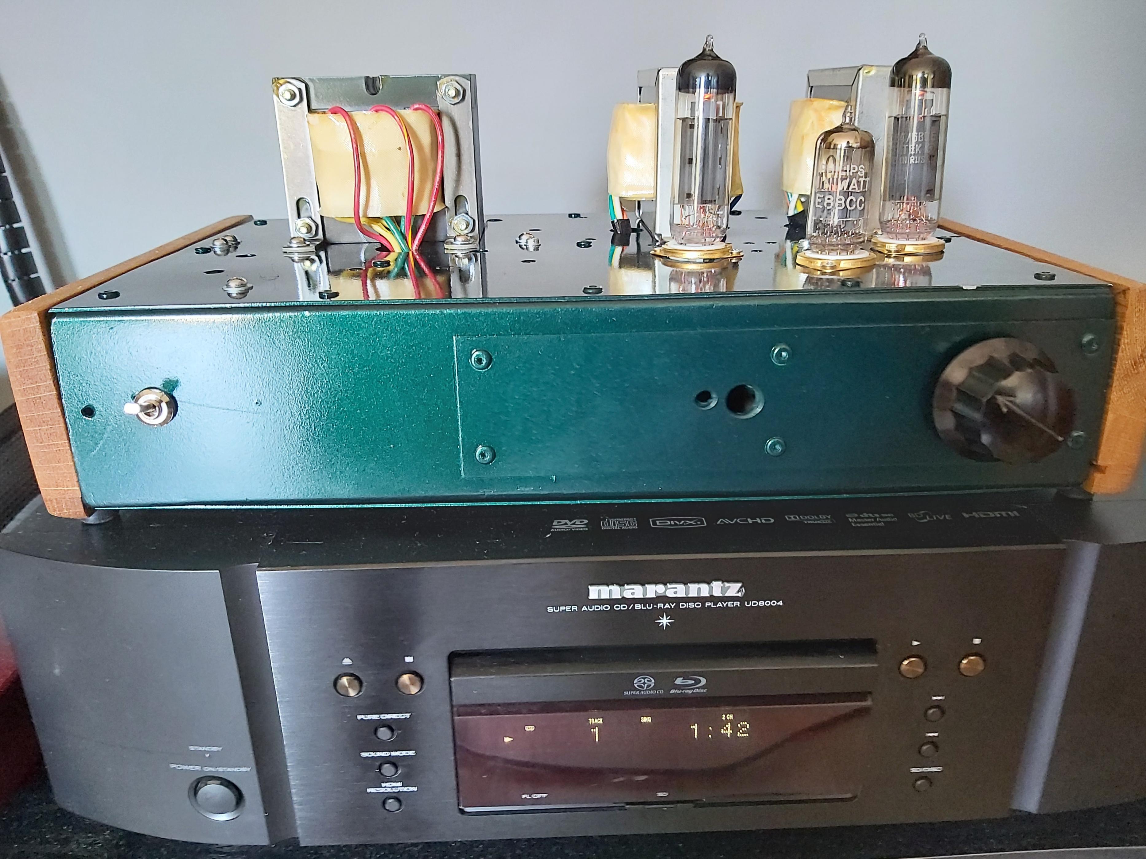

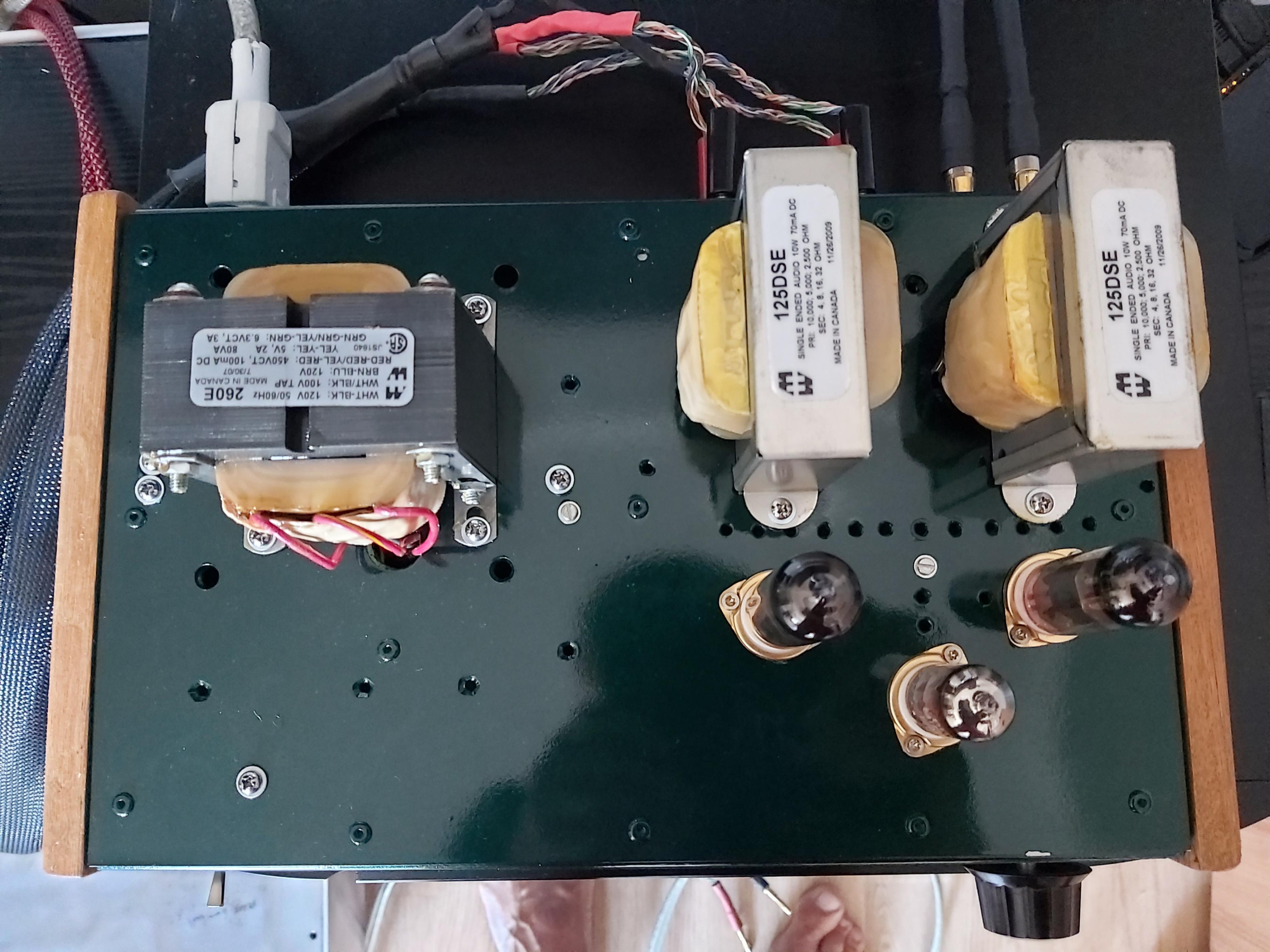

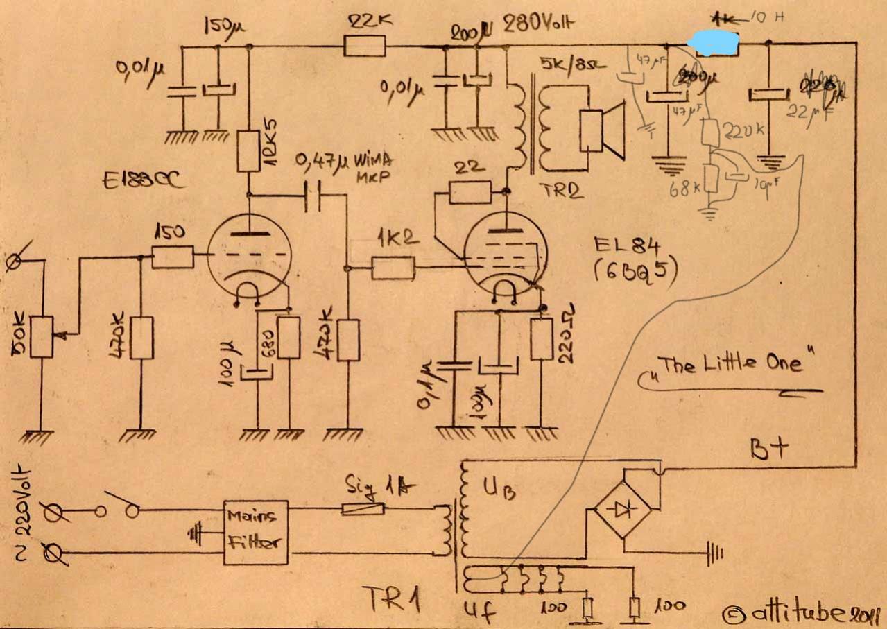

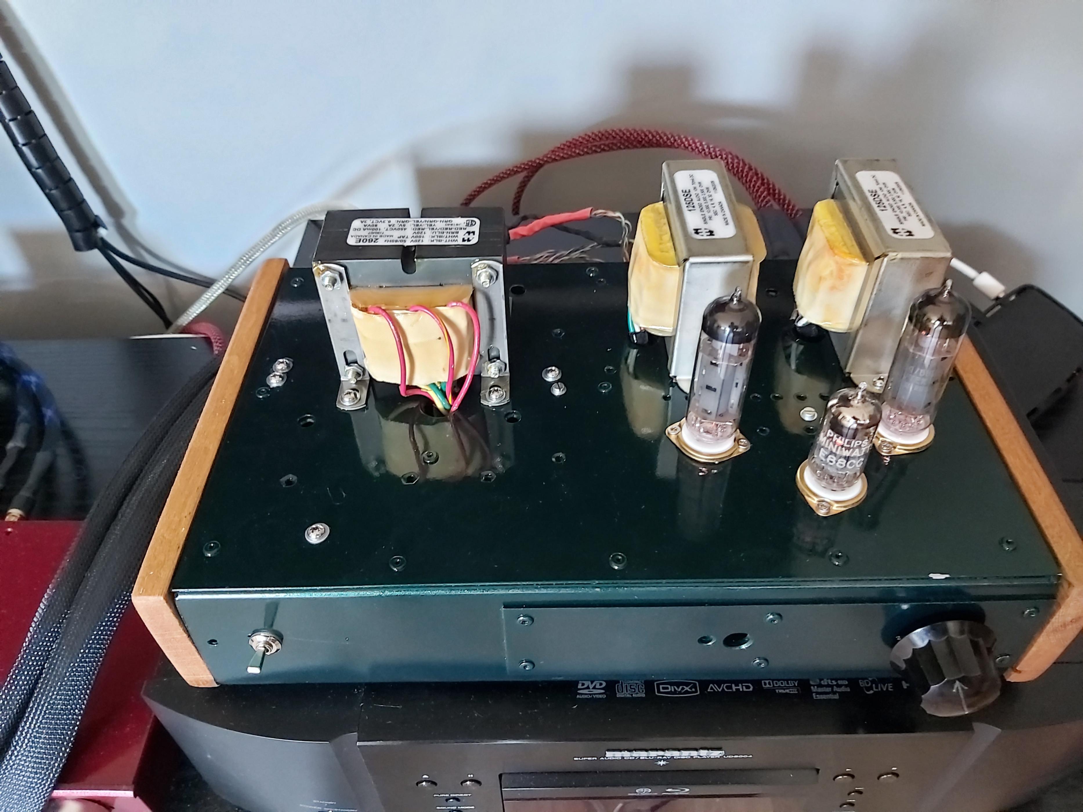

I finally got my El 84 Se Triode wired finished. About 1-1,5 w out to my Klipsch RF15 loudspeakers. Beautiful sound! Just about ONE Watt out and it is enough to fill my livingroom with music!! I think this must be the most musical amp who has been in my stereo systems. Sovtek el 84 and one E88cc from Philips.
stenak,
Nice job!
I love the painted chassis, and the wood ends.
And thanks for the pictures and the schematic.
You should ground one of the output transformer's secondary connections.
Safety First!
And put a 5 Watt 50k resistor across the first cap (220uF) in the B+.
That will bleed down the B+ when you power off the amplifier.
Use a bottom cover, with lots of holes in it for air flow.
Hopefully when you get the bottom cover removed, the bleeder will have discharged the B+ to a safe voltage.
Safety First!
Safety First!
Prevent "The Surviving Spouse Syndrome"
Enjoy the Music!

Low power amps can be fun!
And simple too.
Do not forget to ground one end of the output secondary.
A True EL84 is a True Pentode (with a Suppressor Grid).
A True 6BQ5 is a True Beam Power tube (with Beam Formers).
Some manufactures mark EL84/6BQ5, or 6BQ5/EL84.
Now matter how similar the specs, it can not be both.

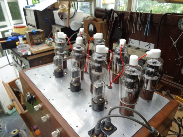

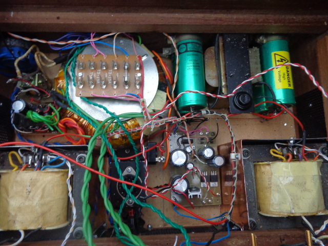

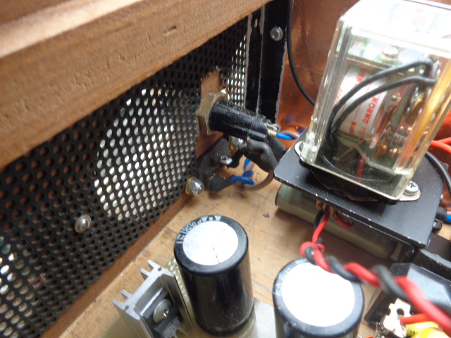

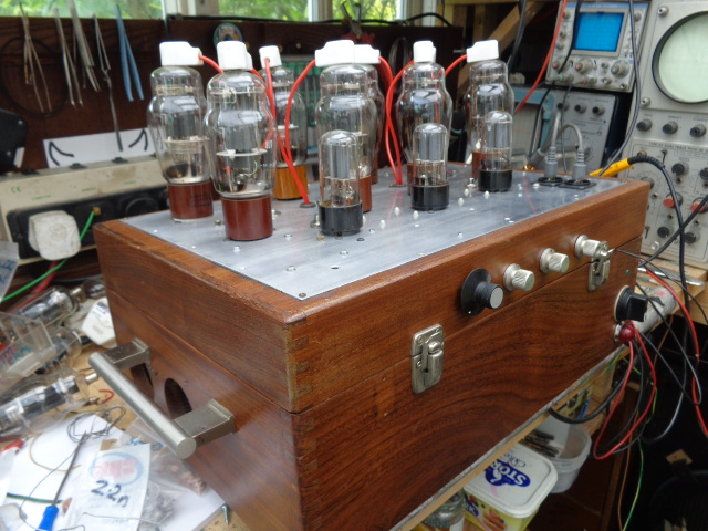

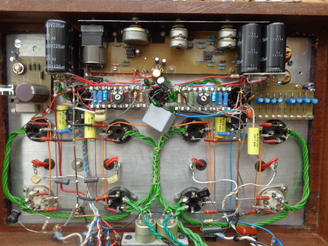

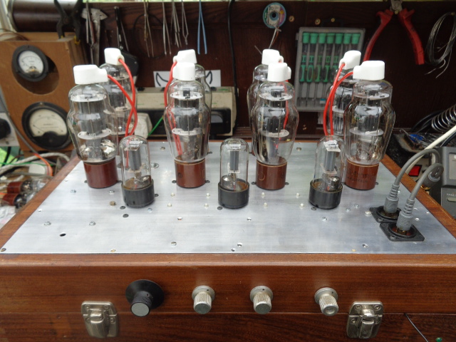

Stereo 50w PPP 807 Class AB1 amp finished, see pics. OPT's wound by my mate in Oz, he also rather kindly sent me 12 NOS 807's still in tropical packing FOC. Bar a few finishing touches it's finished but needs different knobs and something doing with the top ali plate, try as I might I couldn't get it to shine up, the ali is some odd alloy. I did have one painted up, but screwed it up drilling holes in the wrong place, then ran out of paint.
This one was a bit of a roller coaster, I had it all working, then by a stupid mistake burnt out a winding on the mains tfmr, so out it came and I rewound it from scratch. Put rewound mains tfmr back in, amp played up big time, which to cut a long story short I fixed with a 2200p cap from one CCS zener reference to ground.
A few brief details... case old Pye Wheatstone bridge, teak or mahogany perhaps, OPT's 3k4 Z pri/8r sec - UL tapped (not used at present) stack 3 3/3" x 4" x 3 3/4" deep. Mains tfmr 625VA toroid, handwound by myself, overwound. CLC filter, 10 second delayed start, Rod Elliot hifi preamp front end into 6H8C common cathode triode gain stage into 6H8C LTP - CCS. Protection circuit - if any valve exceeds 140mA Ik relay cuts neutral of mains tfmr.
F response 1dB @ 20hz and 30khz, THD 0.6% @ 21.47v RMS 440hz, 0.5% @ 19.7v RMS 20khz.
Bit more tidying up & tweaking to do so forgive the odd stray wire and tacked in caps .
