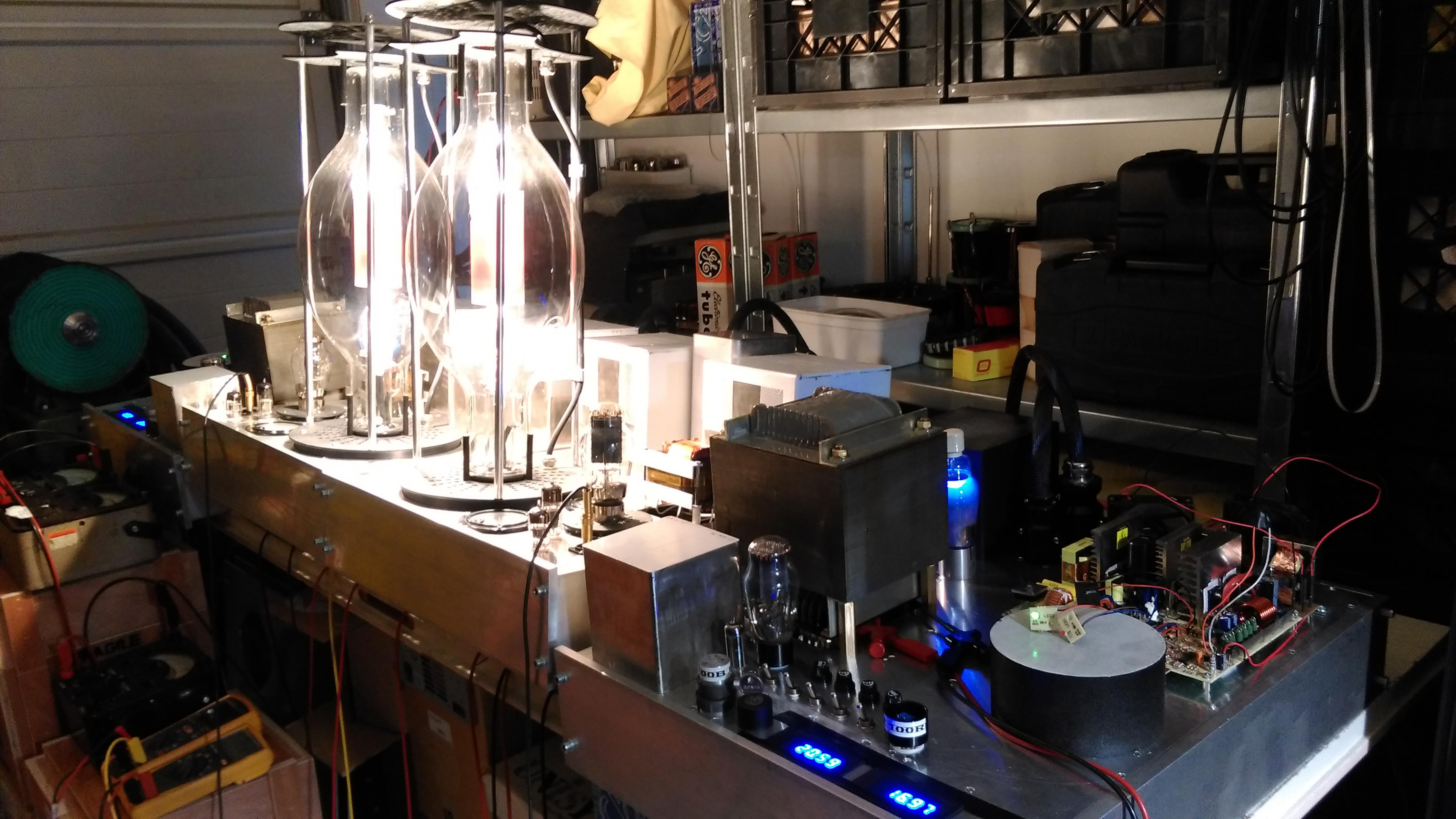

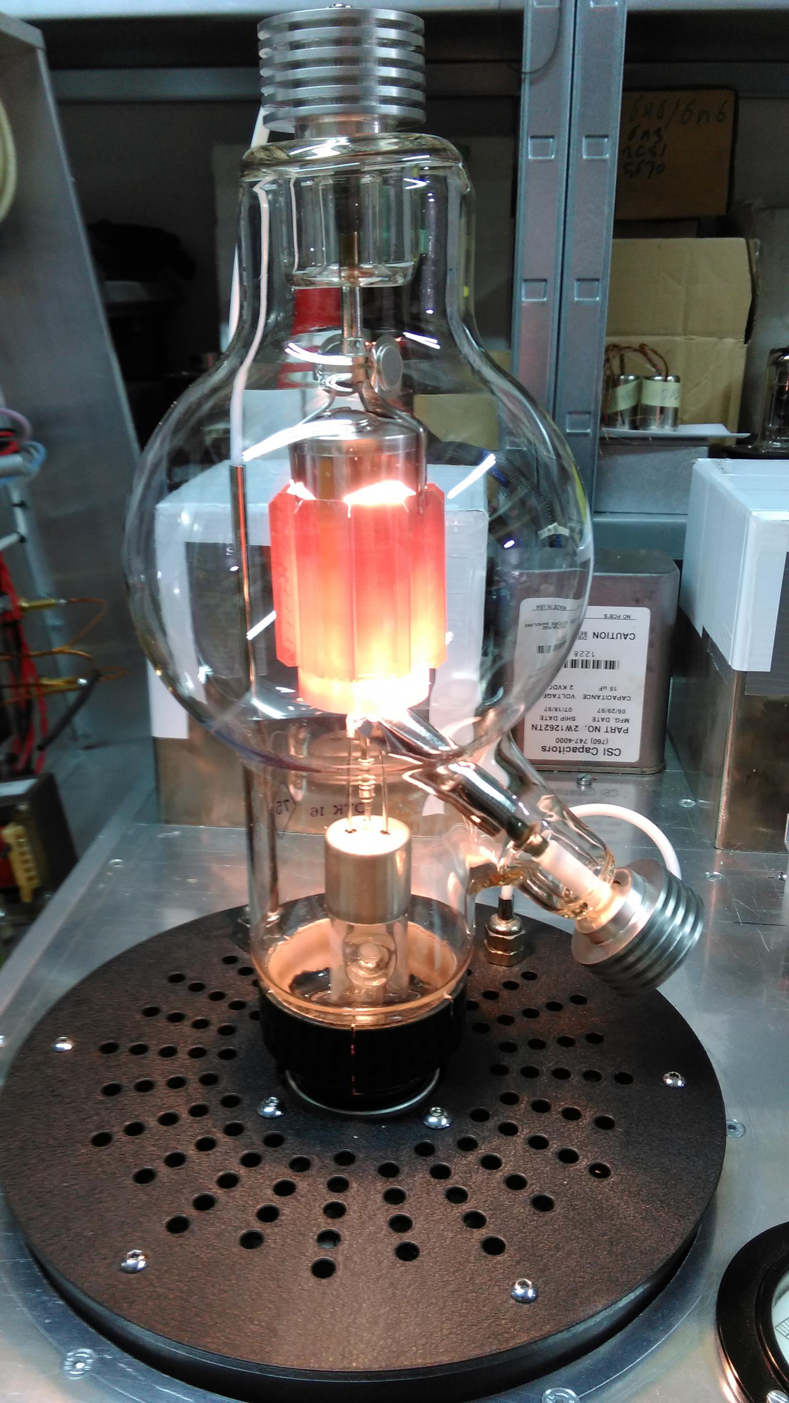

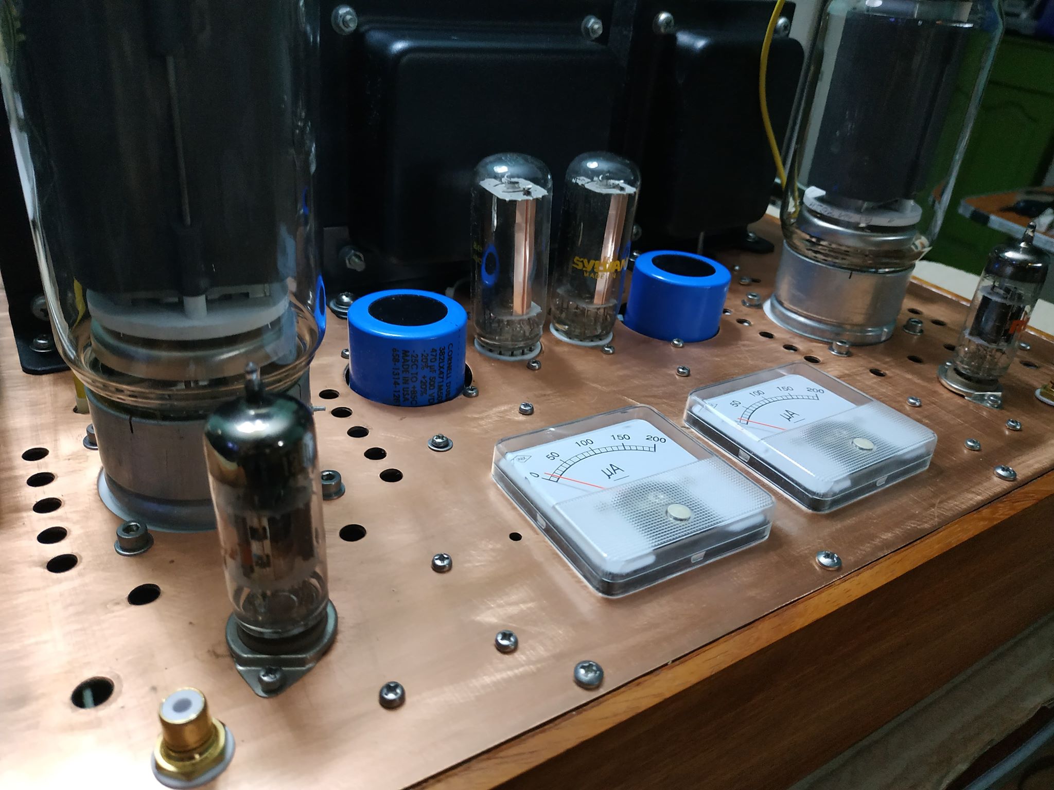

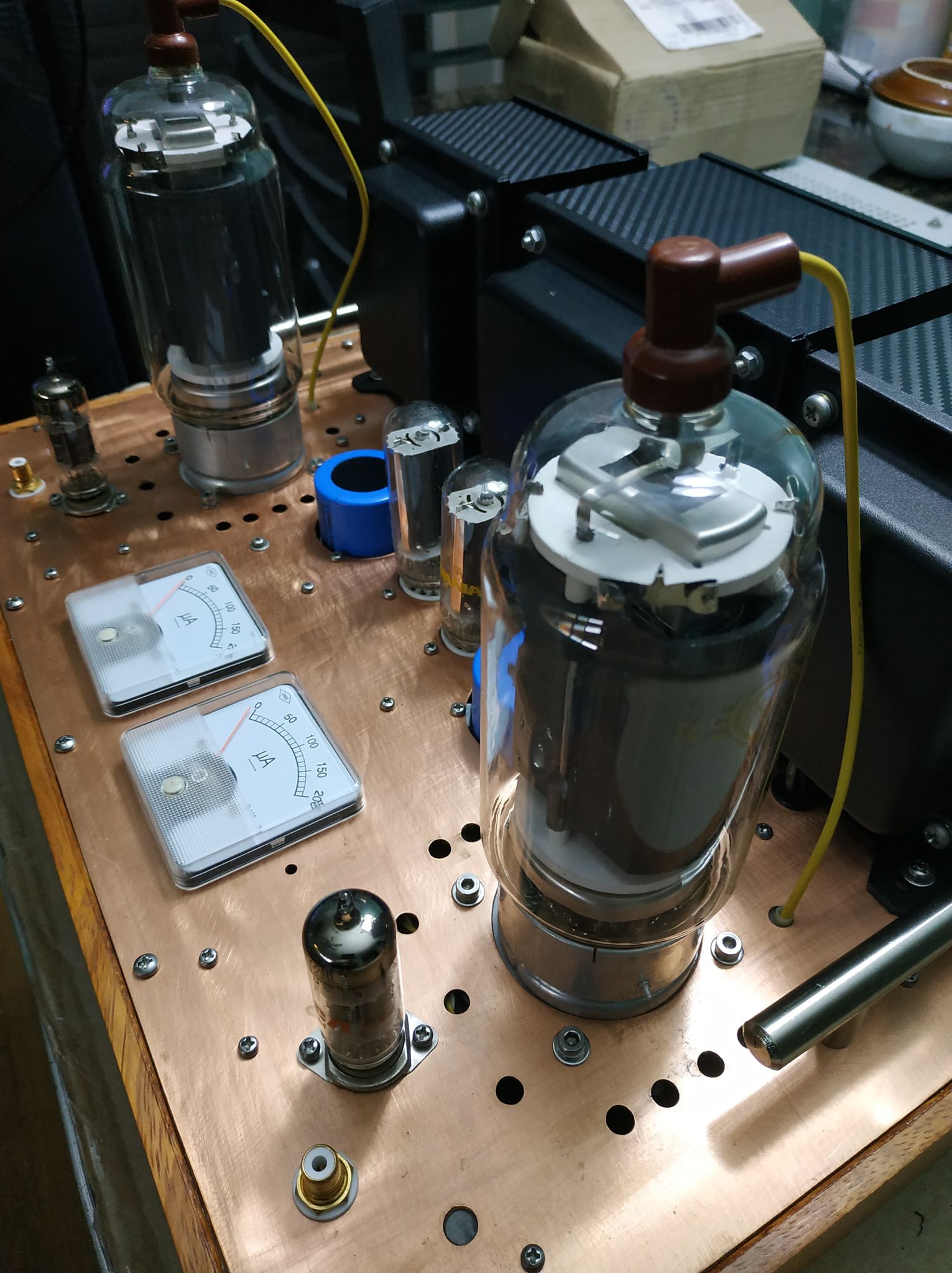

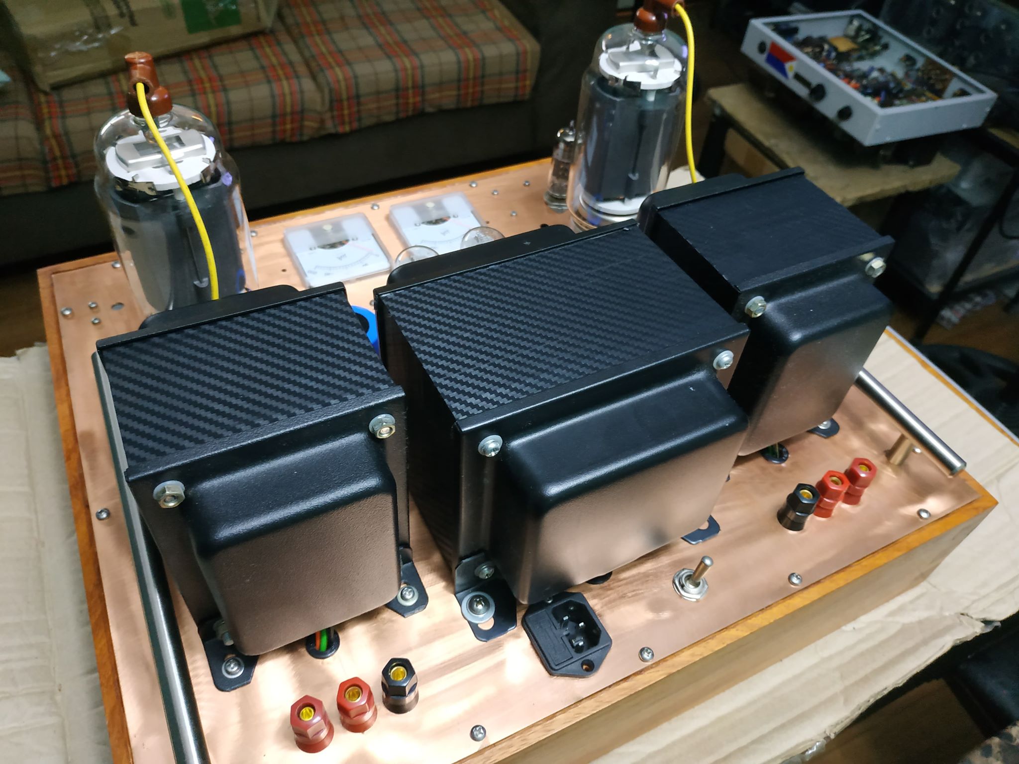

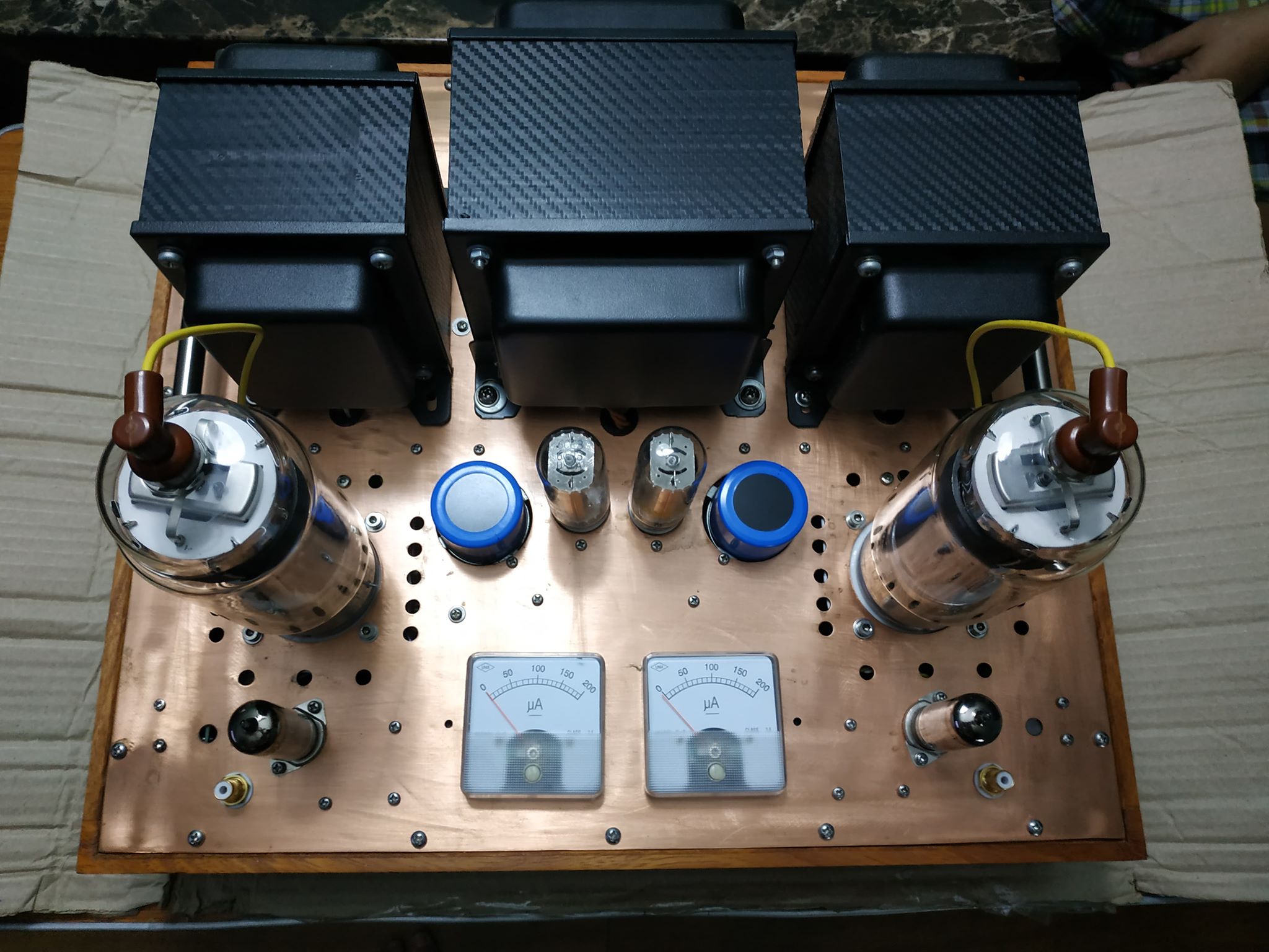

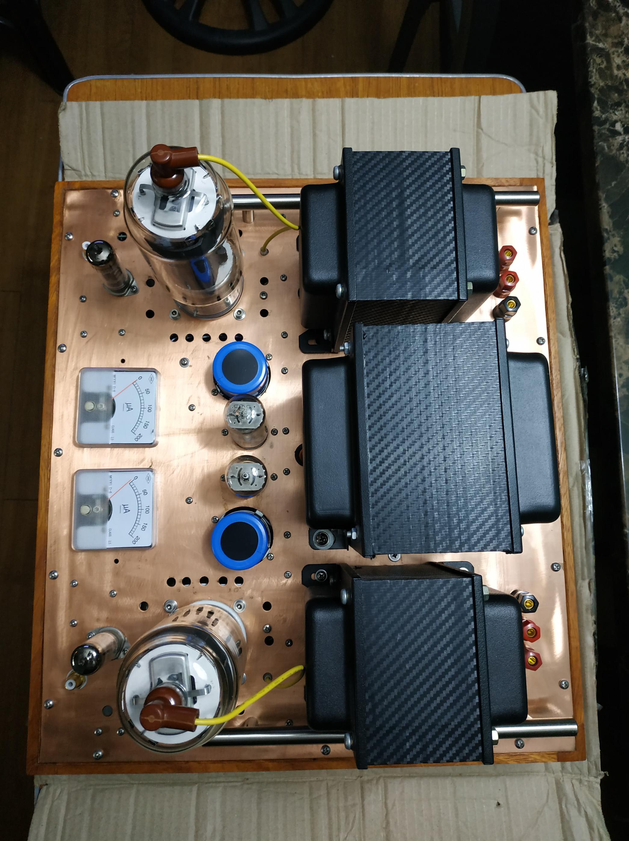

GK71 amp....12hl7 pentode voltage amp, assisted by 2sk3565 mosfet follower...

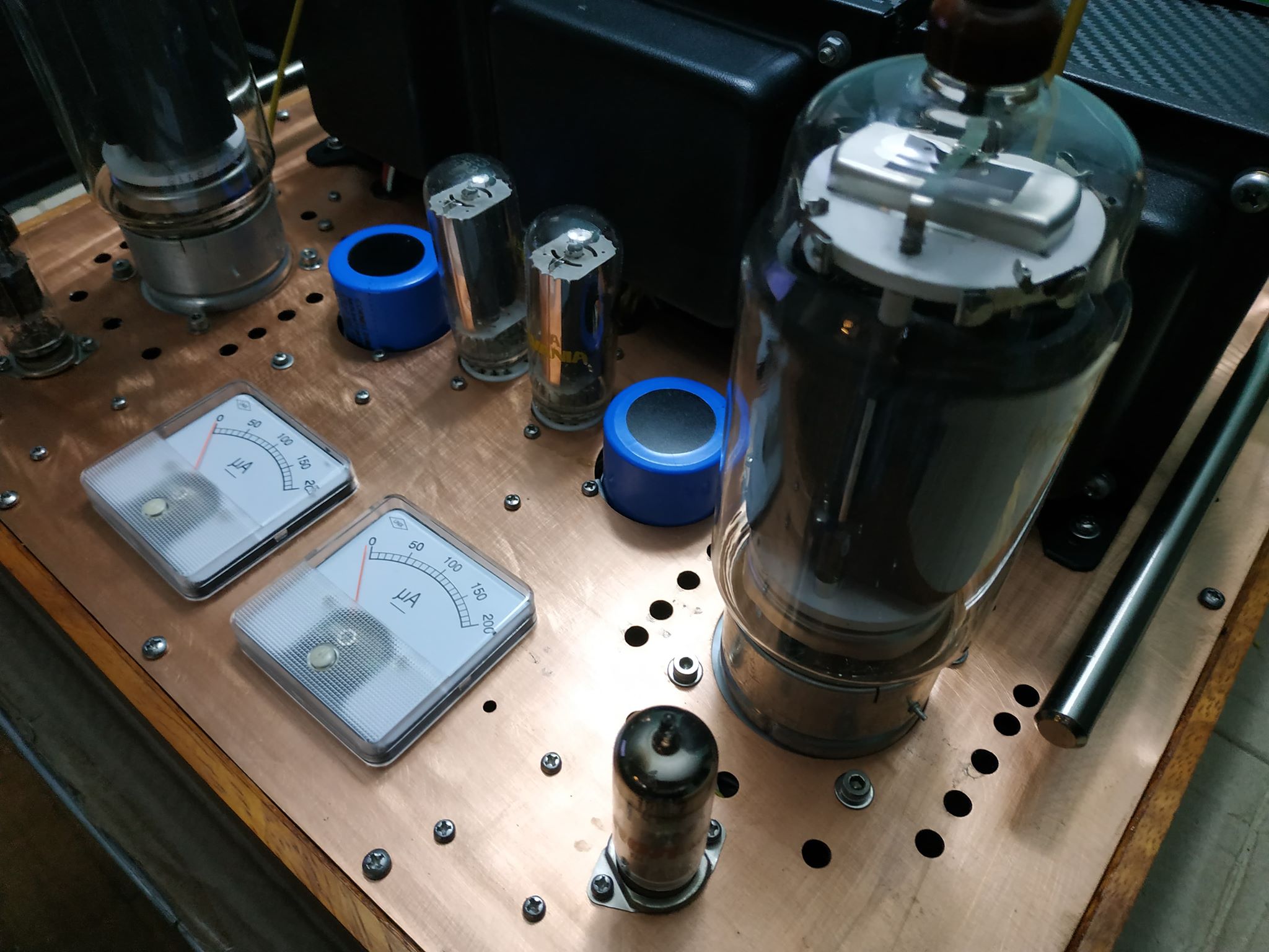

Which tube is the output amp
@Shef: Could you say which tube is the octal one in the picture?

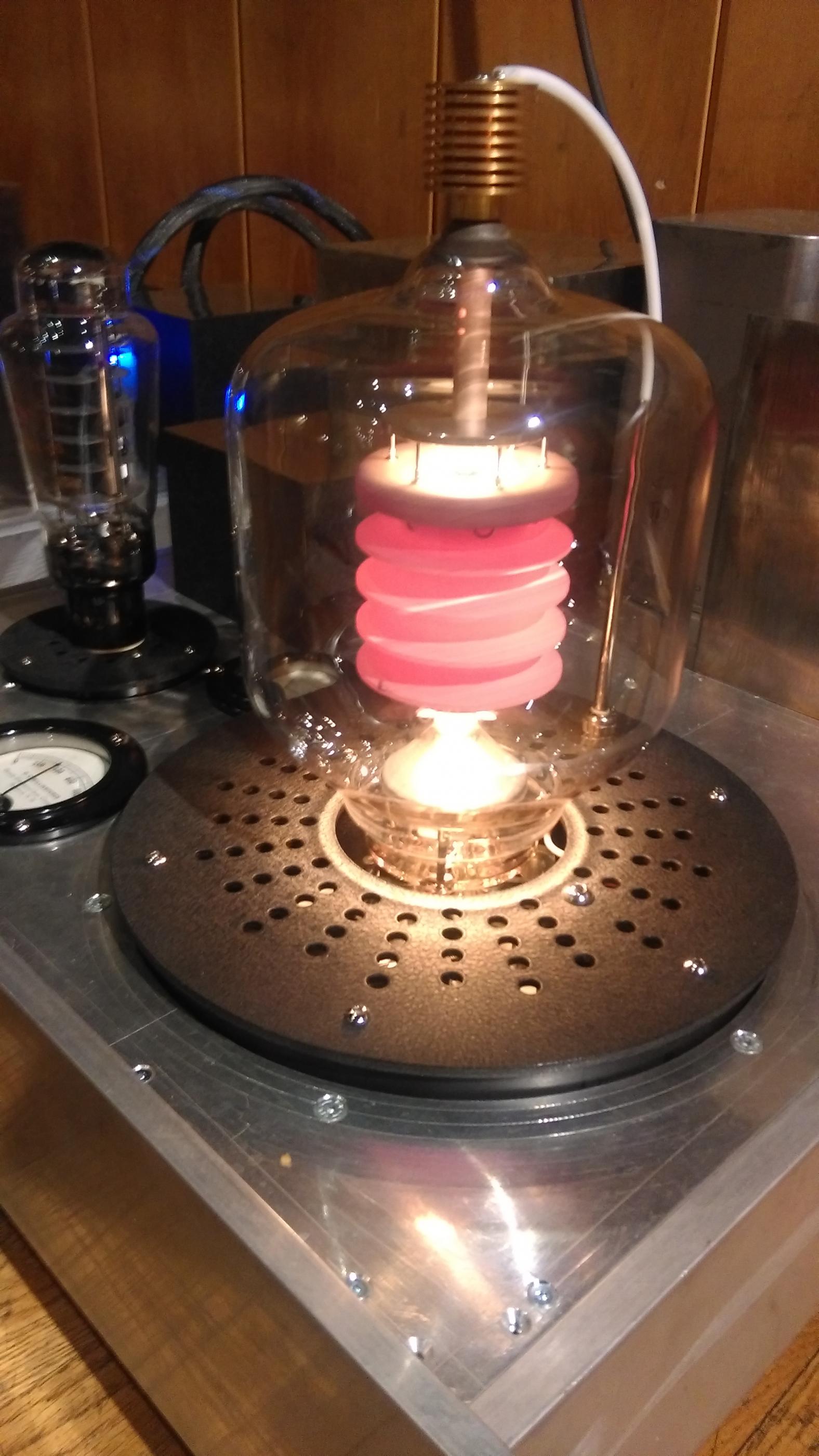

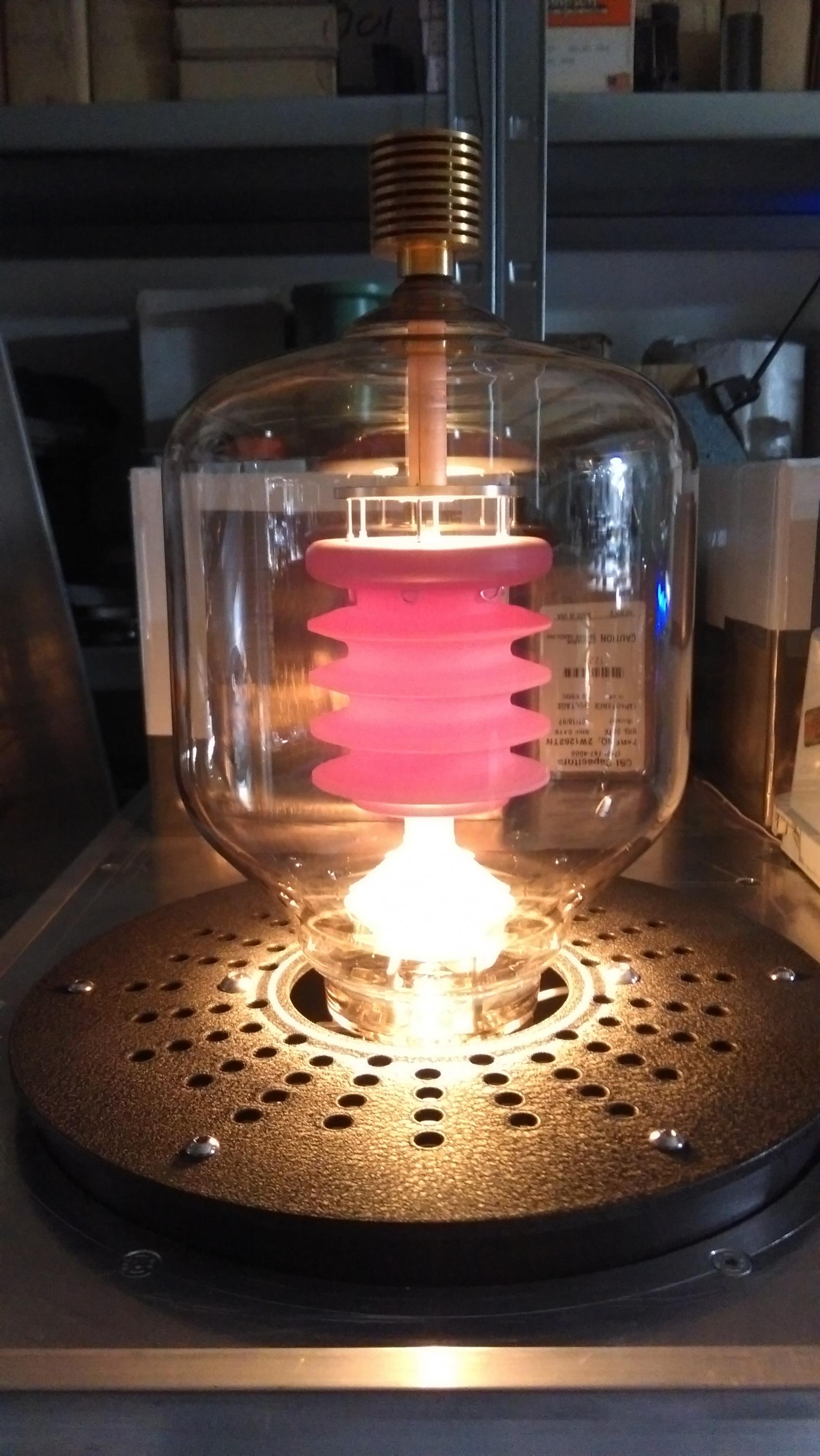

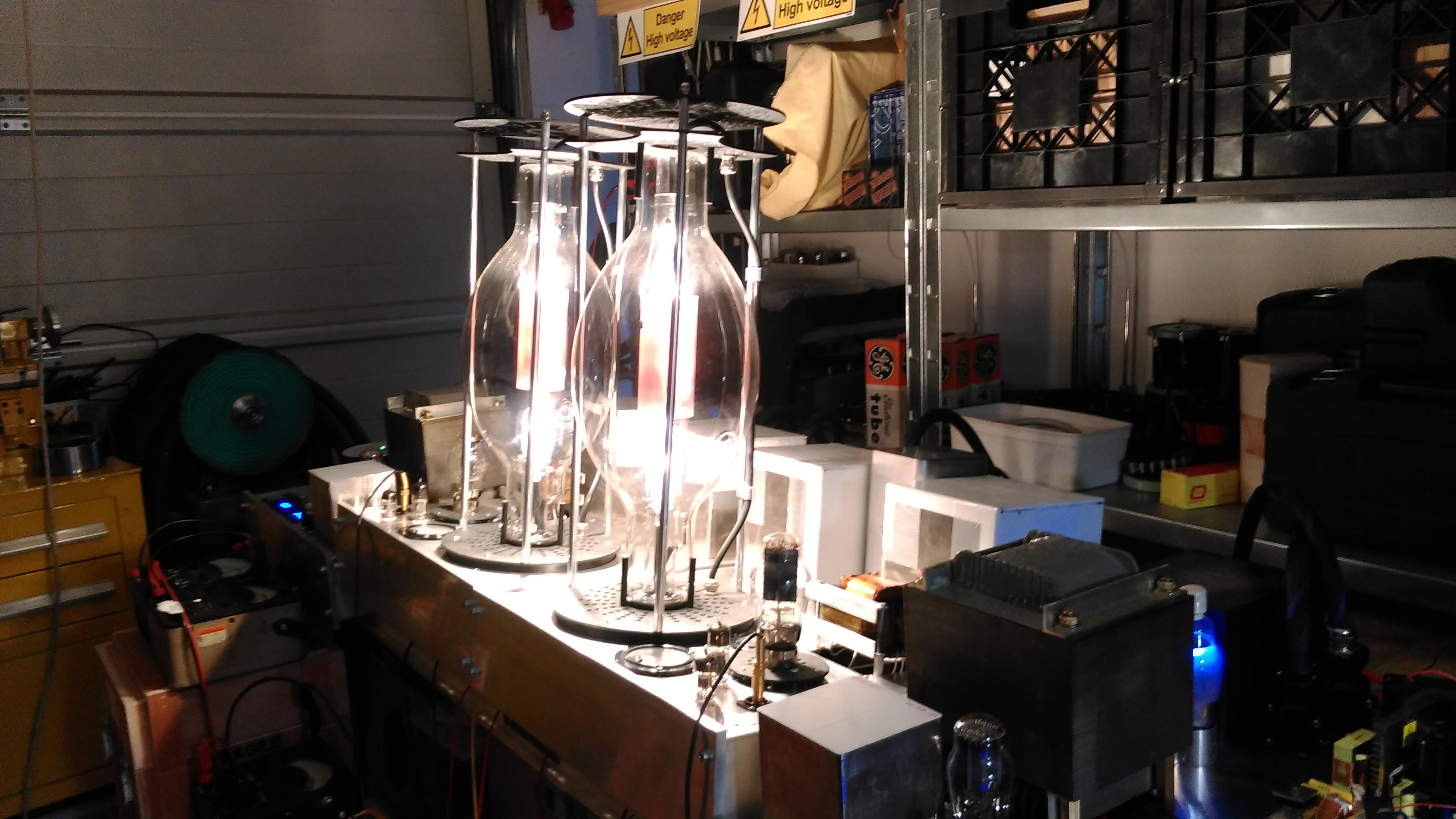

Beautiful congrats, what operating voltage did you use for that monster tube? I guest you can get around 60w from a SE amp like that....all the best
plate at 800vdc and 120ma, g2 at 380 vdc.....dc filaments, inspired by Anatoly's set amp good for about 45 watts class A2...
