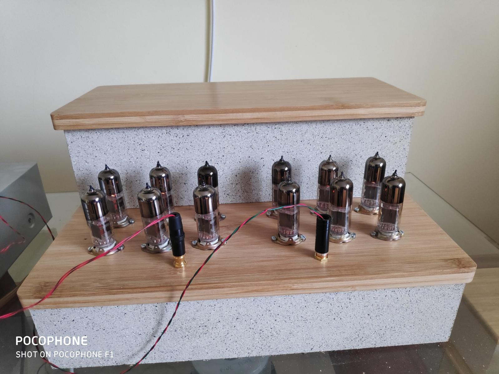

New Amp

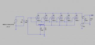

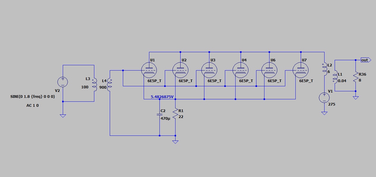

SPUD 6x 6E5P in paralel. 9W of pure music.

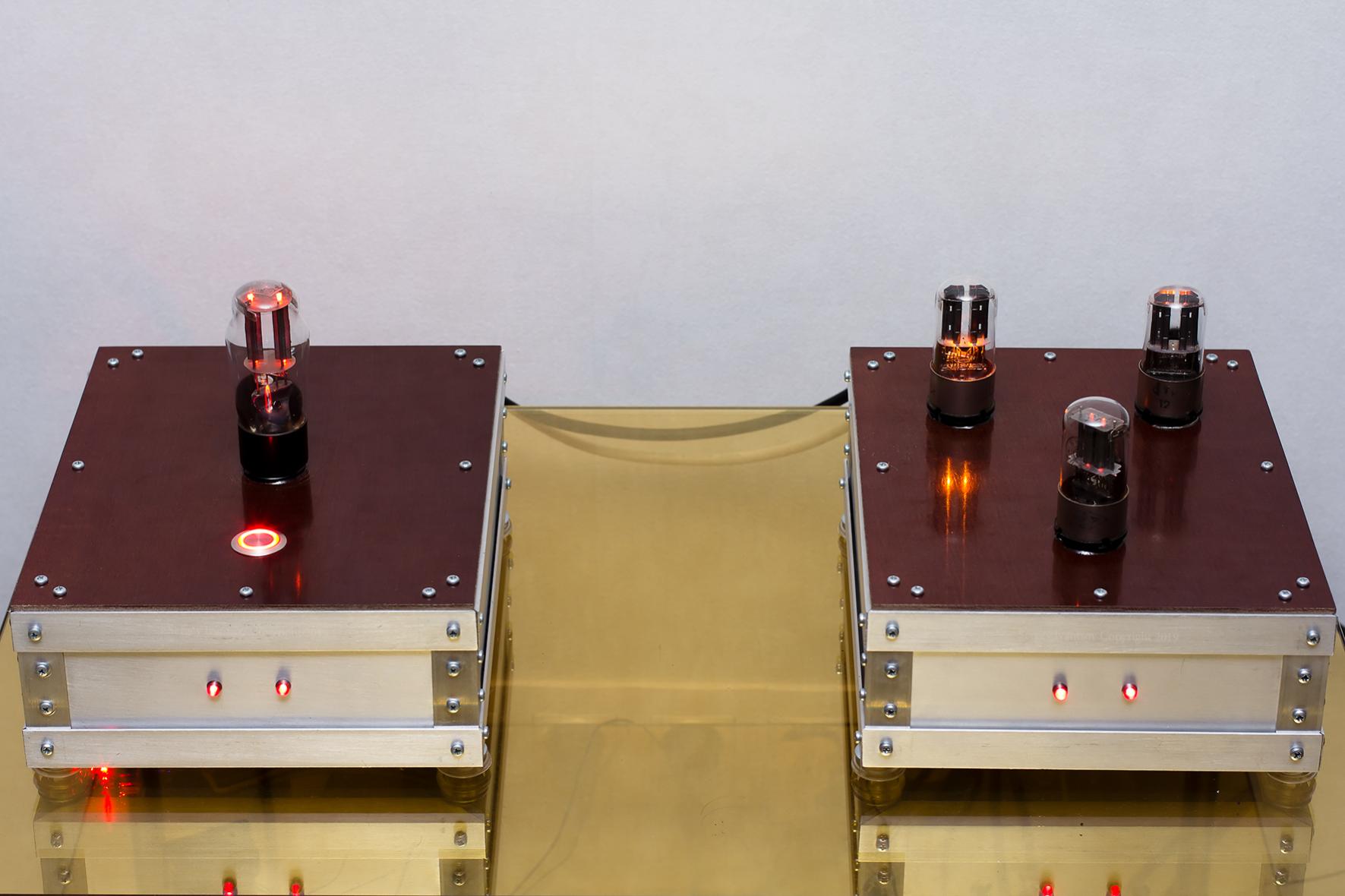

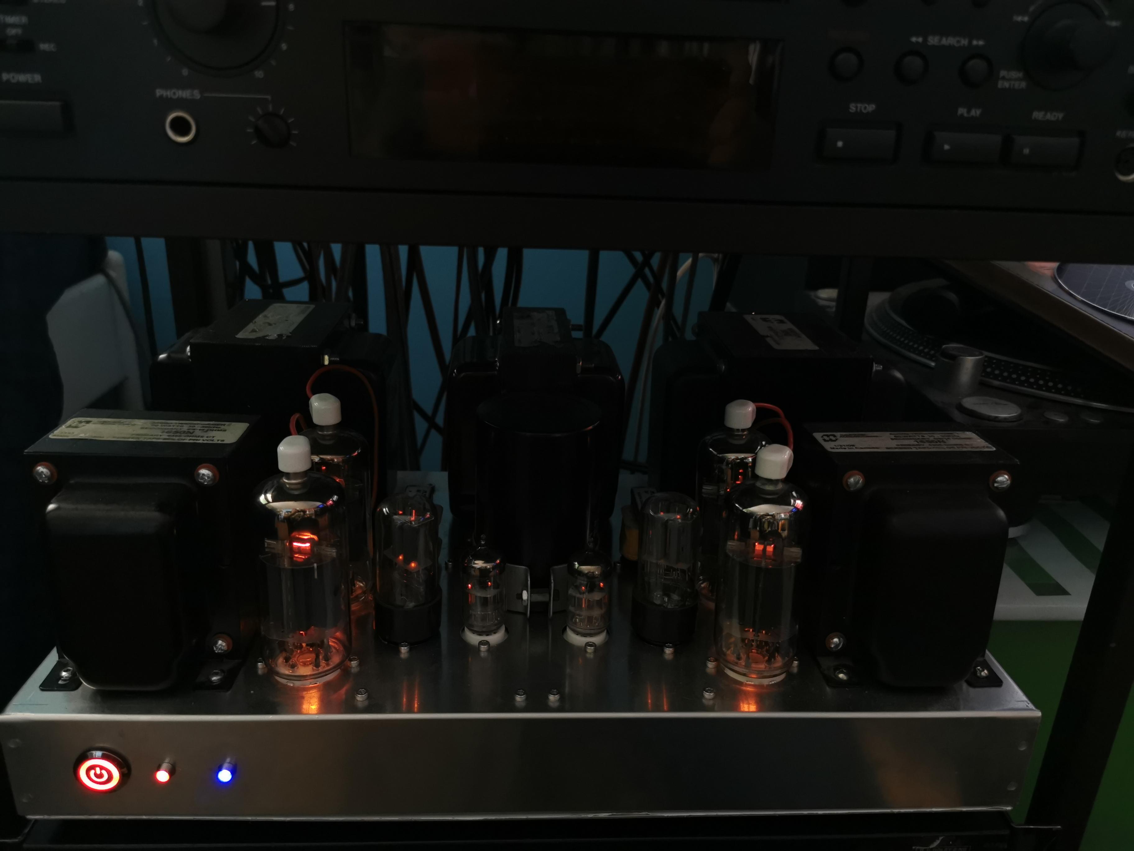

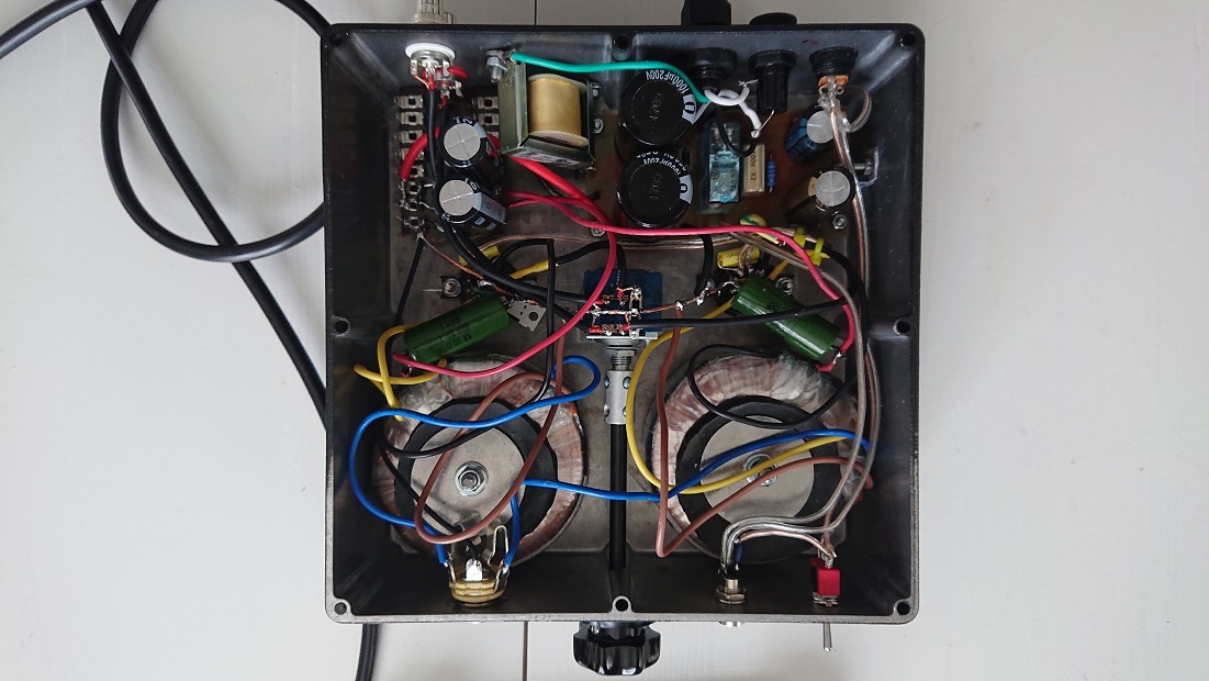

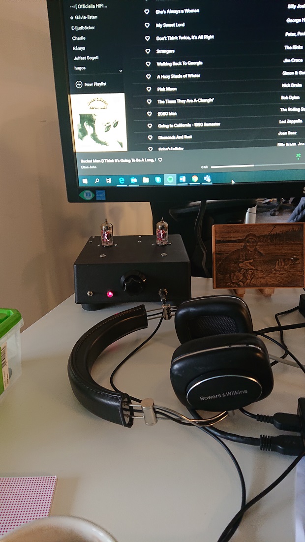

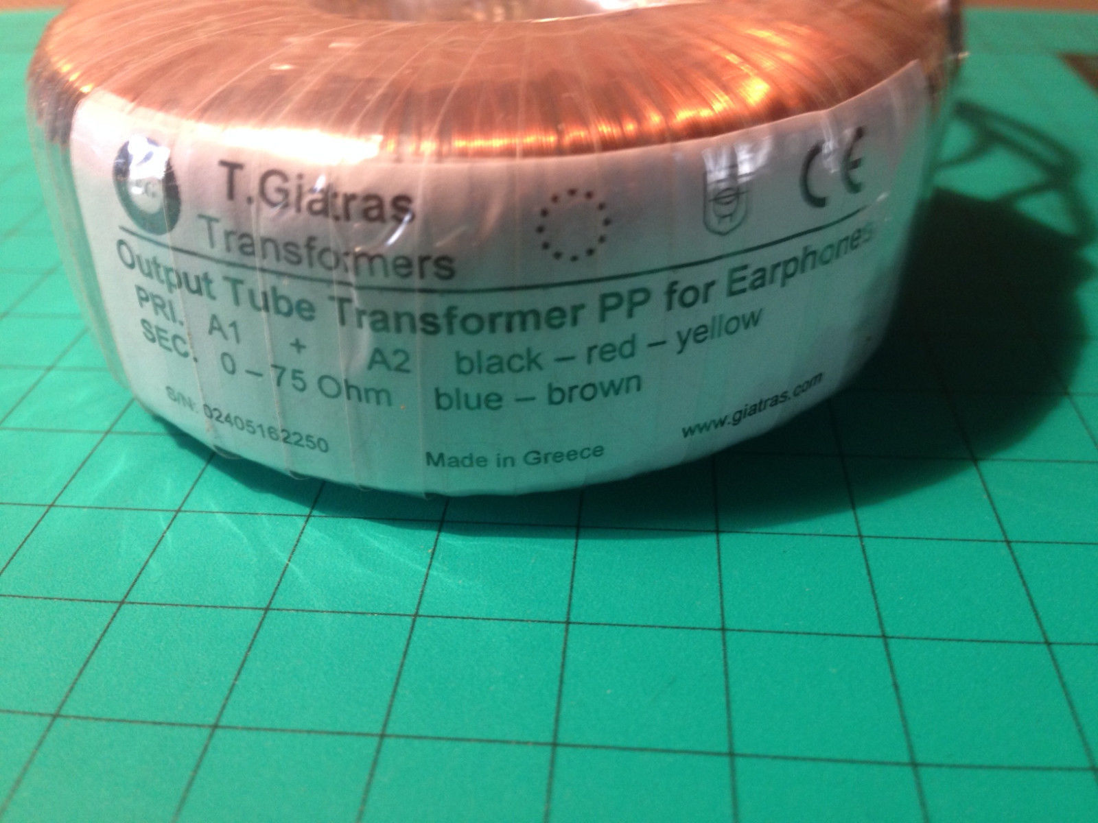

Headphone amp wit built in ES9038 DAC board
This is my music at work. Sounds really good wit my B&W P7 headphones. E88CC with Giatras output irons 75ohm. Just plug in USB-source and play. Best with HD tracks but works good with Spotify too. Dont want to go home :)
Note the inside picture is before I put in the DAC board with USB. It has the same supply as the heaters.
