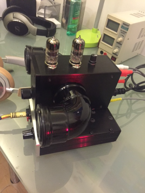

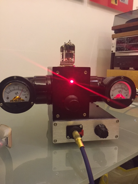

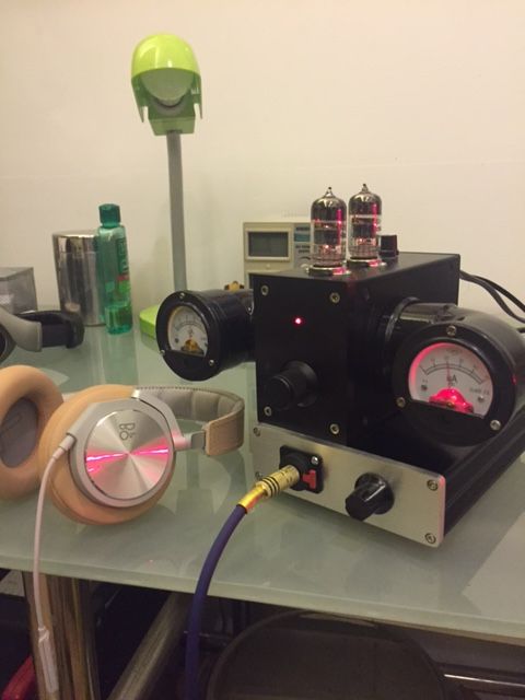

Finally finish, 6922 push-pull headphone amplifier, versatile design by B.Heran, can be used with most of dynamic headphones until 150 ohms with Edcor XSM10K/150 but for higher headphone impedance the Edcor XSM10K/600 can be used without any modification in the original design. I add to the original design a balance control and VU meter, I know this amp looks weird, I used mostly recycled material even water pipe elbow, but I am happy with it, but most of all sound incredibly well, dead silent, no distortion even at max volume and brilliant soundstage, 100 mV of signal input will result in about 50 milliwatts of output power. All the best to everybody...:)

Well as you certainly have guessed I was just kidding :) . But....... those uA meters, what are they measuring? Where did you purchase those? I am still looking for some mA meters which have a back light. At the moment I am redesigning my own headphone amp to make it more suitable for my 300 Ohm Sennheiser HD650 headphone.
The uA meters are connected to the secondary of the output transformer with a shottky diode and 10uf cap plus I had to add a switch for select low volume and high volume, takes me months to find them in the local market here in Philippines, because all shops have the 200 uA model but for a headphone amp the tiny signal will not even move it a full volume, then I find the 50 uA that goes well with this amp but they did not have back light so I add myself 5 led on the back for have the back light, but I think you can find very good ones on eBay...all the best
