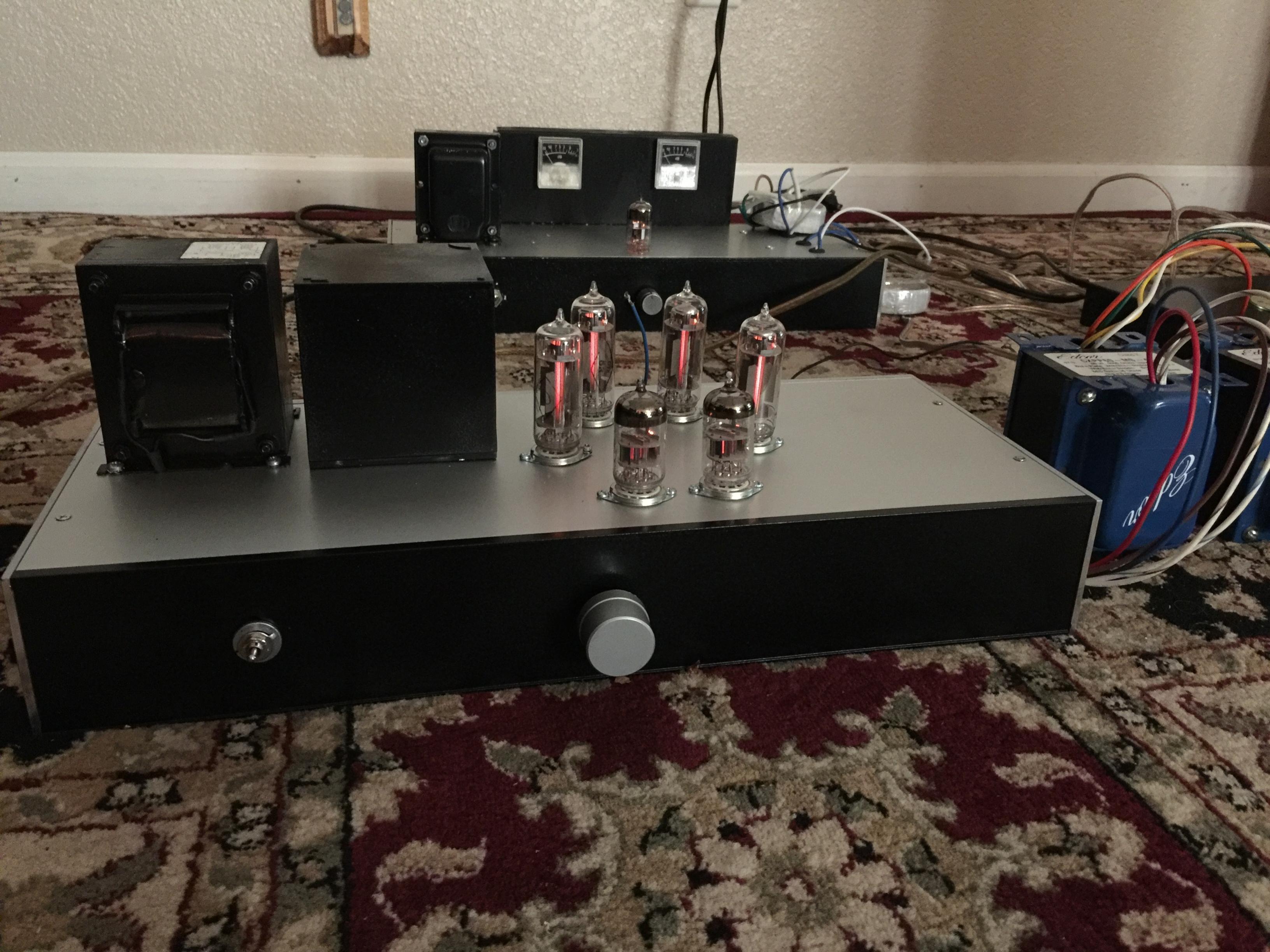

Here's my latest project being auditioned. I finished these two mono, balanced push-pull pentode amplifiers this afternoon.
At the moment,they are fitted with Electro-Harmonix 6CA7EH output tubes.
The amps use plate-to-grid feedback in the Schade tradition.
Input stage is a pair of NOS 6BS7 top-cap grid pentodes. These are equivalent to the once ubiquitous EF86 and use a spiral wound heater to reduce noise.
Driver tube dead centre, is a GE7044, configured as a pair of cathode followers.
Input stage screen grids are regulated by a simple cap-bypassed zener shunt.
Output stage screen grid regulation is courtesy of a 6SN7 configured as a shunt plus grounded grid error amp and is mounted between the two 6CA7EH. I found this circuit in Merlin Blencowe's book on power supplies and it performs really well. All iron comes via Danbury Electronics.
The amps are fed from a passive, silver-wired, balanced preamp using Sowter 3575 phase-splitting transformers and a Khozmo stepped attenuator.
This can be seen behind the right hand amplifier, on top of my Musical Fidelity M1 DAC.
Could be a long night :D
Αlmost done ....
