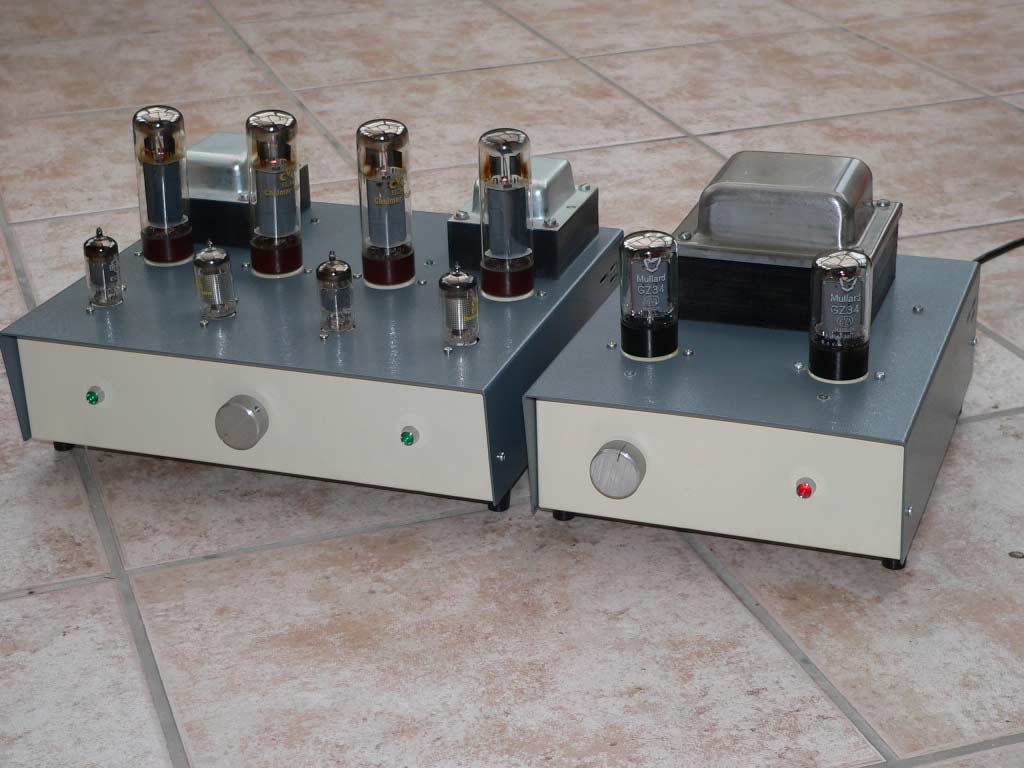

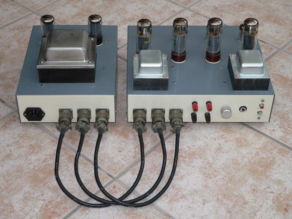

My everyday amp used in my home-office....
Built mid-1990's and based on the Maplin Millennium design but with mains transformer from the 1960's, 2 x GZ34 rectification (one for each channel). Replaced PSU caps, a few resistors and EL34s last year (after these photos were taken). Still giving very good service.

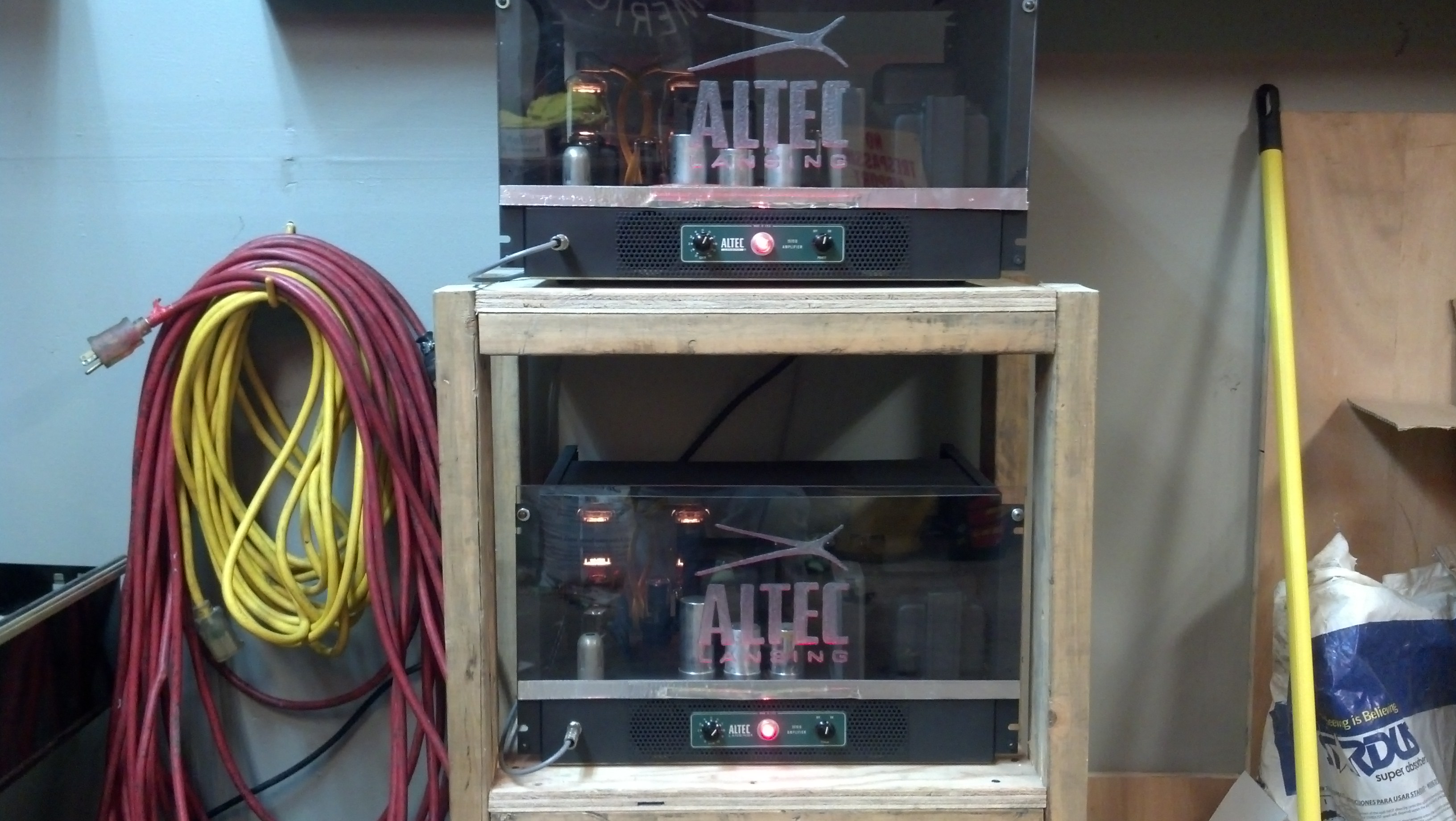

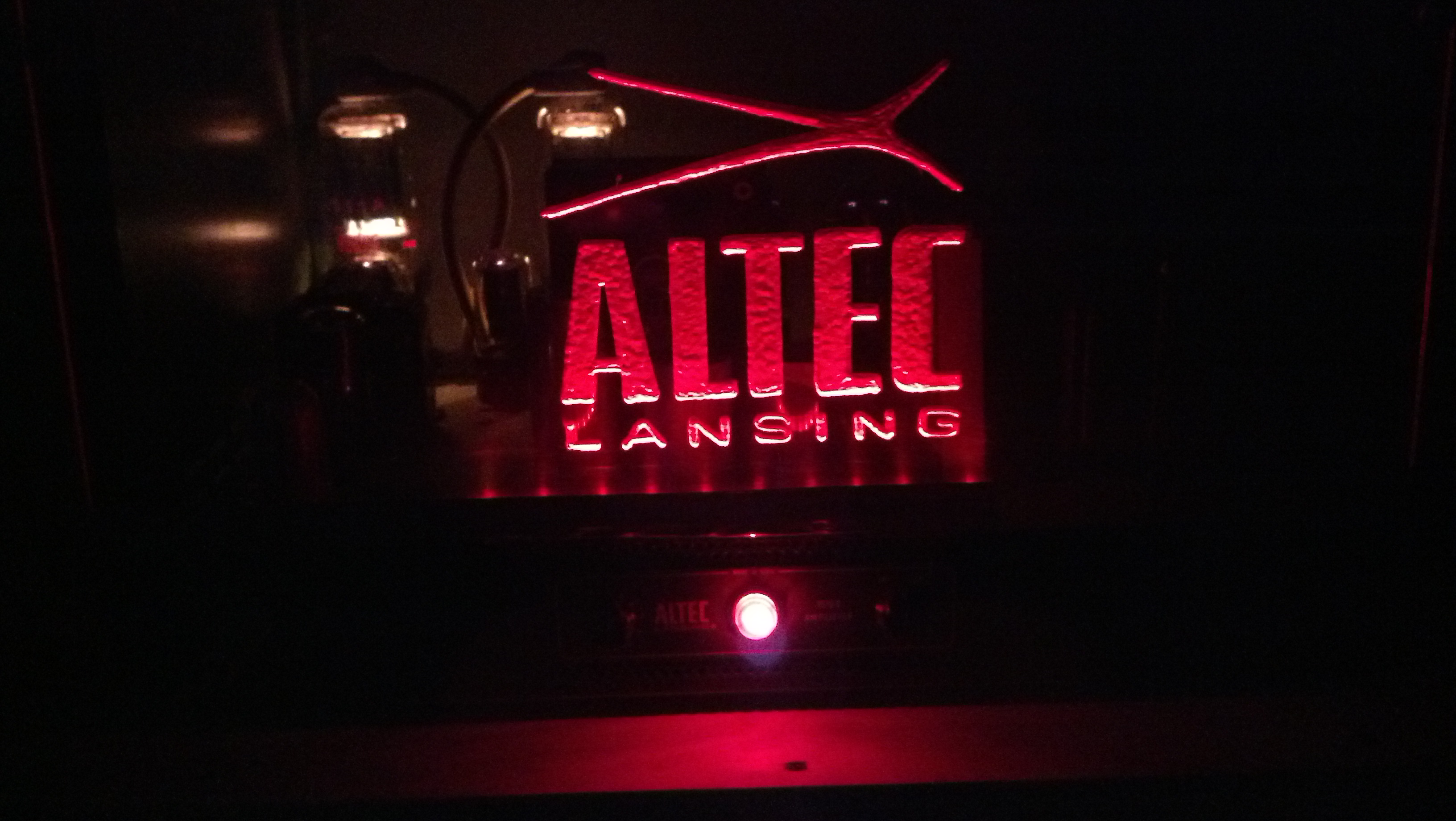

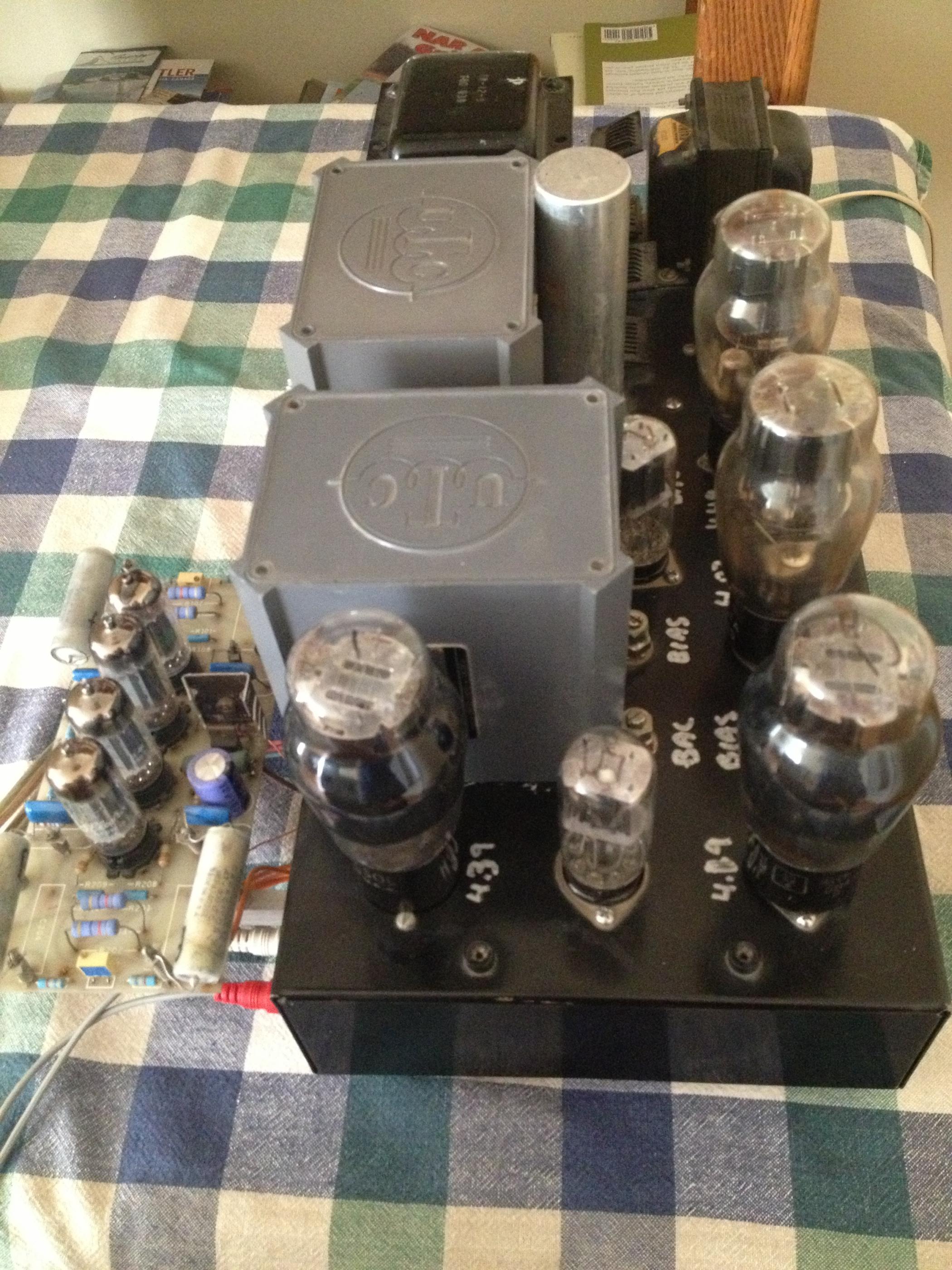

These days my "everyday amps" have become my Altec 1570B twins. I have recapped them and replaced all tubes and they sound heavenly! I also did a few things with the cosmetics because these amps are truly ugly as-is! I blacked out the whole thing except for the large cans in the front and the tubes. I then put an edge lit engraved plexi front on them.

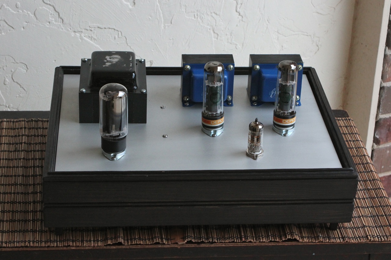

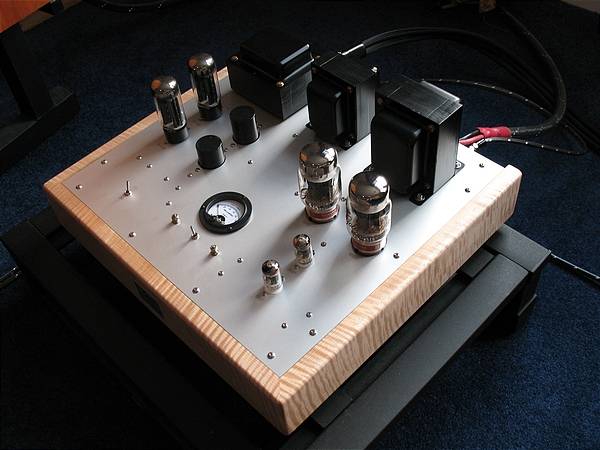

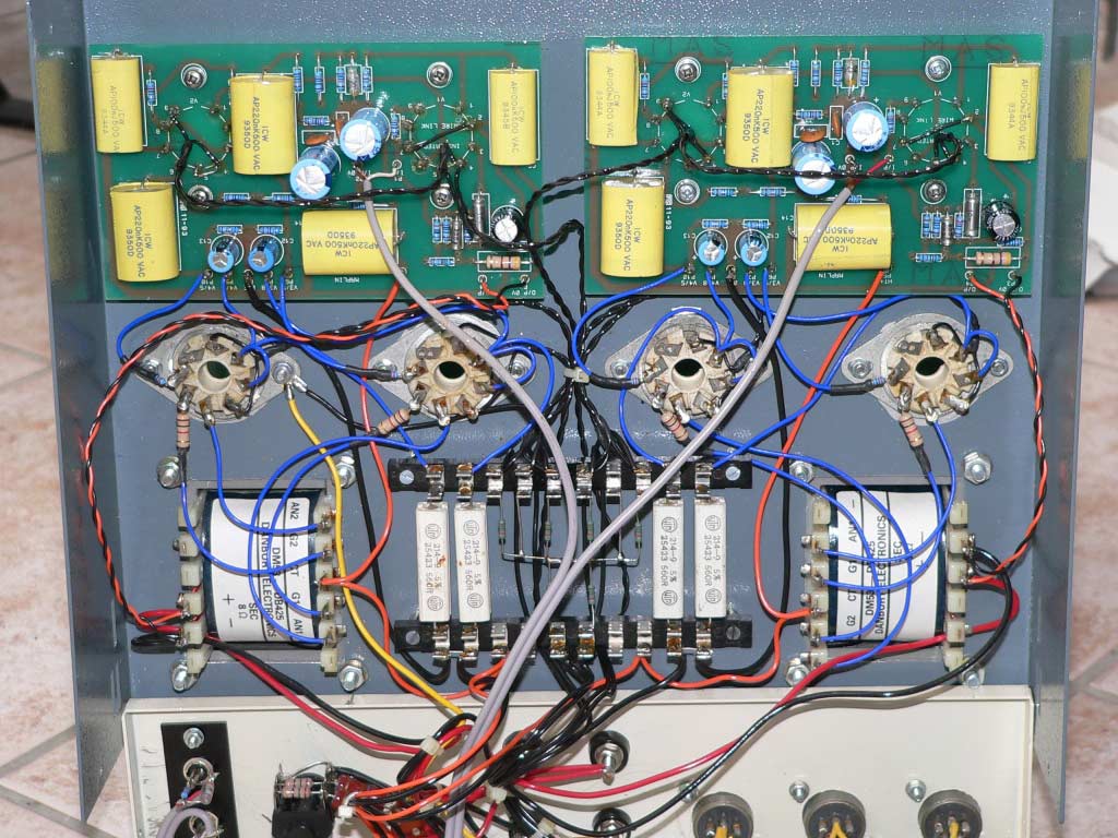

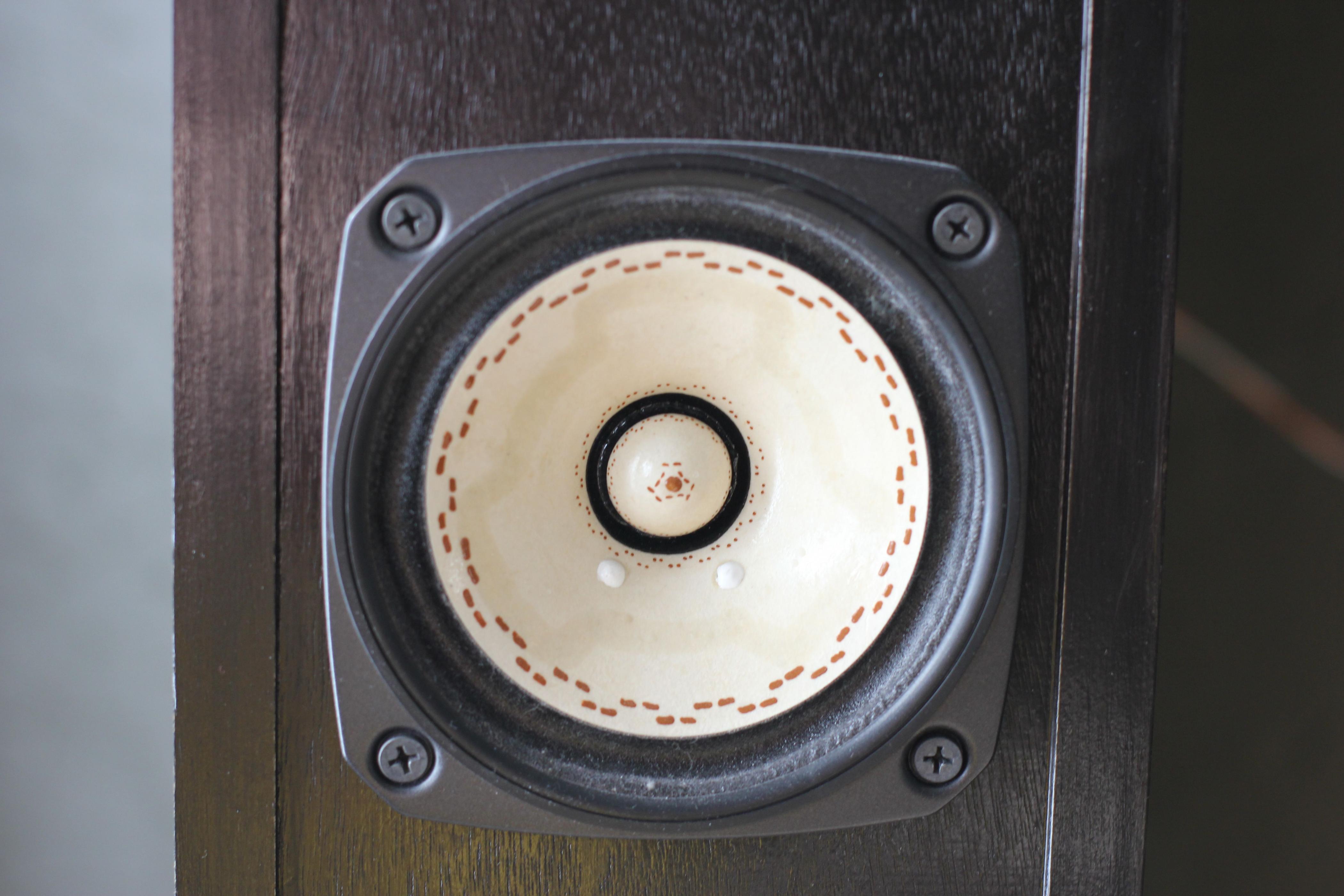

My everyday amp is a Tubelab SSE clone driving a pair of Frugal-Horn "spawn" Saburos. The drivers are Planet10 modified Fostek 126e.
I always thought I would be rolling tubes and using the U/L / Triode / feedback switches to find the perfect combination. Nope, it sounds great just the way it is!
The amp is clear enough that the quality of the recording, or lack thereof, plays a much greater role in the final sound than any of the changes to the amp I've tried.

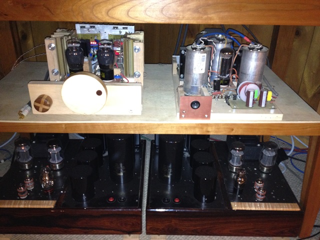

My everyday amps are Emotive Audio Vita monoblocks using Genalex reissue KT-77's mostly and occasionally KT-120's. However, I like to swap other amps in from time to time. Right now, I am using my 46 SE amps which use a Western Electric 403B (in triode) with an Intact Audio 1:1 interstage. The IT is new; until a week ago the amps had an Electra-Print plate choke and Dueland CAST coupling cap. The IT sounds a lot better. The 46 amps sound really nice but the 1-watt output is a limitation even with my high efficiency speakers.

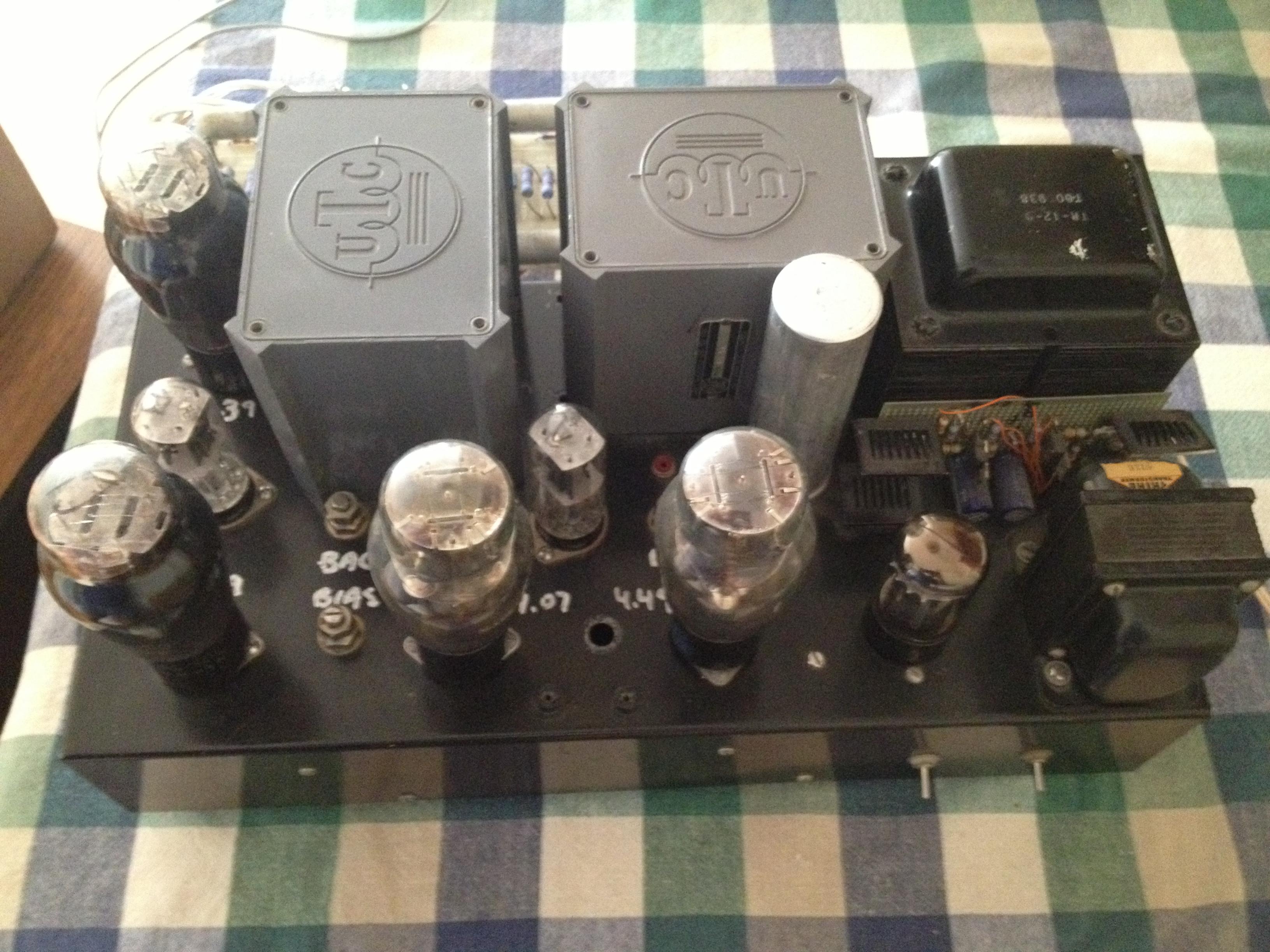

Hello, Thanks for your reply. You mean I can change the EL34 with KT88 and vise versa? Do I need to adjust the Bias or something else. I have 4 new Harmonix KT88. Should I try them in place of EL34? Which Tube is more musical from EL34 and KT88?
Thanks for your answer. I will sure inform about the sound quality once my system is all set.
Sheraz80,
Mmm ....
Meaning that I will be careful! One must know which exactly are the output tubes. From location it would seem EL34s, but what then are the KT88s doing, or the other way round. It would be rather funny to use a EL34 and KT88 in parallel, or .... as I said, what exactly is going on?
Theoretically, to put EL34 in place of KT88 if KT88 were original, could easily overload the EL34. The bias is different, and the EL34 (25W) cannot stand the dissipation of the KT88 (35W).
Sorry to sound difficult, but one must be careful. Are there any indications on the chassis which tubes should actually be in their sockets? Or can you determine from the wiring whether the power tubes are actually two in parallel?
Wise advise above. I think you need a greater dissection and ideally to trace out the schematic to post, or at least some detailed high resolution pictures f the wiring. It is an odd combination of tubes and you need to know more about it before swapping stuff. Looks like a cool amp! But I like to see my tubes.
