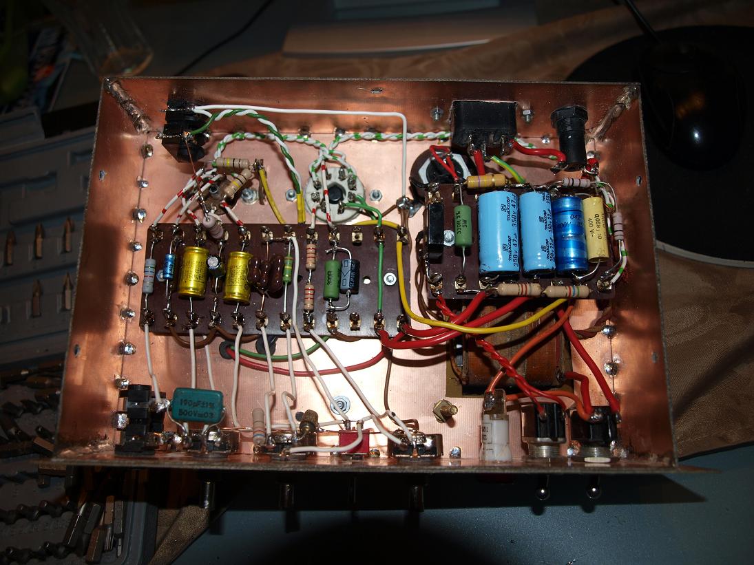

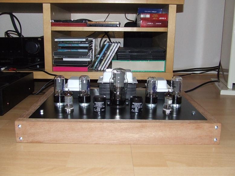

A few of my tube amp creations.
First one is an ECC83/6V6 guitar amp in a nice homebuild combo with 10 inch speaker. Perfect for rehearsing as I can crank it all the way up and overdrive the 6V6 without ear deafening volume.
Second one is a 6V6 push pull poweramp.

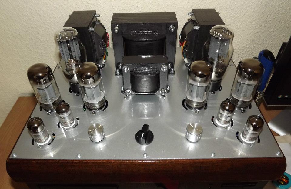

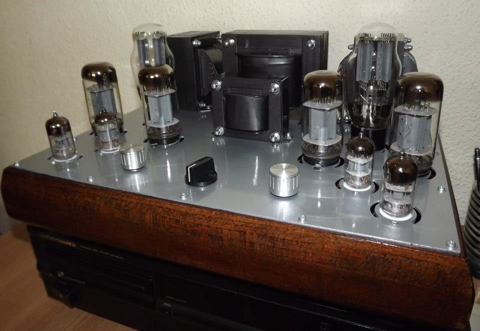

McGyver: those gold caps look expensive. I have some silver paper and oil Audio Notes I bought for a few years back for $200 each. They now cost $350 each. Audio caps can be crazy priced. What are yours?
Those are Obbligato Gold Premium, about 10 bucks per piece. They sounds very good, but I find new Audyn True Copper sounds far better and I prefer them over Mundorfs supreme silver/oils and over Audio Note copper in oil also. V-Caps CuTF are good but not my favourite flavour of sounding and their prices are quite insane too.

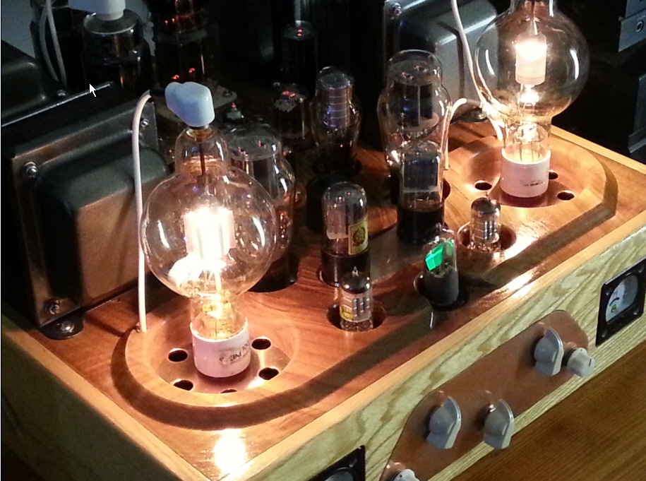

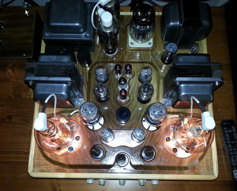

100TH tubes amplifier s.e. class A2
I would like to present my last effort:
new s.e. amplifier using 100TH driven by 2A3.
Three power supply tubes regulated, one for 100TH using 6C33C and two ( one per channel) using 6EM7 for 2A3 and input stage.
Cabinet made in solid wood machines with CNC with nice copper inserts.
