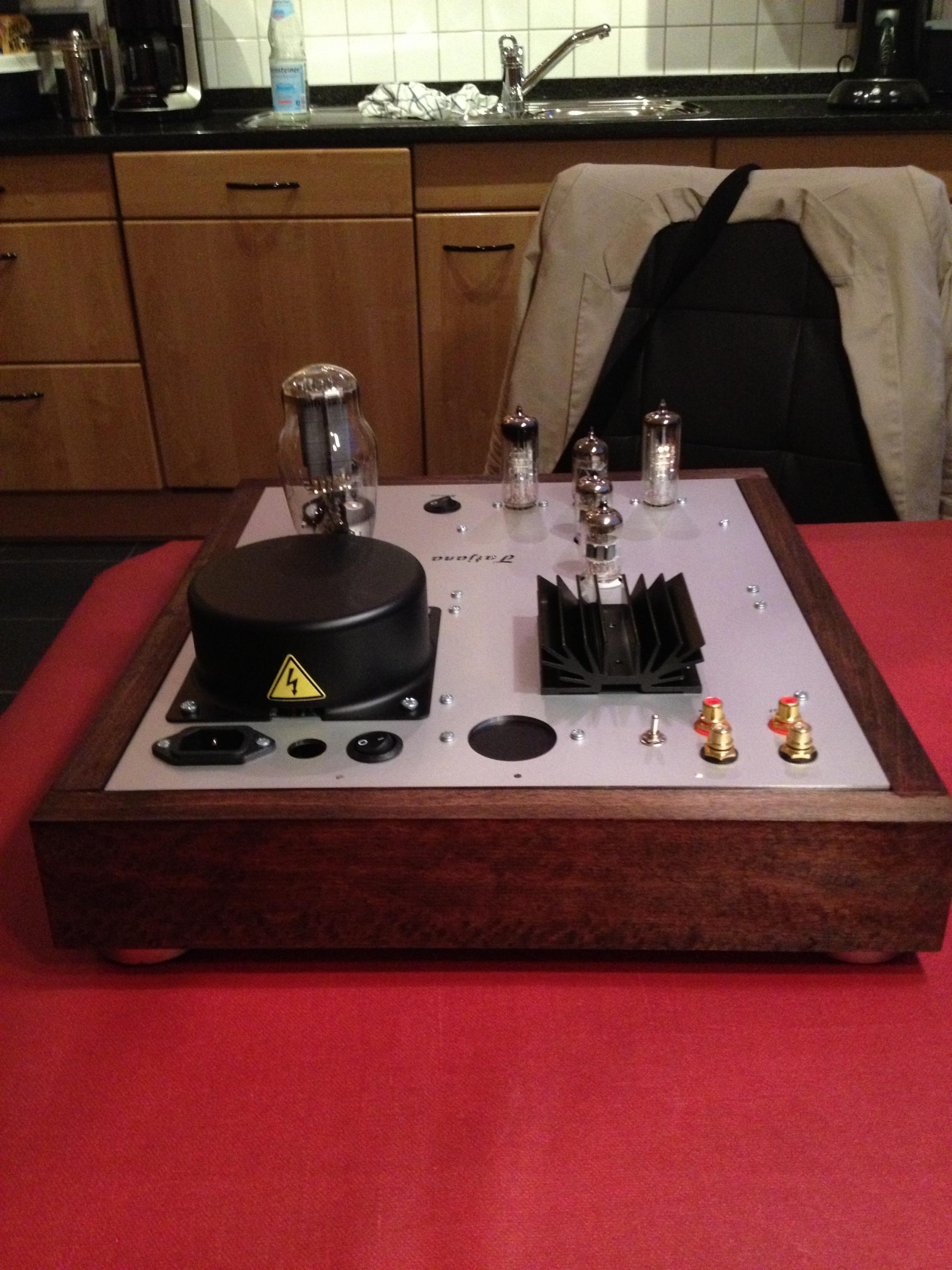

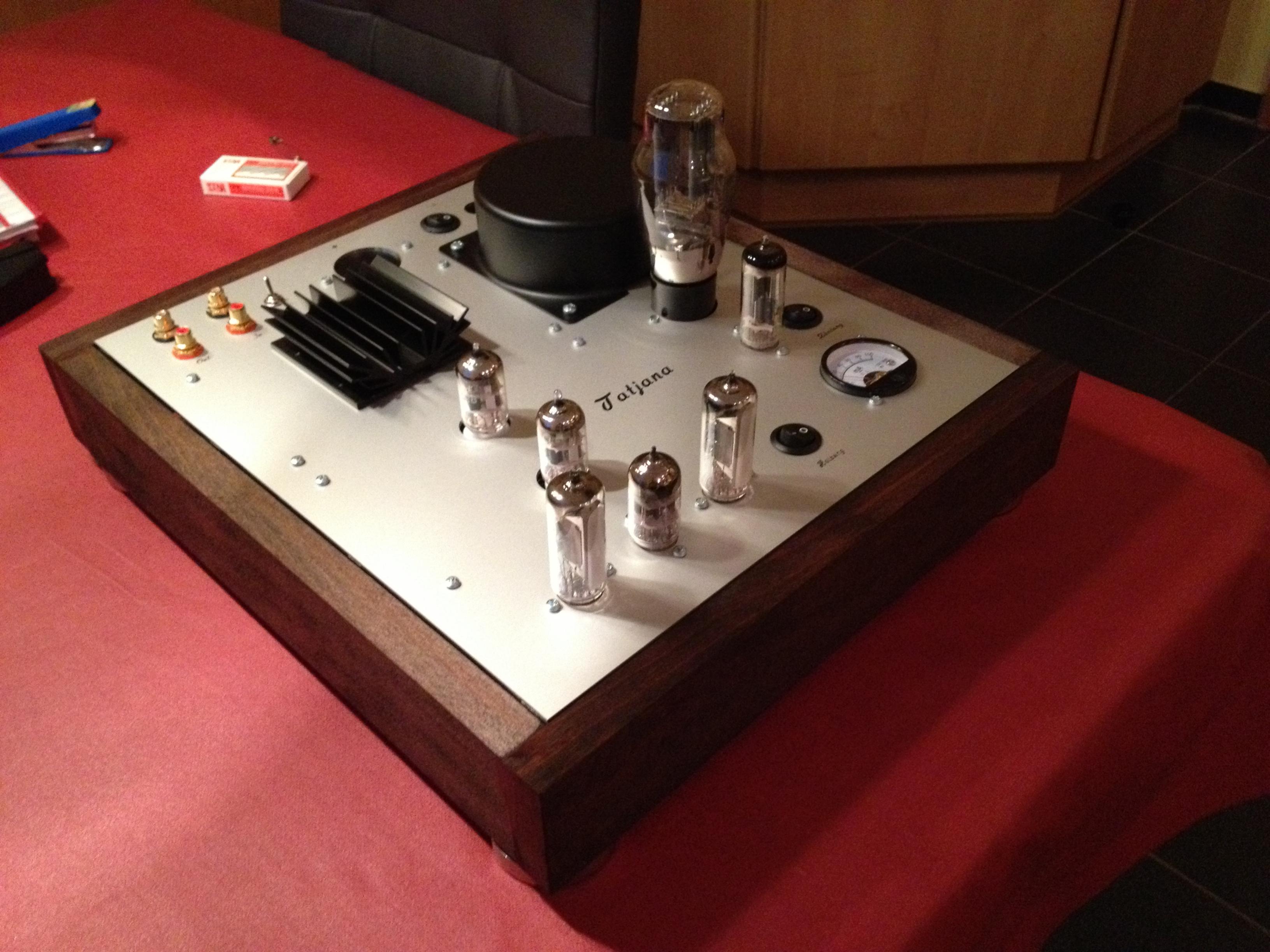

My C3G spud headphone amplifier is finally finished and playing music.
- C3G triode wired running at 145V / 15mA
- Cathode bias with tightly matched Morganite resistors and BG N bypass caps
- (yes, there is still people preferring a conventional setup over LED bias :whacko:, but only when Black Gates are used)
- Salas SSHV2 with LC prefilter
- DC heaters
- Lundahl LL1689 wired 18:1
- custom wound toroid mounted on top
- all the guts underneath
Absolutely dead silent (Pitch Black background...;) ).

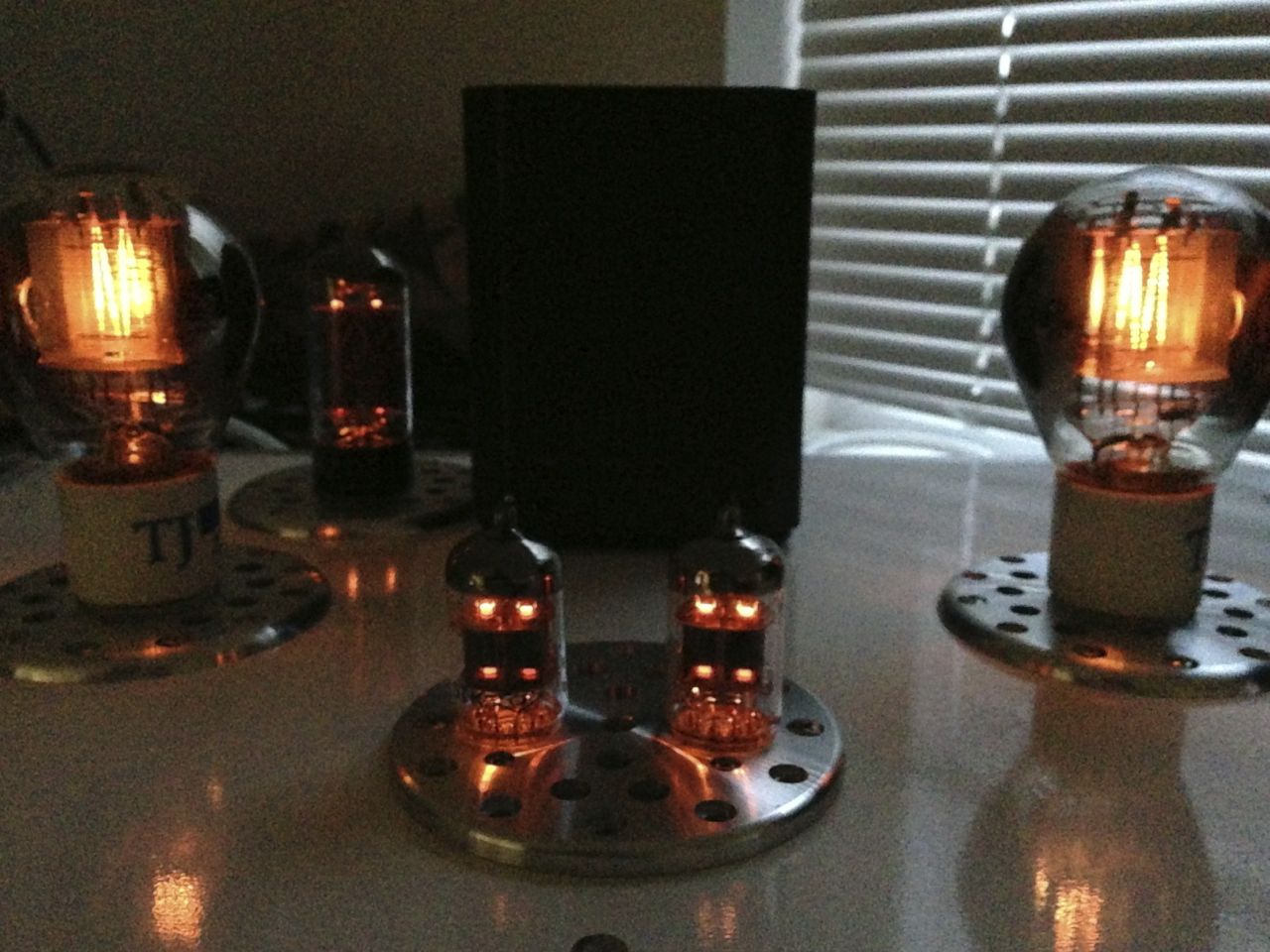

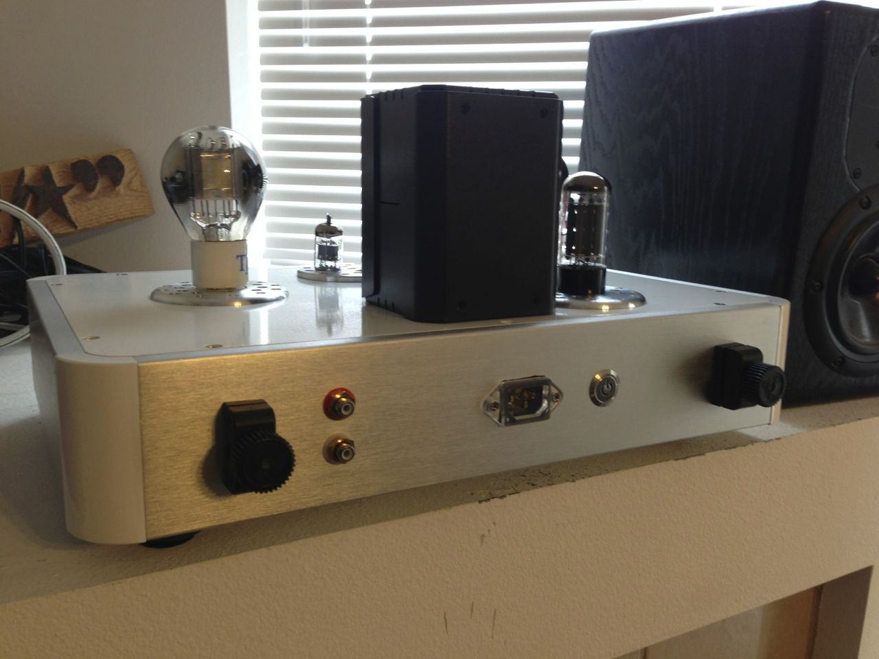

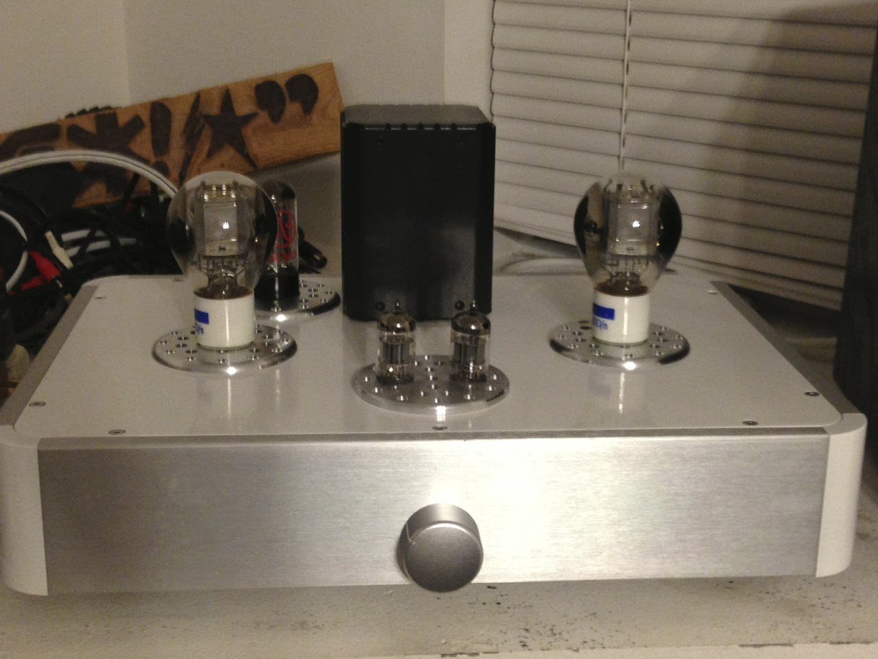

After tracking down a noise issue I finally got this one working. I won't say I'm done with it but it is going to stay this way for awhile.
6N1P Broskie CCDA driving TJ 205D parafeed. 205D is at 350V/20mA/-20V cathode bias. 6N1P is at 165V/5mA/-3V unbypassed cathode bias. MQ BCP-15 plate choke and EXO-35 iron (yeah I know...5k:8 on 205D...feels good man). Many parts were salvaged from previously dismantled projects so there's some battle scars underneath. If I could completely redo it I'd figure out a way to make the wiring a little more tidy but all things considered I'm happy with how it turned out.

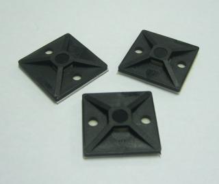

Very nice build! But... why I don't trust cable ties holding heavy capacitors with high voltage on them, in hot environment?
I used anchors with screws so no adhesive delamination (if you've had an accident with this method then please say so). The amp runs barely warm as well, a little less than 80VA total consumed on a 17x12x3 by 6mm thick aluminum chassis with vents directly over the resistors dissipating heat and holes in the bottom plate to allow convection path. 1 watt per channel output with 80 watts consumed, yes, almost enough for headphones.
