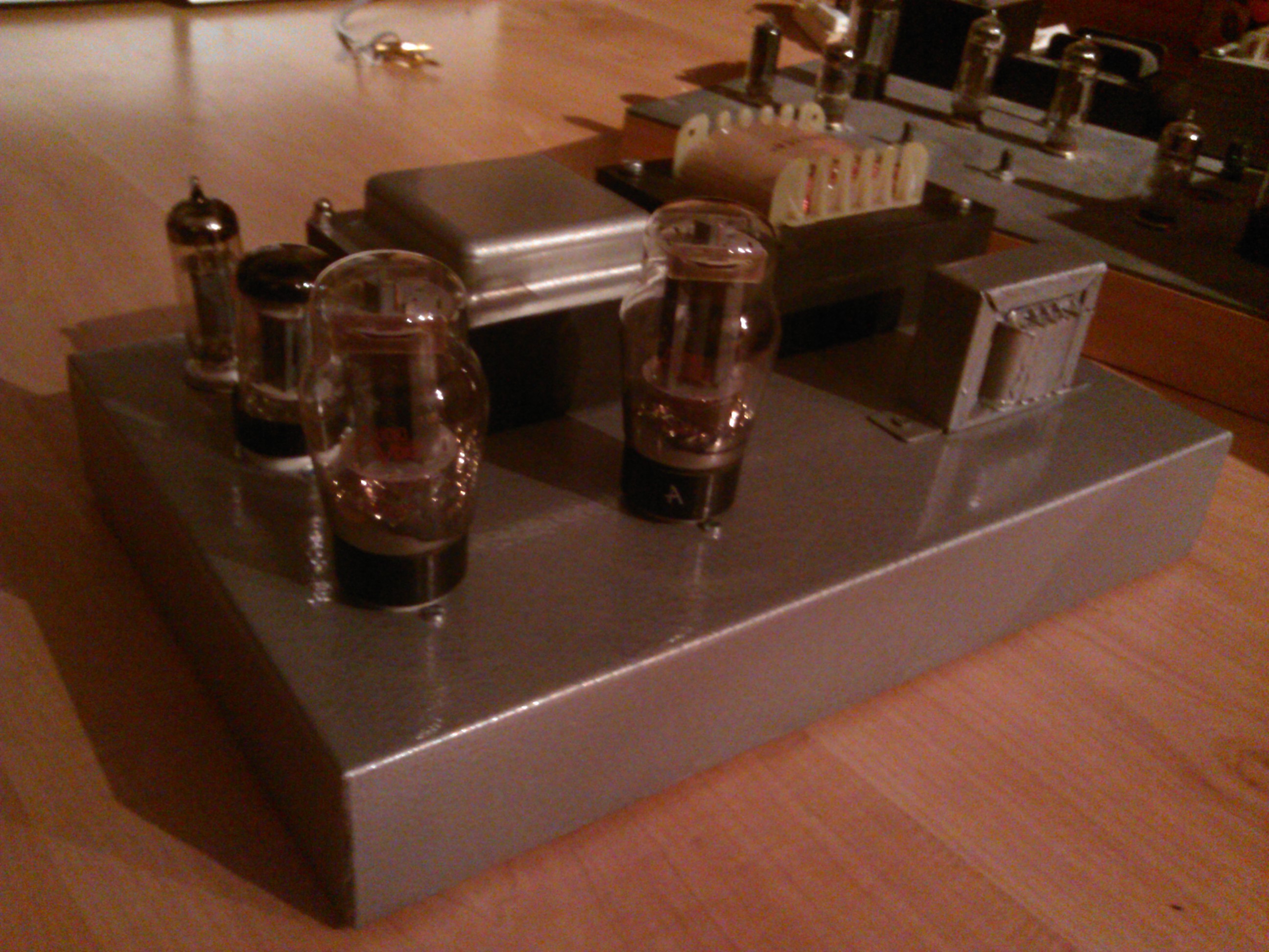

Build this amplifier last week! The dimensions of many pre fabricated cabinets are not of my liking, so I decided to build one myself.
It's a stereo single ended EL84 design using 'schade feedback'. It's build exactly according to Aleksandar Kitic's RH84 schematic.
It uses a JJ 5U4GB rectifier and a JJ ECC81 as driver. The power transformer is wound to my specification by 'AE Europe' in Schagen, Holland.
Output transformers (AT06) are from HB Amp Design in Germany. The parts are all ordered,
except the EL84's (Haltron, made by Tungsram factory) I had those lying around... mostly the reason I build this.
It sounds great! The lower frequencies are represented very well, and the mids and highs are very detailed, great schematic.

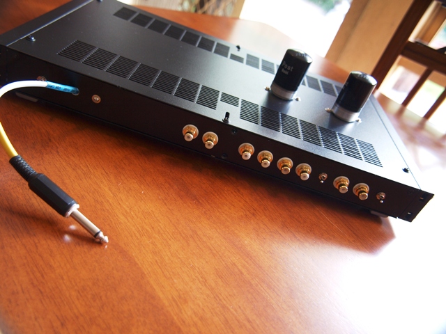

WHAT?! More than one tube in a stereo preamp?:
Beautiful amp!!!
Each tube only has a single pentode. I recommend you don't use a Ck but if you do 150uf is the valve. A 10V version is sufficient. I used a 0.47uf Jensen copper, paper and oil cap on the output. According to the designer (Matt) it is OK to use 0.47 and not 0.33uf.

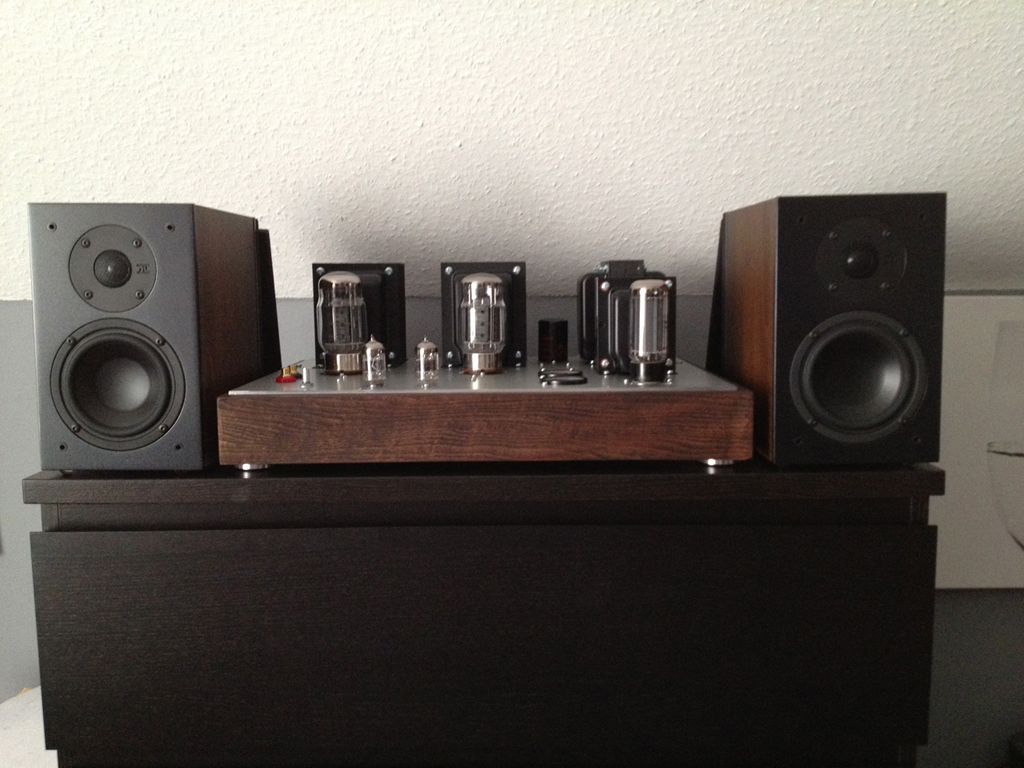

Hey guys,
i also want you to show my KT88 Single Ended Amp. Its the best Amp i have ever build :)
In the photos you can see 2 different rectifiers, i changed it finally to the bulbed version of the 5U4GB.
A preamplifier is still in plan.
