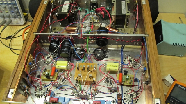

Got the idea mate ;) Here you go:
Notice the short distance between power tranny, choke and OT.
No hum, no noise at 100dB loudspeaker.
Those R-core can't compete with amorphous core
but are a decent bang for the buck. Mid and highs are nice.
Rod's filament supply is in the frontpanel, at the copper strip.
Coupling done with 1uF Audicap and two 0,1uF Cardas.
The TCC oil is a little inductive, fine for that first position.
Wiring between HT rectifier and first cap is shortest possible.
LV supply has been split in noisy front (near tranny)
and 'clean' end at the tube sockets.
Finishing the plinth is for today, as is tidying up wires.
Inspired by Allen Wright.
6H30 cascode (copy from AW)
EL34/ KT88 output, ccs bias
21st Century Maida Regulator on driver/ input.
5k OPT
