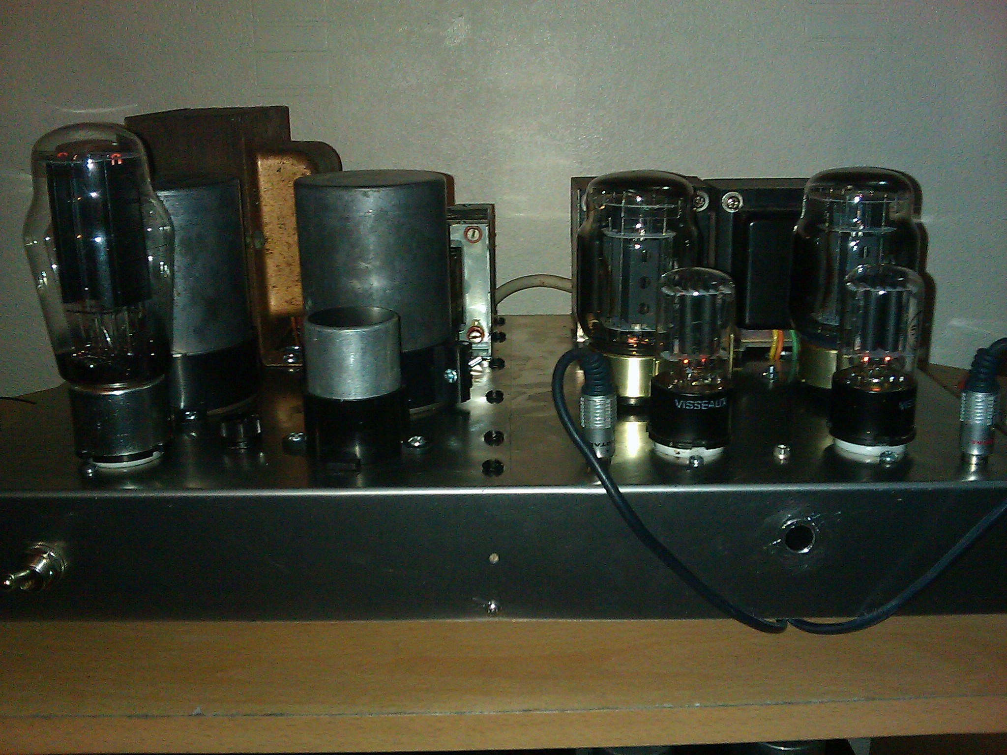

Err, I didn't draw the circuit. This paraphase thing is personal taste anyway, concertina phase splitters are alright too. I always recommend people to experiment, to find out what they like and to make things as simple as possible. I dislike ostentation. I dislike audio trends.
So you obviously use solid state rectification and RC filter. Why not
You don't need a choke -it's a Push Pull amp. Besides, for whatever reason it sounds better with a resistor. I like tube rectifiers but I needed all the juice I could get.
There seem to be two RCA jacks
It's a mono amp. I listen in mono in my basement (that's right, MONO) and I also play guitar, so one input is often used with a guitar preamp.
Some argue with mono you get a perfect centre image.. :)
Then again whats the point of stereo in a background setting when you move around the room and get left then the other side you get right..mono is much better in this situation..
And yes the resistor with no choke is a different sound...thats why I use capacitor bypass on the choke in my SE....Then they don't sound yuk!

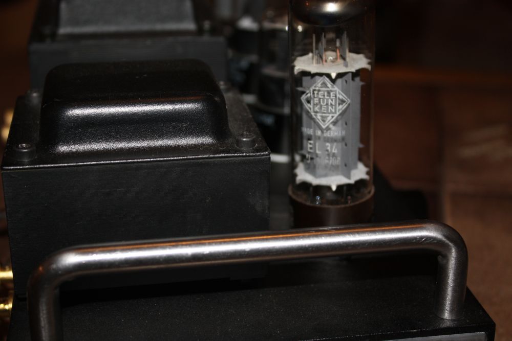

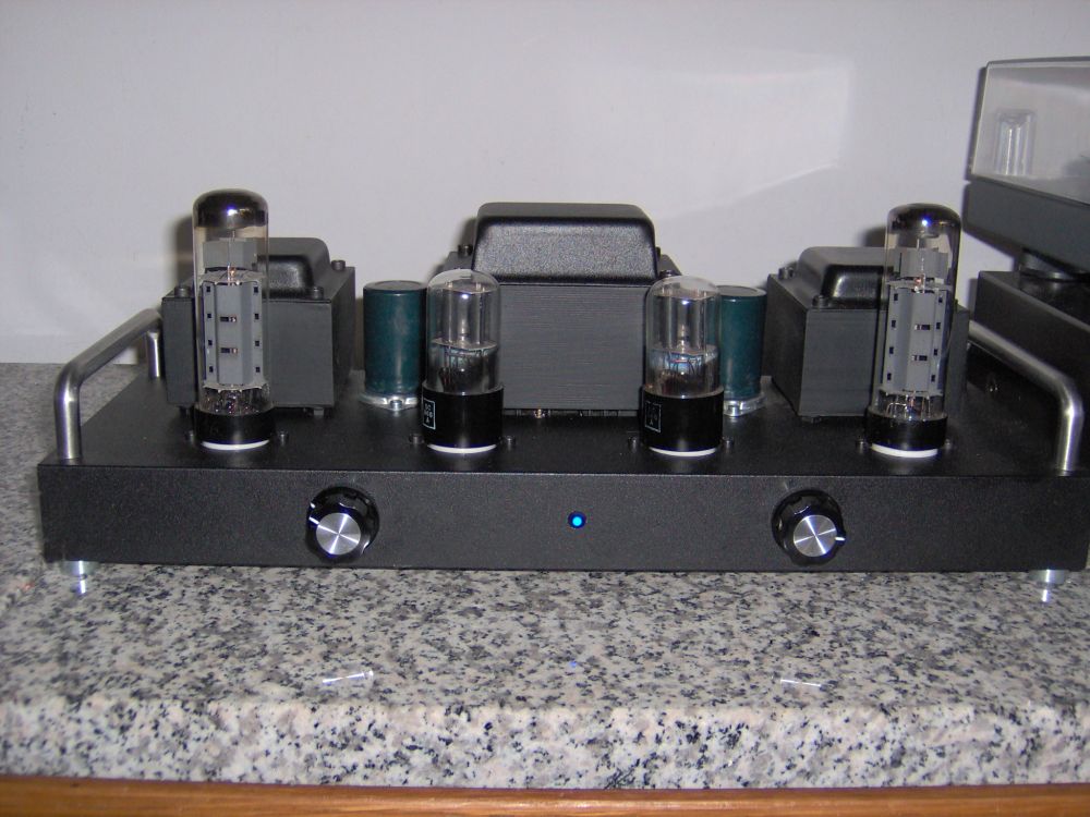

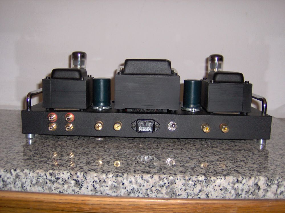

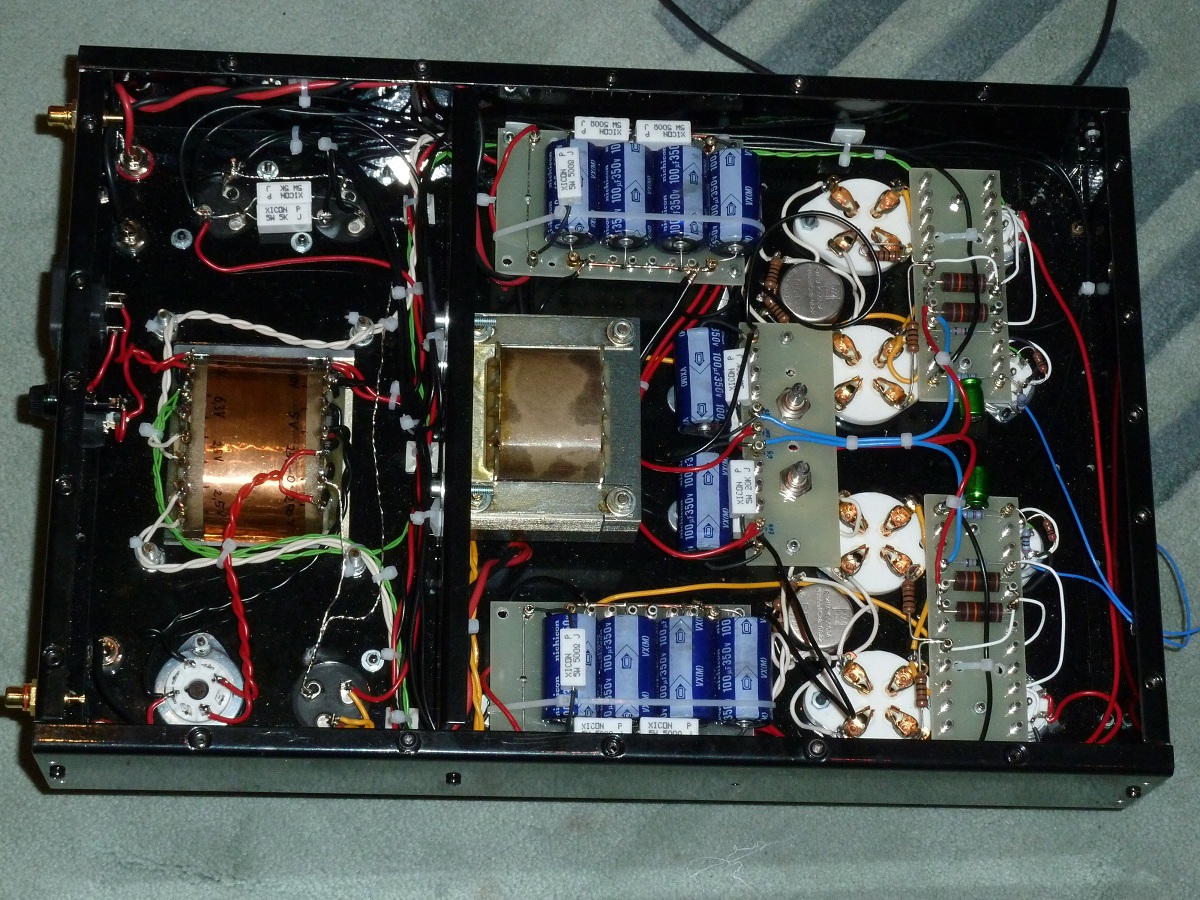

Hi, I wanted to present my design SE amp with tubes - the 6SL7 input / SRPP /. The EL34 output tubes operate in the triode system. The amplifier is no loop NFB. The amplifier works with speakers, OB - 15" EV SP15A / SP15A woofer, mid Beyma 8MI100 and horn Extra Cone / Greetings Dinkers
