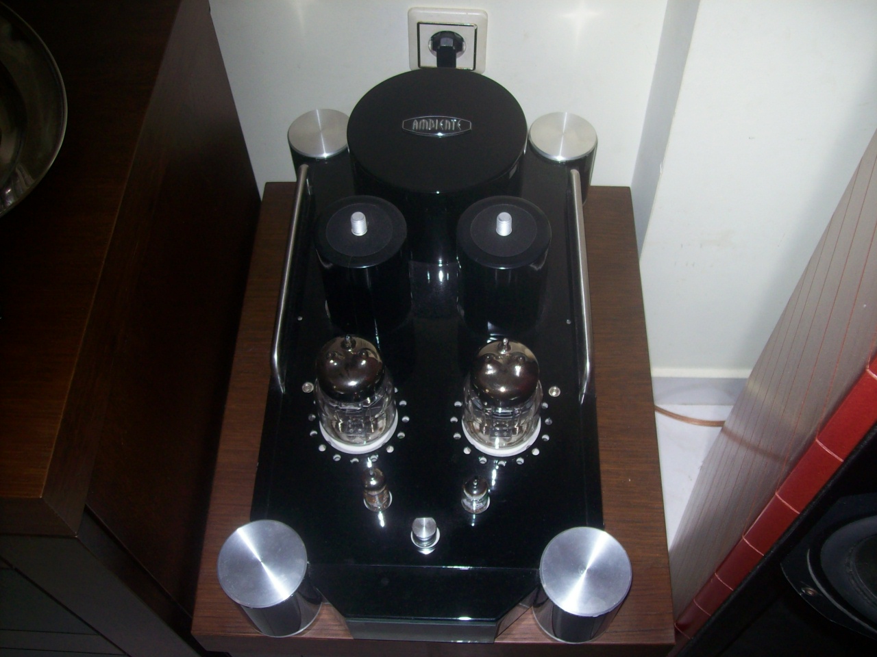

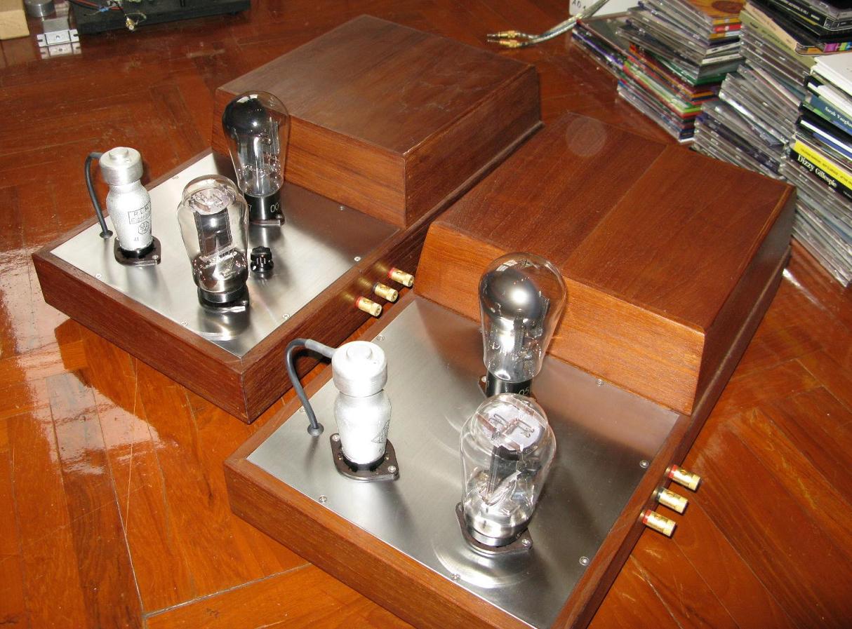

Hi to all,
here are my AD 1 SE Mono Blocks.
I use all original tubes.
I use NF II as driver for the AD 1 and RGN 4004 as rectifier.
NF II can also replaced by CF 7.
Rectifier can be also RGN 2004 or 2504.
OPT is custom made cut core 3,5 K.
I use Valvo and Telefunken AD 1.

Beautiful realization. I love power triodes :king:
A refined modern look done with taste. Love the stacked aluminium design... are they laser cut aluminium sheets ?
And what other components are under the hood?
And more importantly... where did you find the bottles?
I want one :)
On this link you can see what's inside.
not much... the first thumbnail is a movie where you can see how the amp is put together...

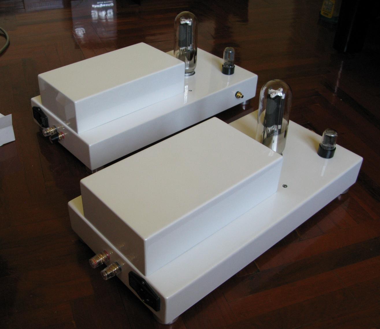

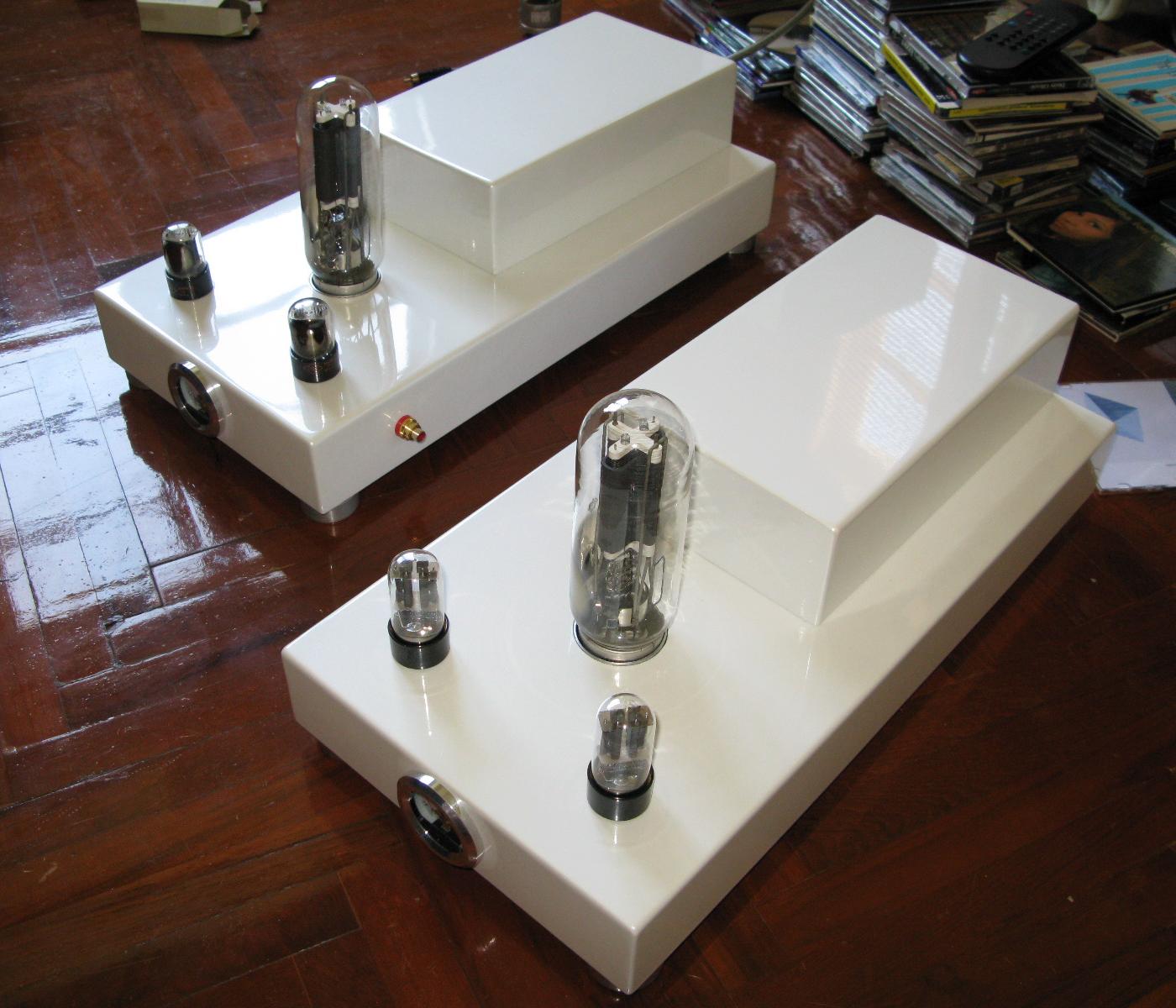

Pearl White 211
Here are our pearl white 211 mono blocks.
It is 211 with 6SN7 SRPP driver stage.
This Amp was made by my friend Frank and me.
The plate voltage is around 1100 V.
Output is 15 Watts RMS.
I personal like the cabinet style.

Pearl White 211
Hello head1962,
the basic schematics for the pearl white 211, was from a Japanese magazine.
I guess MJ.
The gain in the driver stage is too high, this was adjusted.
Also the power supply is changed, higher voltage for 211.
Use original 6SN7 tubes - the remake tubes sounds not so nice.
Here the original schematic:

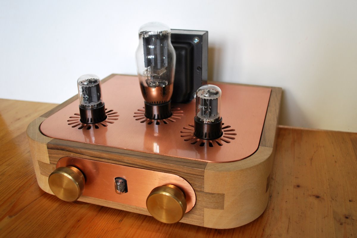

Hands down the coolest build I've seen around here in a long time ... if not ever. I wish I'd thought of doing that.
Thanks! dsavitsk!
It is definitely the easiest way to build a box. Doesn't get messy or nothing. And you need to know someone with a laser, if not you prabably go bankrupt :-((
No heat build up either which should be good for something..

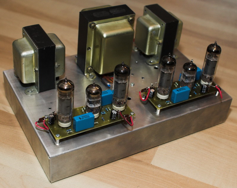

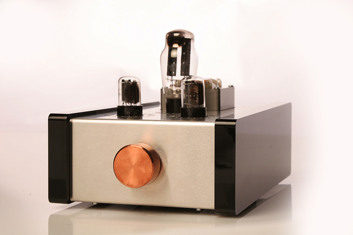

here's 2 other amps, more orthodox, say
Gerrit
