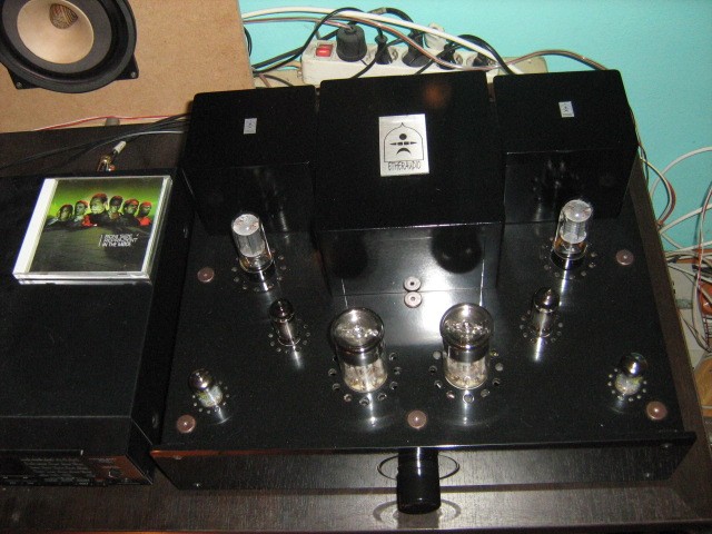

1st build
This is my first scratch build. 1626 Darling with a LCLCLC PS and 5V4G rectifier. Had to use a bucking trafo to bring the voltages down as my mains has been running 125-126V.

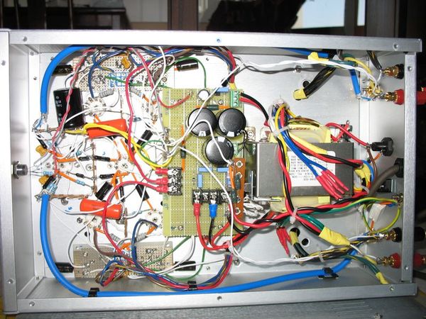

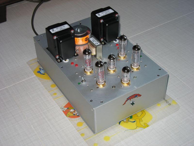

Some pics of a small amp to be. It is a 6AQ5-SE on a 100 x 110mm alu-plate. The final measurements till be slightly bigger as I really cannot fit the three PSU caps in the space.
Transformers are 5K SE-trannies from Analog-Metric and power tranny is a R-core from vt4c.com.

When you install the tranny, how do you parallel the primaries for 115 VAC? Red to Green and Yellow to Orange ?? (I get it about 230 VAC ... Green spliced to Yellow, right?) (I had some difficulties with a German transformer a while back, the colors were in German on the label and I had to Babelfish the US gringo wire colors to get a translation ... and still messed up. )
Answer:
I think, hope, pray and guess that the tranny is wired as indicated on the sticker. In this case for 230V I connect RED and ORG to line and connect YEL and GRN together.
Had I wired it for 115V, I had wired ORG and YEL together and GRN and RED together.
The latter may be the case as we will go to the States in June and I may (or may not) have reason to bring the amp and show it to some people as an example of miniature Swedish artmanship ...
If I had installed the mains transformer 1/2" to the left (or right) there would have been some space for the caps ...

Re: 1st build
Beautiful work on your Darling. I've been using mine for about 4 years & have yet to find anything I like better. I'm working on a "super" Darling (waiting for OPTs from MagnaQuest) & would love to shoot the breeze with you, specially since we're both in the Lone Star State. Drop me a PM if interested.
bloozestringer said:This is my first scratch build. 1626 Darling with a LCLCLC PS and 5V4G rectifier. Had to use a bucking trafo to bring the voltages down as my mains has been running 125-126V.
