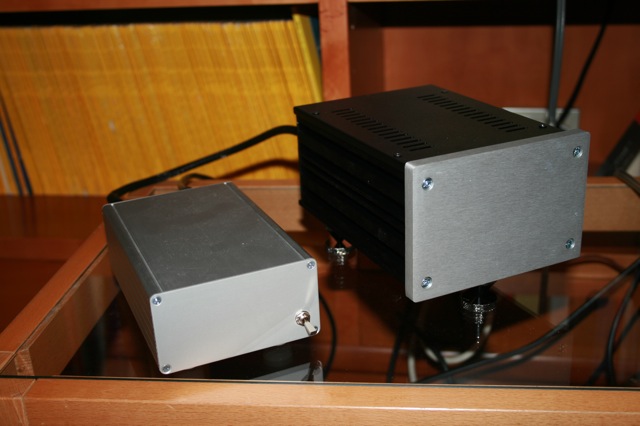

picture will follow and thanks for board&support

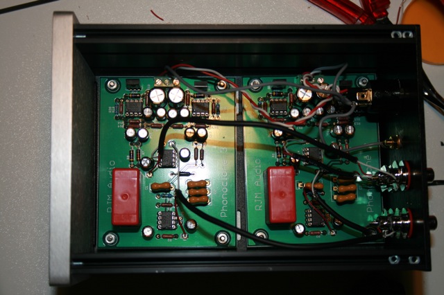

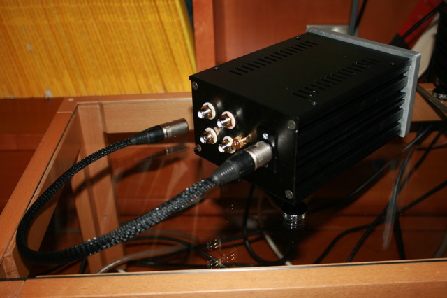

finally I completed my Phonoclone. It worked at my first attempt thank to your help! I could use for the first time a MC cartridge, a brand new Denon DL-103. I have no experience, but for sure the sound is much better when compared with my previous Grado Prestige Green MM cartridge.
The only problem I have, despite the metal case and the shielded wiring for the music signal, I have low level RF noise coming out from the speakers.
Thank you RJM and to everibody here

Hi Renato,
Is that a shielded cable from the board to the phono socket? If so, try grounding the shield at the phono end.
kffern
Thank you for your reply Kffern. I have not grounded the shield. I will do.
Please tell me if I am right: I'll connect the shield to the RCA input ground.
Since I used the same shielded cable to connect the phonoclone out to the RCA out, do I need, also for this cable, to connect the shield to the RCA out ground?
Thank you again for your help
Renato
Renato
Yes, try connecting the shield to the RCA plug ground. If the external cable has a metal shield it should be grounded on one end. I can't remember whether it should be at the preamp or the phono stage. Best to use an ordinary factory terminated cable till the problem is sorted. For such short internal cabling I'm not sure if it's worth using shielded cable. Maybe someone will advise.
Kffern
Kffern
Re RFI you just have to try a few things to see whether it makes any difference. The OP27 has a bipolar input stage which is more sensitive to RF pickup than sat a FET opamp, so you might try switching opamps, or adding a small (500pF about) capacitor across the + and - input pins of the input opamp. Also try switching phono cables, for example, and making sure that COM is securely connected to the case at the ground lug.

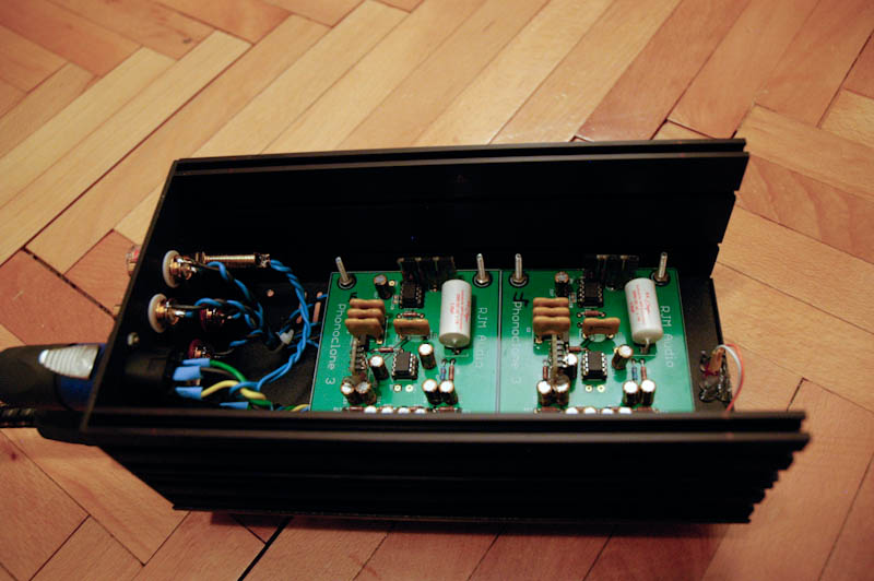

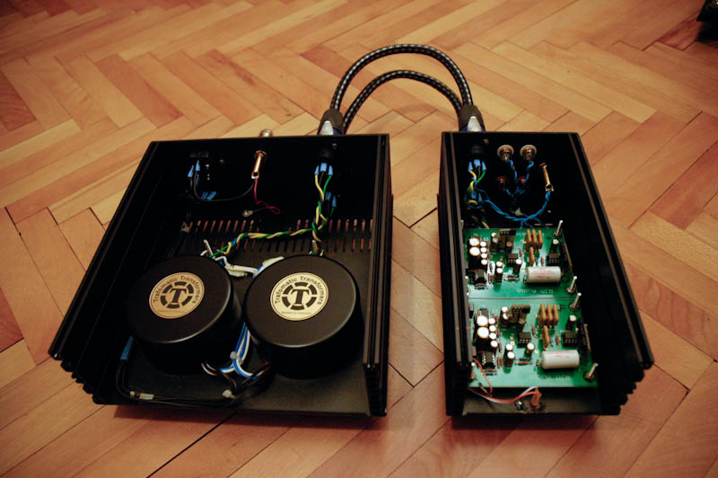

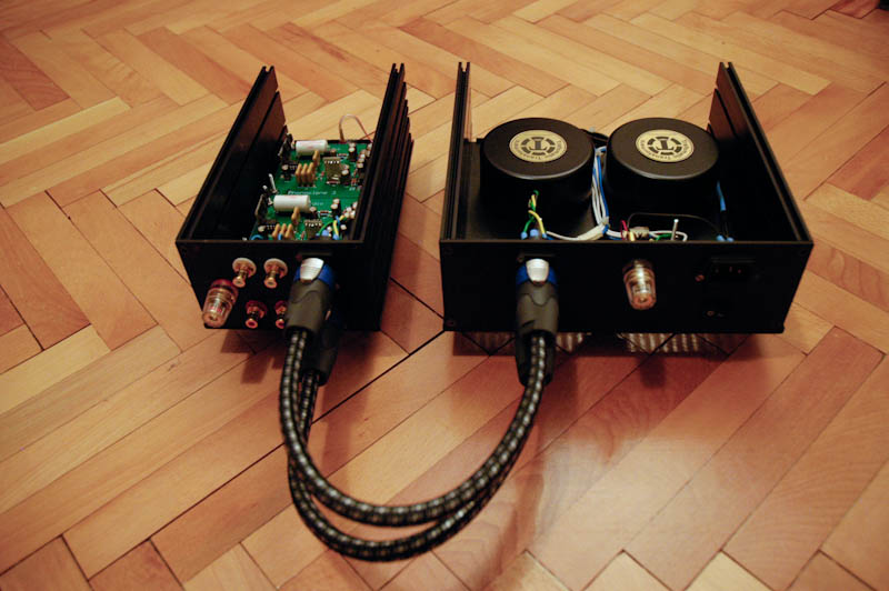

Here is my PhonoClone:
Standard BOM. HiFi2000 cases, Trafomatic potted transformers. Neutrik SpeakOn + AQ power cable for umbilicals.
Mundorf MCap on outputs. I have ZN coming soon...
...what is not standard is my contraption for easy loading. I attached a small PCB with 300, 400, 500, 1000, 1500 and 2000 CNF55 resistors [or close enough values].
Using MB style jumpers, I can select any combination of those in parallel and get a much larger degree of loading steps. Current combination yields ~170ohm which seems quite suited to the Ortofon Rondo Red I have installed.
Initial Thoughts
No perceivable hum or noise on normal listening levels. Some noise after 2PM on the volume dial... still quite negligible. Will give it a few days and see what happens. Happy happy right now.
More to come. I hope.
