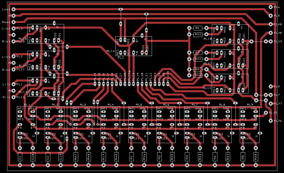

Another one of those questions where I have been blissfully ignorant for years as never needed to know :). I'm building a new preamp, which includes consolidating various functions that have been in seperate boxes into one. I have two turntables and, although most of the time one will be MM and one MC, I want to be able to support all combinations without replugging. And to be difficult I have seperate MM and MC phono stages. Both of these are firsts for me. Looking at the switching requirements to be able to be totally flexible relays seemed to be a good option. Then I started looking at specifications and realised that it's hard to find relays rated for Initial signals under 10mV, fine for a beefy MM but a tad high for a weedy MC, so I run the (worry of the) gauntlet of the contacts not whetting somewhere down the line. And herein is the ignorance. In a domestic environment with maybe 500 cycles a year max is there anything to worry about?
If anyone has recommendations for relays that work in this application and are not billet unobtanium?

Pickering reed relays from old blighty.. ;)
Pickering Reed Relay - General Instrumentation Reed Relays
Form B and Form C relays are much less reliable than Form A (NO)
Make sure you select relays suitable for low current/low voltage applications and make sure you put no significant current through them. Where an input capacitor is involved include a small amount of series resistance to limit charge/discharge current during contact closure.

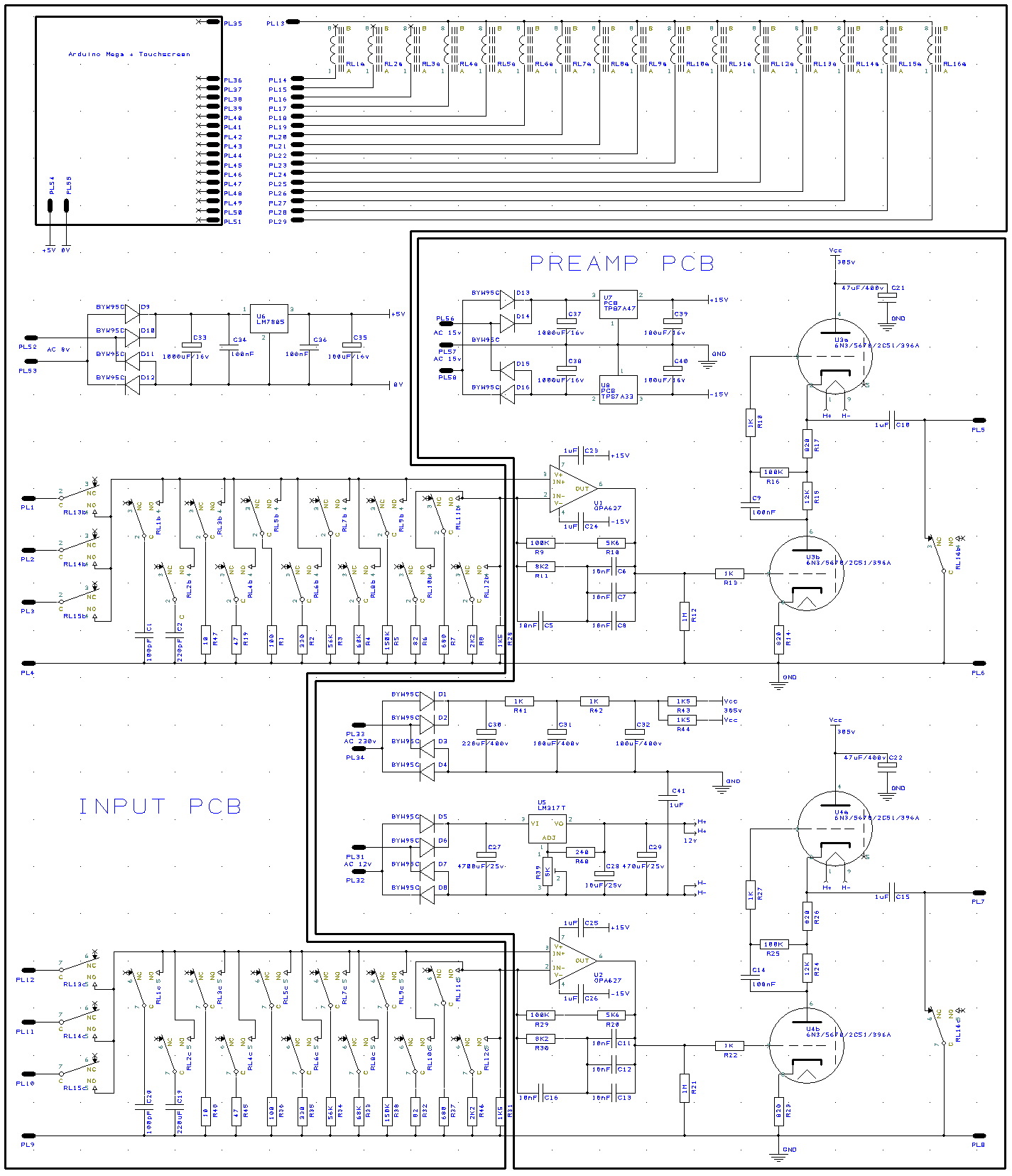

No capacitors in the signal path, balanced and servo'd all the way. Horrible 8-legs abound :) . I think I have mission creep down to a point where I can build it in non-glacial time!
One of the better small-signal relays I know of is the Panasonic TX-S series. The p/n's with the -1 suffix (see datasheet) are designed for low-level signal switching. I'm not a fan of switching cartridge-level signals; I'd much rather have the phono stage located in the turntable 'plinth'/base. I realize that's not your intent, but I'd consider it

I use a lot of relays for my phono amp, 3 inputs, mc or mm amplication and loading all switchable with relays. No problems with signal lost.

Capacitance is not as issue for the MM stage as I'm using a form of trans amp.

Sealed reeds are pretty good without wetting. I used Pickering Form A types in ATE hardware doing audio measurements at very low levels and had no problems.
Hopefully the relays offered are suitable. The Pickering stuff is very good as long as you design to avoid welding. (This is true of all reeds, no indictment of Pickering intended) No input capacitors goes a long way towards that goal.They will never degrade and will operate forever in this application. I got service lives of >2 x 1e6 contact closures without failure during test.
