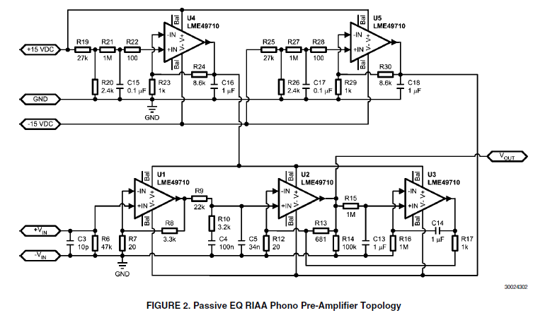

I wanted to collect the opinion on that implementation. Also, what is the idea of replacing the LM833 with the LM4562 or LME49710 ?

LM833 sounds pretty bad for a modern op amp. If you need low noise and FET input you may look at the LF353 but it will be noisy complared to the 833. Maybe an AD712 or if you can take a BJT input try the LT1028.

This is very seldom used even at the highest quality level. For a beginners design which may be based around an LM833 and powered from 7*15 regs it is completely inappropriate.

Please do not use an 833- that thing is unstable and sounds like 10,000 squeaky toys tossed in grinder!

Please use a socket (link in earlier post) for the op-amp so you may try different op-amps. Op-amps are cheap to buy and if you make it so they just plug in you can easily discover which one sounds good. The LME49710 is another one of those "optimized" to look really good on paper without concern for the actual sonic performance. The LM833 is exactly the same type of "optimized for audio" opamp. We have already discussed that waste silicone.
Why is the output of the top opamp connected to ground through a 1µF capacitor? That will make the amp misbehave. Can you explain or maybe I missed something.- thanks
Hello Allen,
Good to see you on this thread. Instead of the LM833, I am planning to use the National LME 49710 opamp.

in the National Semi app note the upper op amps are acting as sub regulators for the ps, I would expect the caps on the op amp outputs to need some esr to maintain stability
I do have a philosophical problem with the flat gain block and passive eq topology:
LM4562=dual LME49710, the same app circuit appears in both part's literature
active riaa feedback keeps the feedback factor more nearly constant and keeps slew rate and overload demands much lower

...assuming the gain blocks are perfect and giving them no further consideration is the logical error in recommending this design
The LM4562 is a high gain, "low bandwidth" device with integrating frequency response with a corner frequency below 10Hz
from 20 Hz to 20 KHz the open loop gain and the feedback of the "flat gain" blocks will fall 1000x
I think some of the usual criticisms of feedback amplifiers might include "falling feedback factor", "rising distortion, output impedance with frequency", and Otala's PIM
all of which are worse with the flat gain/ passive eq topology than if you implement the RIAA roll-off as active feedback
then of course you're feeding the input with a pre-emphasized signal that boosts 20 KHz by 40 dB over the 20 Hz level – to the point that the circuit has to “burn” some S/N at high frequency to keep any overload margin
I suppose you could argue that the LM4562 is so good that this bad topology would make the LM4562 superiority stand out from most other op amps in the flat gain blocks
The top opamp's are not a part of the audio section. They are part of the power supply.
