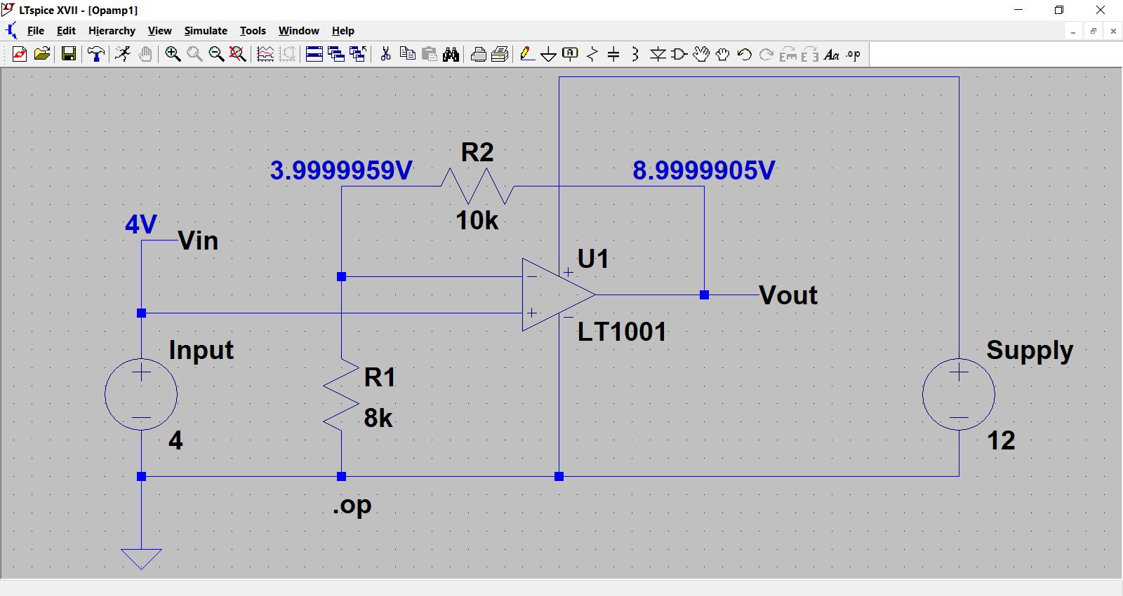

The golden rule for an opamp used in audio (which means it will have a normal feedback network wrapped around it) is the output will go to whatever voltage is needed to maintain the difference between the two inputs to zero (zero for practical purposes here).
See if this makes sense.
The opamp has 4 volts applied to the + input. In order to see if the rule works we need to get 4 volts on the - input and the opamp output will automatically do that for us via the feedback network...
Here's how:
4 volts across 8k means a current of 4/8000 has to flow. Just ohms law. We also know the opamp inputs draw no real current to affect things. So from that we can say that this same current must also be flowing in the 10k resistor.
If we do the maths we get 0.0005A in the 8k. Multiply that current by 8000 and we get 4 volts. Now multiply the same current by 10,000 and we get 5 volts. So the total voltage across the two resistors is 9 volts.
The working simulation bears that out.
We can then go on and say that the gain is actually 1+(R2/R1). Does that work ?
(10000/8000) + 1 equals 2.25
Multiply our input voltage of 4 volts by 2.25 and we get 9 volts.
So relating that to your fault, if pin 2 (the - input) is lower that pin 3 (the + input) and the opamp output is high (yours is) then we either have a duff opamp (and tbh that would have been my less likely option... but it happens ), or something is pulling pin 2 down.

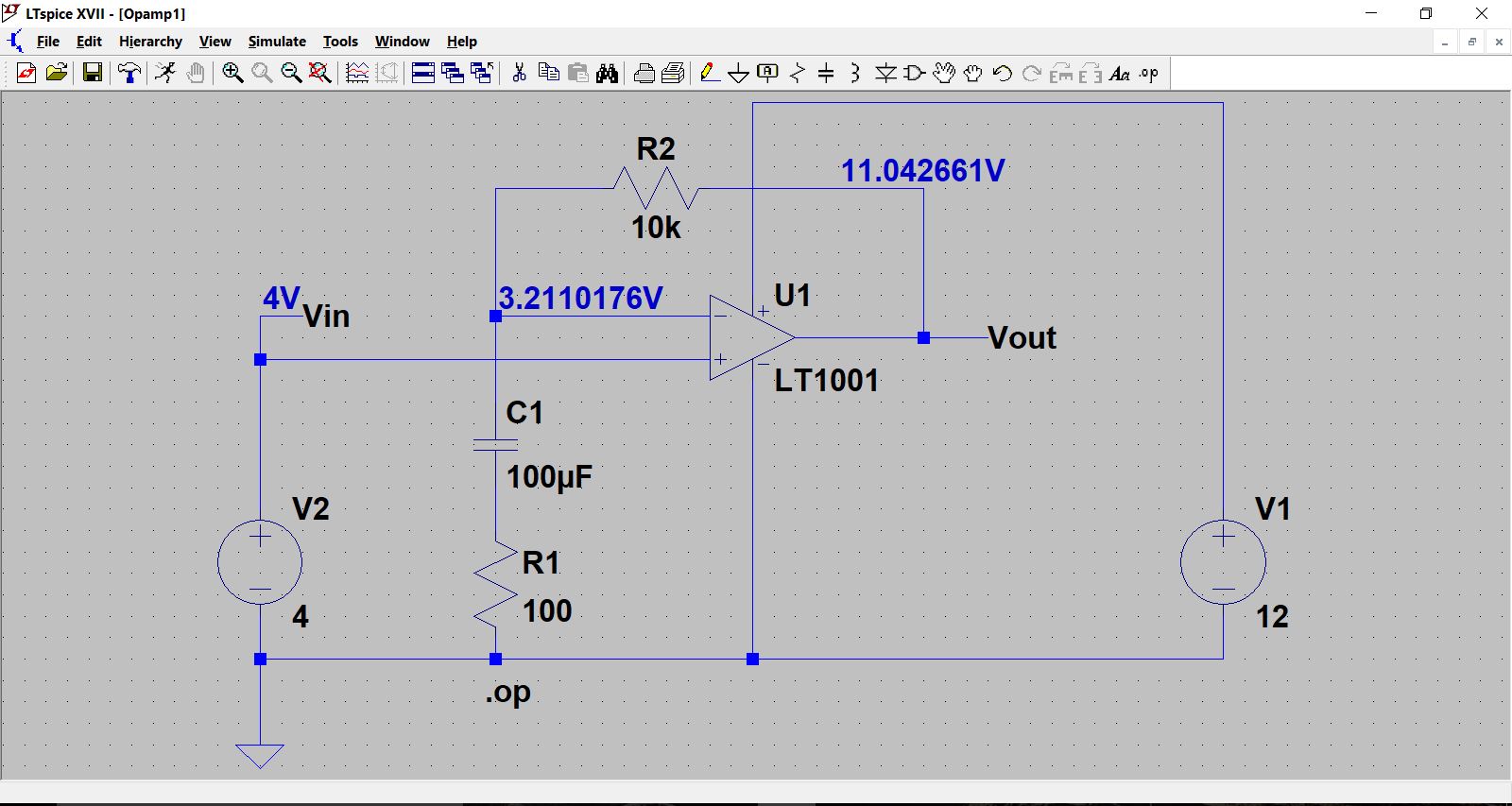

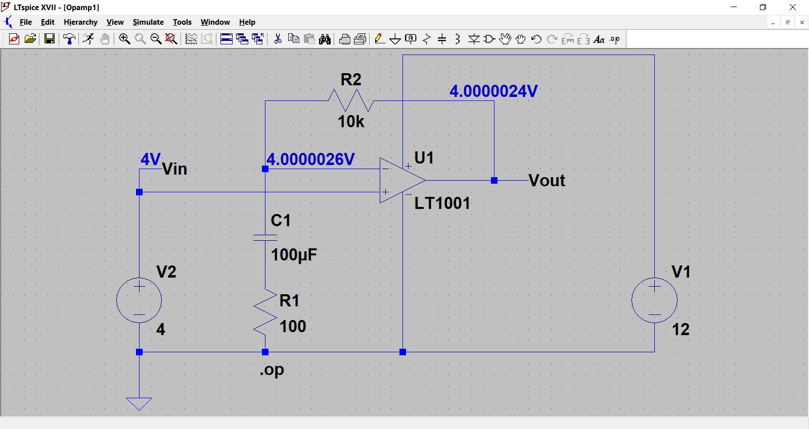

This shows the same basic circuit but now configured for a high AC gain. The capacitor blocks DC current.
Can you see how the same rule applies to the DC conditions ?
For the difference in voltage between the two inputs to be zero, we need 4 volts on the output.
In the second picture I have made the cap leaky (4k resistance leaky) so that it draws current. The opamp wants to try and bring the voltage on pin 2 up to 4 volts and so maintain the 'zero volt differential' between the two inputs but it can not because of the limited supply voltage and the high value of feedback resistor.
This is similar to what you are seeing. The big question is whether the opamp is duff, or..........

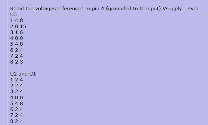

Molly, I think I grasp most of the info you kindly provided me. Printed out the circuits and followed along with your description - thanks again. I had to do some reading on RC networks while I was travelling for work, that was useful.
Hans, I have followed your instructions, and using U3 pin 4 as the ground I measured the following resistances and voltages. The results do not look the same as I previously posted. Also got myself some fine pointed leads for the DMM - that is making things easier,
Resis;Marked;Measured;Resistance to GND from each side;Vdc(r-gnd)
R27; 332; 3.3K; 960, 4.2k; 0.56, 0.14;
R29; 333; 33.2k; 37k, 4.2k; 4.8, 0.56;
R36; 331; 326k; 640,960k; 0.15, 0.01;
Redid the voltages referenced to pin 4 (grounded to to input) Vsupply= 9vdc
U3
1 4.8
2 0.15
3 1.6
4 0.0
5 4.8
6 2.4
7 2.4
8 2.3
U2 and U1
1 2.4
2 2.4
3 2.4
4 0.0
5 4.8
6 2.4
7 2.4
8 2.4
I also did some continuity checks and perhaps C24 and R29 are not in parallel in the feedback circuit, but in series, as determined with continuity checks either side of the capacitor.
The resistors aren’t be shorted.
C23 has continuity to ground on one side only when tested with the DMM so it has not shorted.
R15 is intact 47k
R25 is marked as 10k but measures 5k only in circuit.
Does this get us any further?
Cheers

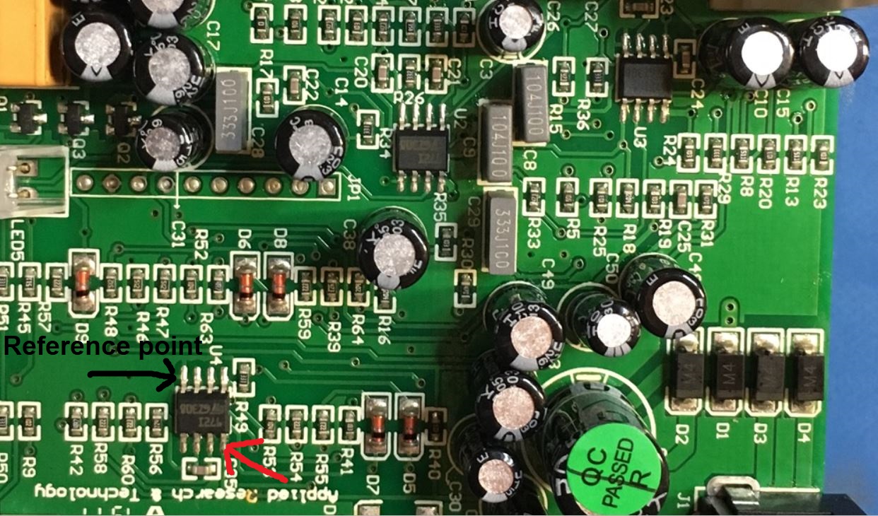

Those voltages aren't making much sense tbh.
Lets start again with basics. If you place your meters black lead as shown here (marked reference), what voltage do you see on pin 8, marked in red ?
Also, are we in agreement that the opamps are of the same pinout as the TL972 ?
You should be seeing the full supply voltage between pin 4 and pin 8 if the opamps conform to that pinout.
Also, if you then measure any DC voltage between pin 4 and the outer ground part of the RCA sockets are you seeing zero volts ?
You should also (amp off now) read virtually zero ohms between pin 4 and the sockets.
Keeping your meter lead on that same pin 4, you should also see the supply voltage on pins 8 of the two remaining opamps U2 and U3.

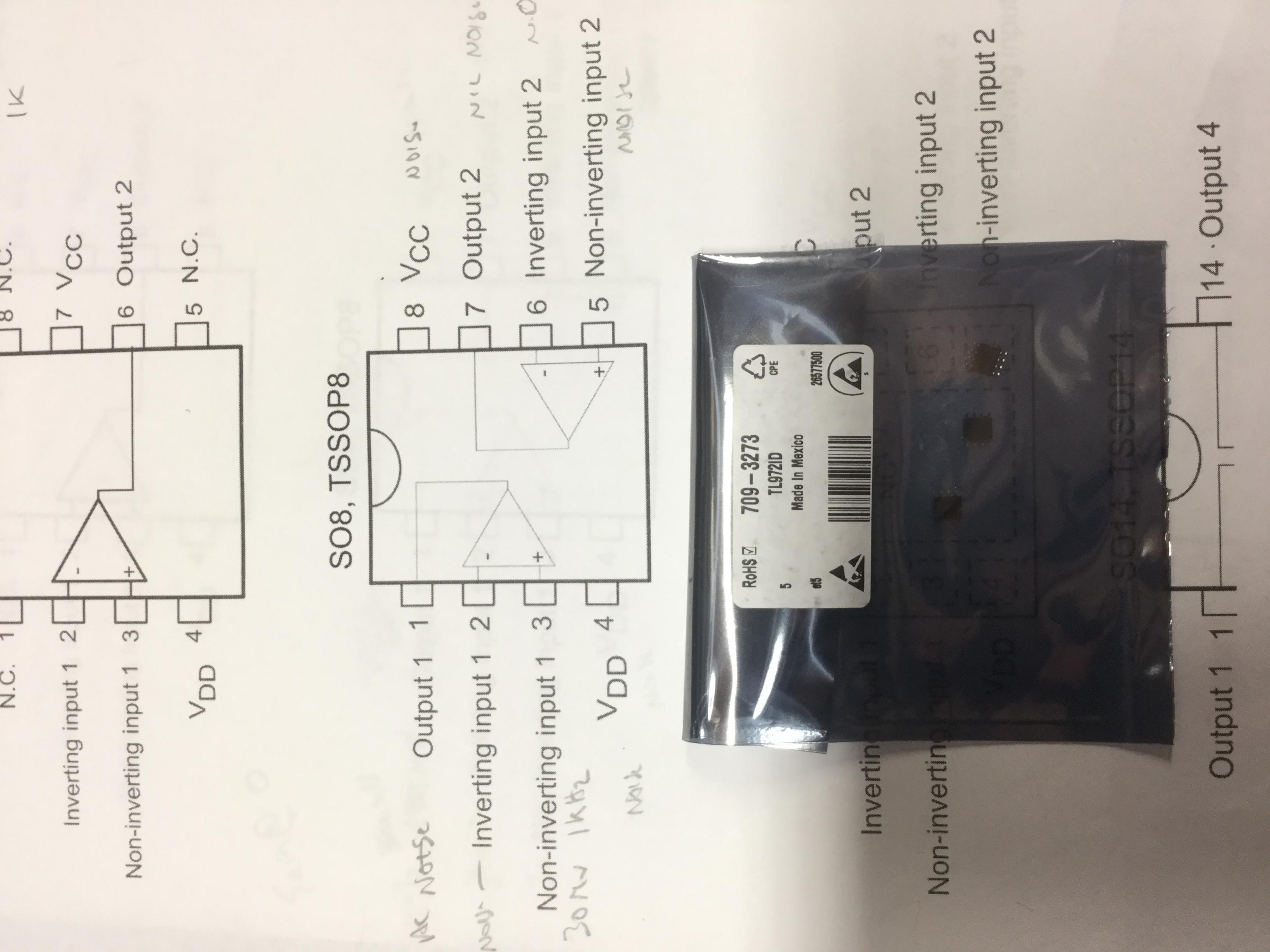

Hi Mooly,
I have attached a picture to show the opamps I installed and the pin diagram I used today. I have been measuring the voltages as indicated referencing to pin 4. (Vdd in my schematic).
Between pin 4 and 8 on all opamps on the board V= 4.8V. I believe this is the correct supply voltage as the SN7805PI is a 5v regulator. Sorry, only mentioned 9V previously.
Pin 4 is connected to the RCA grounds, zero volts. Zero ohms - correct.

OK So the supplies appear correct at 4.8 volts. That was the first thing to prove.
In your readings above you have pin 8 for all the chips as being around 2.4 volts and pin 5 as being 4.8 volts. So that means there is of course doubt over all the other results.
I think if you could repeat the readings for all 3 opamps keeping the black lead firmly on the point I marked above and then lets see where we are at.
Does that make sense
