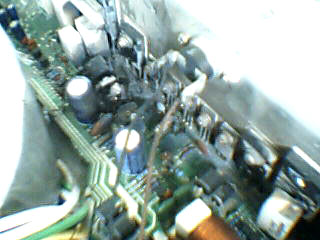

need help, I have a blown phonic max2500 in my shop, some parts (resistors) were burned even the pcb markings were charred, it would be very hard to identify the burned components, I would like to ask a copy of its schematic diagram and if possible the copy of its parts placement guide please. Thank you very much. Have a good day everyone.
P.S. I still like the phonic Mar series and the Xp series they are really tough amp.
P.S. I have seen the new phonic dmx series, the board were the QSC RMX Series just like the Beringer EP2500. Can someone enlighten me on this. thanks
