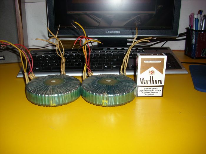

I like the slim design on the phonic but concerned about the power output. Hard to imagine there is a power transformer inside considering how slim it is.

It is very simple class"H".
Older brother is MAR1.Great Amp. low profile!

It would perform perfectly well. Class H reduces waste heat. But a 60 watt amp doesn't generate enough of that to get upset about. It does cost a little more to implement, and all other things eqaul, won't sound quite as good as the same amp in class B (AB).
Hi!
Why not? look att. 200VA/4 x 22V, each.
