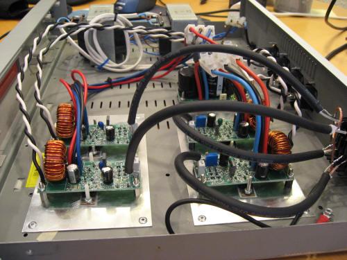

UcD vs. Hysteresis
Just finished my project of comparing a UcD and a Hysteresis class-d amp, based on the same basic construction.
The construction was made to be as cheap and small as possible, but still delivering a good performance.
I think it is an interesting litle shootout.
Take a look at my homepage for more information :)
If anyone is interested I could post the Gerber files for the PCB.
The construction is really easy to get to work, and boards can be ordered directly from PCB companies like Olimex.

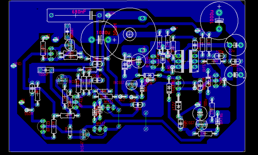

Hi! Im new here, basicaly search and read on this section and SMPS section.
Im try to implement a UcD amplifier based on Philips manual and I spend some hours making a first layout for a single layer PCB and common components (no-SMD). My first layout work!!! Poor layout but play respectable sound. But mosfets runs hot, very hot.
My corrected layout is above. Sugestions are welcome.
Do you any candidate to substitute BC640 as turn-off buffer?? (easy to find and cheap please!).:D
Sorry my bad english!
