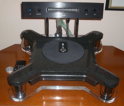

Hi all,
I am new here and found a very good forum, tons of infos.
A freind of mine have a problem:
He owns a ALTIS alpha centauri Cd transport and lost the little plstic centering device for the Cd and the magnetical puck? thats hold the CD.
The drive is a CDM12 Industrial from Philps.I also have pictures but have to learn how i can upload that.
Searching a little on the net, i found that with the CDM12 industrial are 4 differents laser available and how ? many motors?
Where i can find this plastic device and which drive beside the PDM 12 have the same item?
Is there an partnumber or source to buy it?
Is there a replacement drive from daisy for it?
I think its a good idea to look beside this fixture also to search for the whole transport or least for the laser as the Altis is coming in the age.
Please help, so my friend get enjoyed and i get some wine for helpng him.
Please let me know,if more infos are needet.I have some picture and measurements from the CD table?

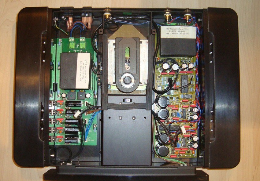

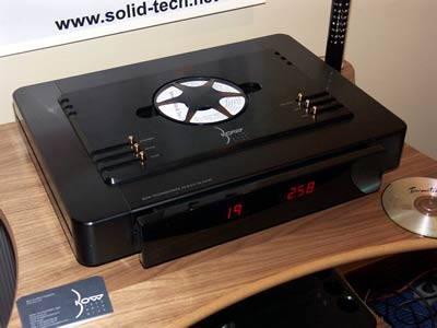

ALTIS "Alpha Centauri" ? I have never heard of them until this day. Is it the modell from the first attachement? Who is ALTIS?
I find this only
http://www.usedprice.com/items/audio/altis-audio/audio-converter/index.html
and
http://www.stereophile.com/news/11158/

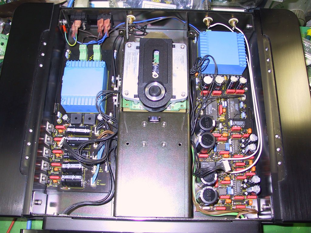

Then you have the same problem as I some weeks ago with a BOW Technologies "ZZ-8" (second and third attachement and these at follow post)
About Bo Christensen's new company
ARTORA.COM
you can try to order the clamper stuff for the "ZZ-8", if that one from photos in the follow post are the same than yours needed

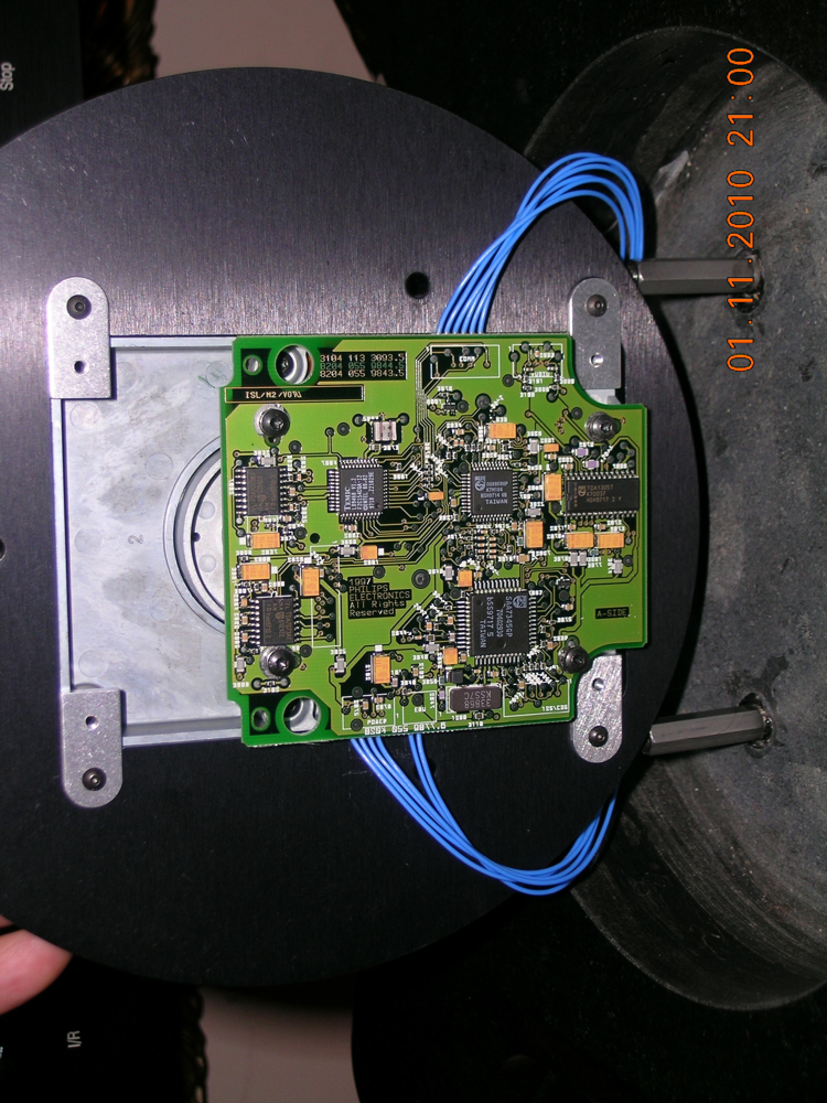

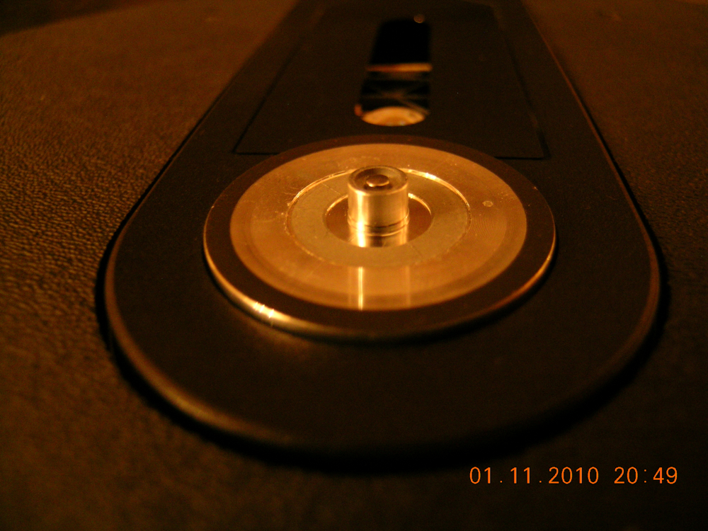

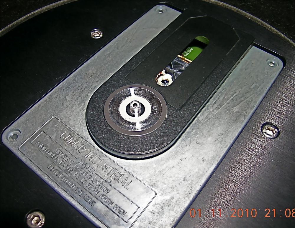

Hier noch ein paar Bilder
Danke für die Hilfe

Here are some pictures in my local german mail
the numbers on the PCB are
3104-113-3093.5
8204-055-9844.5
8204-055-9843.5
Thanks for the assistance

Hallo Robert,
By your first post you have mentioned the missing plastic centering device.
Now you want to remove the stroke or “nipple” from your turntable/motor pulley?
This I don't understand. The stroke/nipple is a part of motorpulley - both are one device !!!
As I know, removing of the motor pulley isn't possible because the risc of destroying the disc motor (there are no setscrews !!!)
When I look at photo 1 from your post #7, I can say, this looks exactly like the mentioned "ZZ-8" without plastic centering device.
The question is now, which centering device is the appropriate for you - Bow technologies uses two different for the "ZZ-8".
That one from photo 1 or that one from photo 2 of post #6 (show this both photos your friend - the owner) ?
If you don't need a new disc motor, then you also don't need a new CD-mechanism. Laser heads and other stuff of CDM12 industrial/CDproLF-II/VAM/VAU1254 there are individual.
But If you destroy your discmotor, then you must buy the currently CDpro version, i. e. a wide range of additional work to match the requirements to your ALTIS transport (see URLs of post #5)
