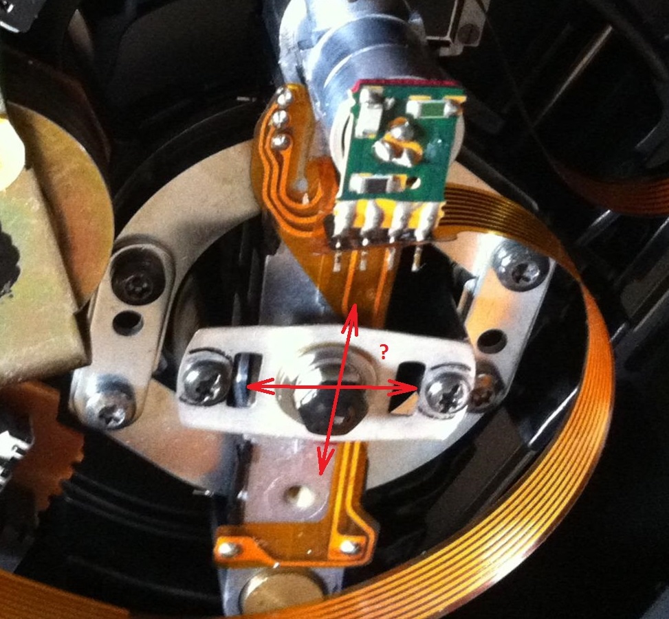

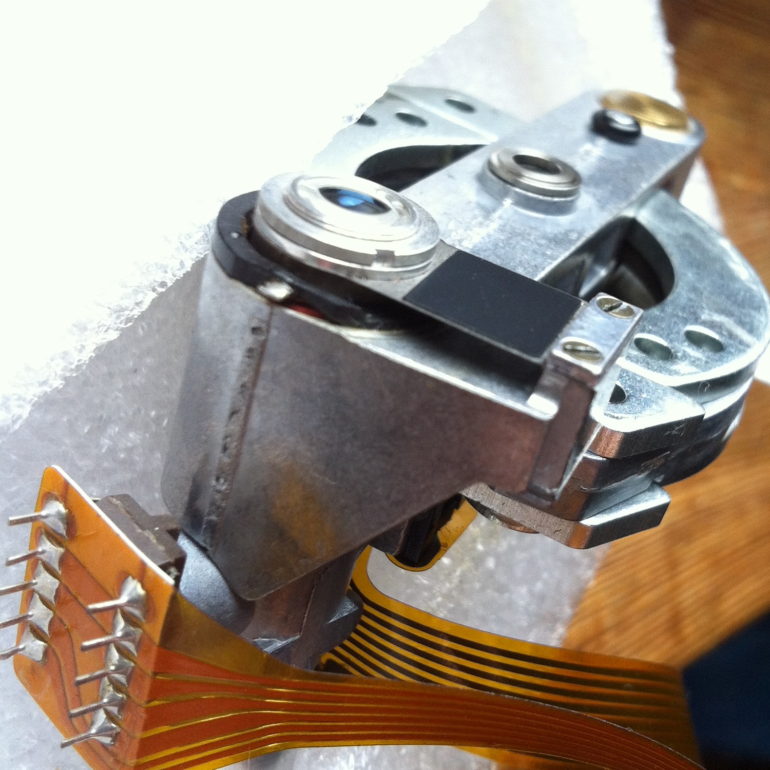

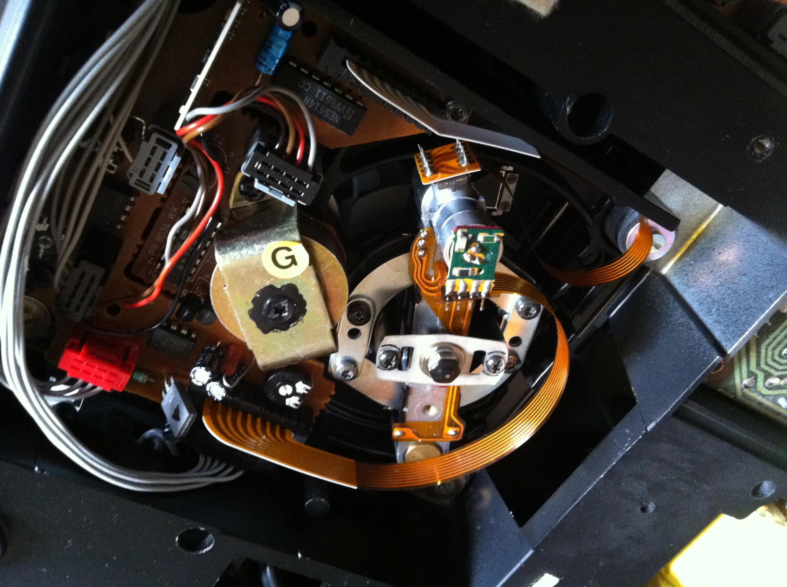

I experienced a mishap:
Forgetting the fact that the upper lens is not horizontally aligned by servo-coils like in traverse mechanisms,
I tried to remove it from the swing arm for further cleaning of the optical system.
The upper lens is attached to a thin metal bracked that is fixed by two srews to the swing arm. (A black square sticks on the bracket)
After finding out that further disassembly is not possible, (the upper lens can not be lifted from the assembly)
I wanted to reassemble it, finding out that there is some horizontal play of
of the lens until the screws are tightened.
I had to fix it by the eye, trying to have it as much centered as possible.
How crucial is a centered position of the upper lens? Have not reassembled the CDM-1 yet to find out...
(Picture was taken after I put the lens back in)

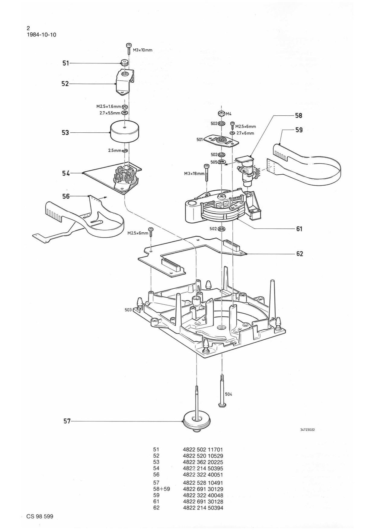

Before disassembling the CDM 1, one should know that one plate will have some play and needs to be realigned:
It is a metal plate, holding the lower bearing of the swing arm. It is mounted with two screws and washers to the chassis.
To reassemble everything, it should be easy to marl the area around the washers with a sharpie, but the washers have some play and are never centered.

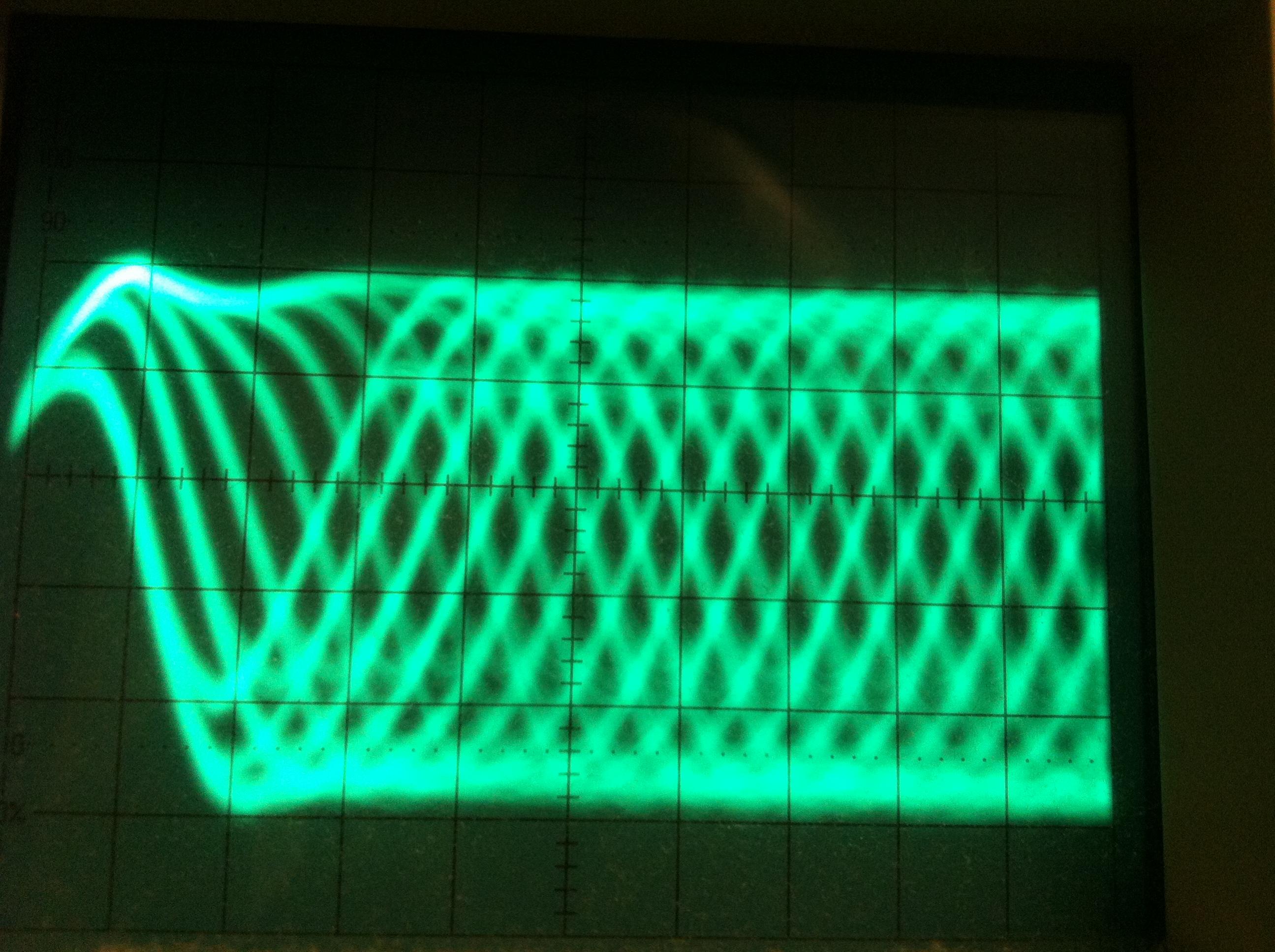

But there was still hope - the eyepattern and one assumption:
That designers never like to work with fractions. If the heads of the screws are sitting perfectly symmetrical in the mentioned plate, this should be a good starting point.
Et voilà, eyepattern, though blurry. I did not use washersonly the screws. The reason: Sliding the plate around to find the sweet spot will put the washers out of center.
Thus fastenig the screws will move the plate, one can observe it on the eyepattern.
I was very happy to have found the sweet spot at once - followed by the frustration that this clear eyepattern became blurred on other parts of the disc.
Up to a point, where the disc was unreadable..
The false spot is when the eyepattern rises a bit in amplitude and becomes clear but also wavy - this point is too far.
The sweet spot is at a point, where the wavyness is almost gone but the eyepattern is still realitively sharp.
Not easy to find. With screws just a bit tightend to allow grip an movement at the same time, the plate can easily
slip from one maximium to the other.

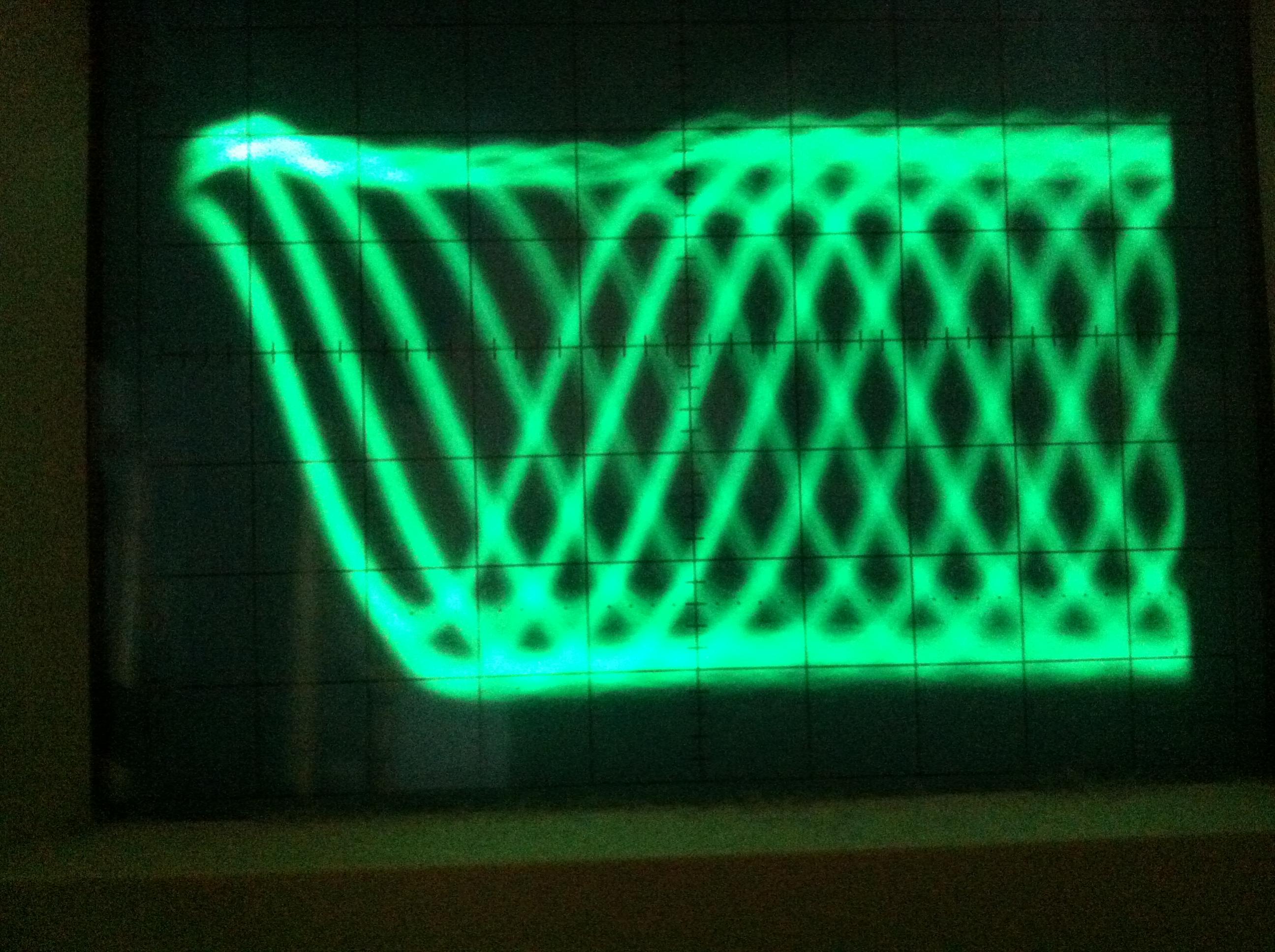

The overall horizontal derivation according to the focus signal is 80mV
between the first and last track. I will try to get this better.
The photos indicate that the sweet spot has not been met yet:
Or the upper lens I unfastened by mistake needs alignment as well...

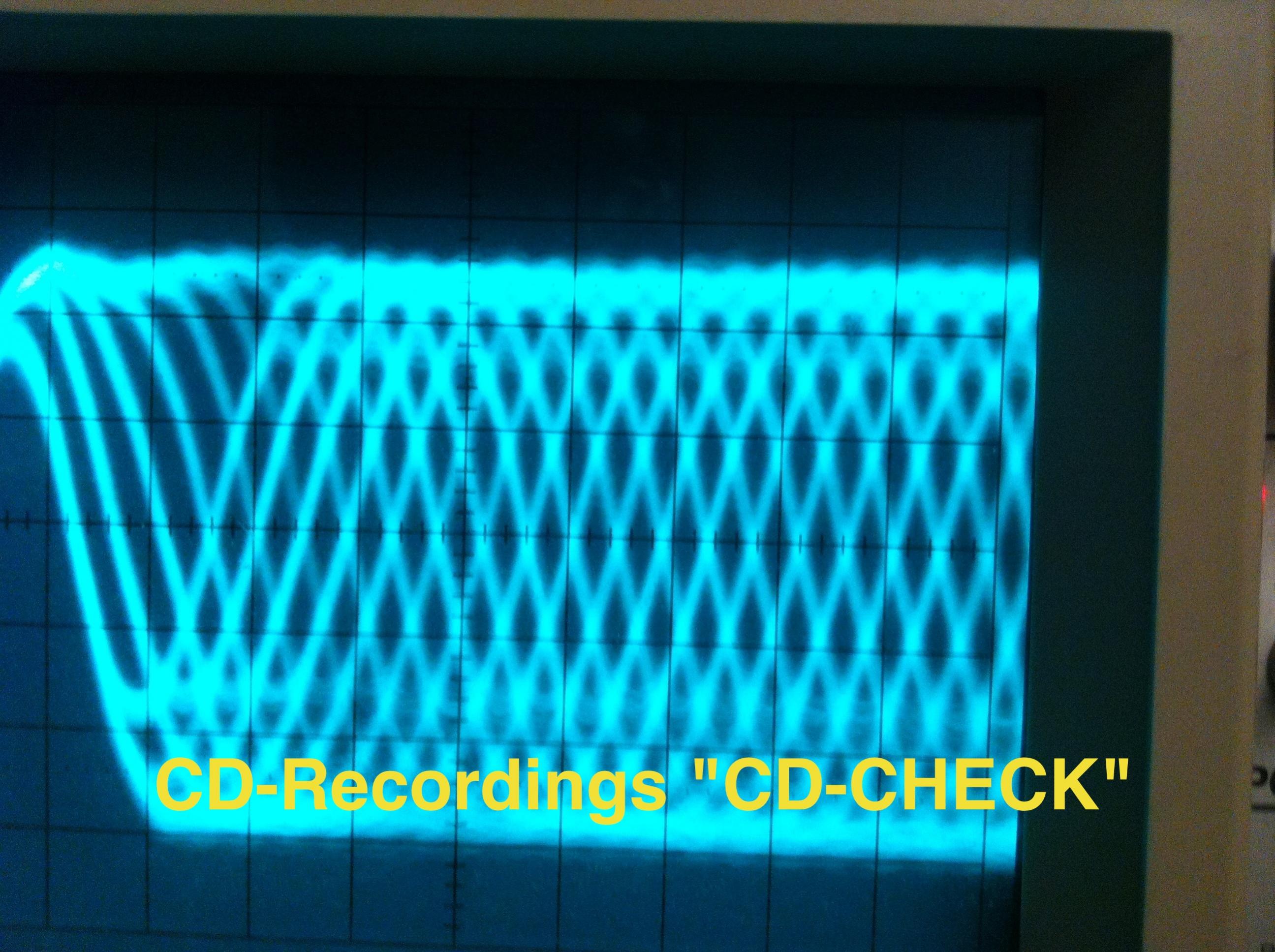

The first eyepattern was photographed before disassembly, the second after reassembling and the described alignment. Looks a little bit more blurry.
The third photo shows the reassembled CDM-1.

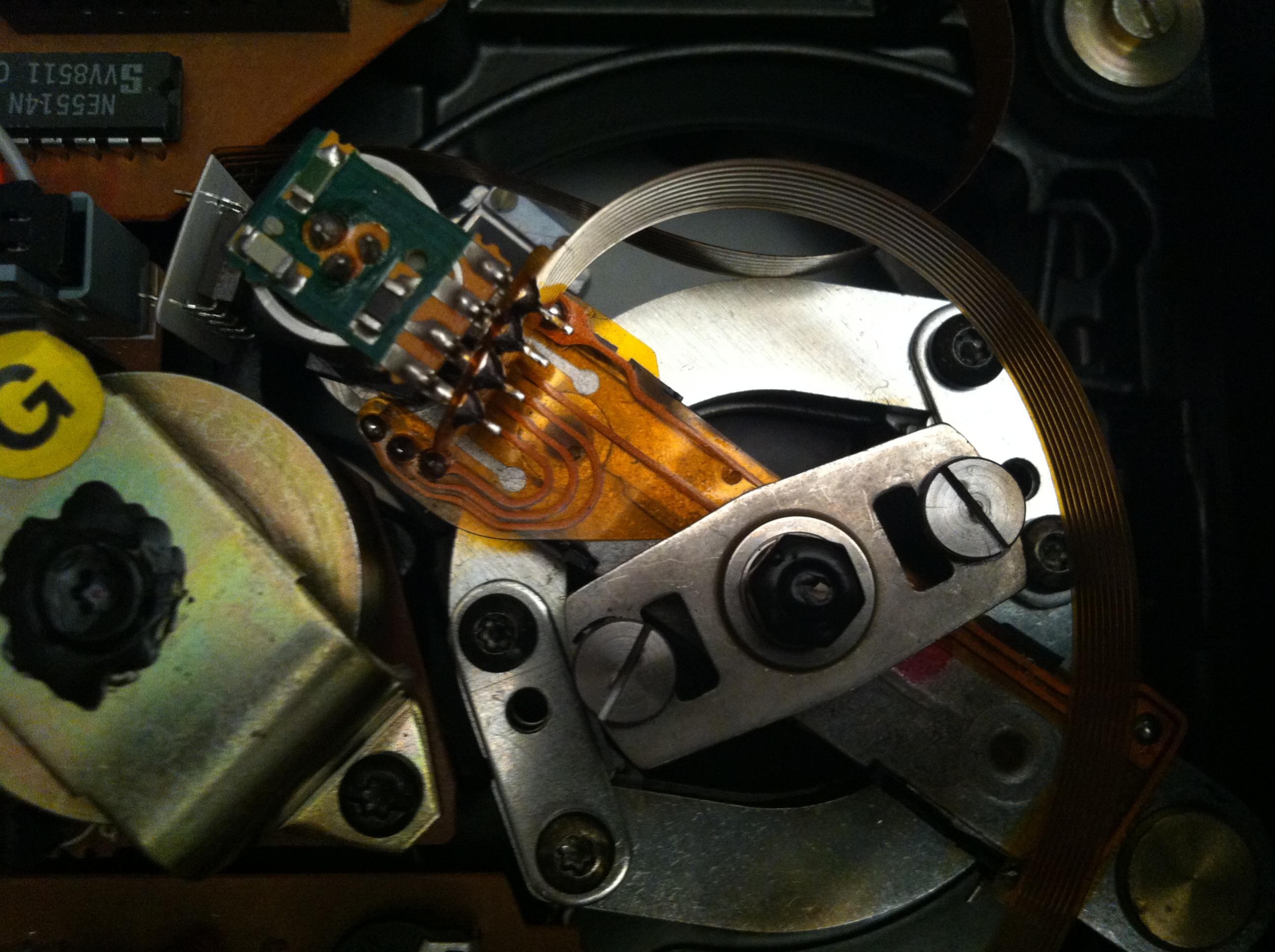

Hello scsazar,
watch the third photograph. You can see the markings around the screws.
But they were not precise because of the washers. The screws have diameter
2.5mm, the washer have 2.7mm inner hole. This is standard, but gives play.
Thus the plate 501 will move when fastening the screws. I just left the washers away. In the attached drawing only 1 screw and washer is shown.
I did only touch part 501, with screws fastened that much that the plate 501 can be still moved. Symmetrical means that the plate 501 sits in the middle
pf chassis 503. You can more feel it with your fingertips rather than seeing it.
You can follow the method without disassembly. If the swing arm is too stiff,
(it should bounce forth and back two times) just loosen M4 a bit.
Then loosen M2.5x6 completely and remove the washers, put M2.5x6 back
in and tighten them that much, that the Plate 501 can be still moved by some force.
But I strongly recommend to do this first:
Make sure that the two screws M2.5x6 are fastened. Remove the first screw carefully without touching and accidentally moving plate 501.
Remove washer. Put the screw back in and tighten it. Then do the same with
the second screw. You could also replace them with flange screws while doing so. Now mark a circle around the screw heads, with a thin pen.
The pen will always leave a tiny blank area between screw head and plate
as reference.
Doing this, you will have a precise marking as a starting point. Again: With washers it would not be precise. Do also mark the direction of the plate 501.
If you fail in aligning the arm in better than before, you can still return to
the original alignment

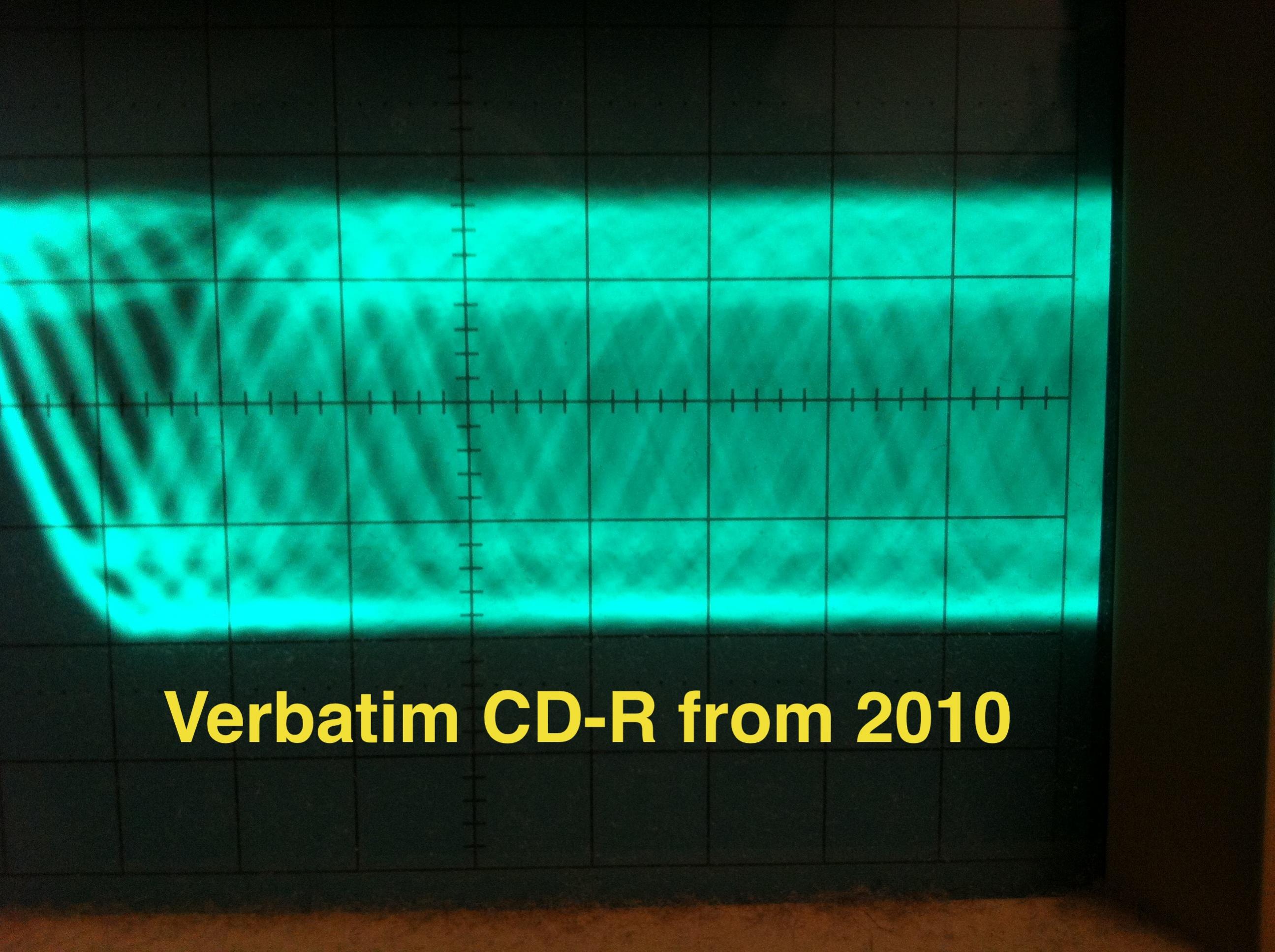

I assume this must be ballpark now, with strange effects: A CD with artificial defects "CD-Check" from the Canadian company "Digital-Recordings" plays very well,
a battled and scratched Polygram CD from 1983 (first CD-plant in Europe) skips.

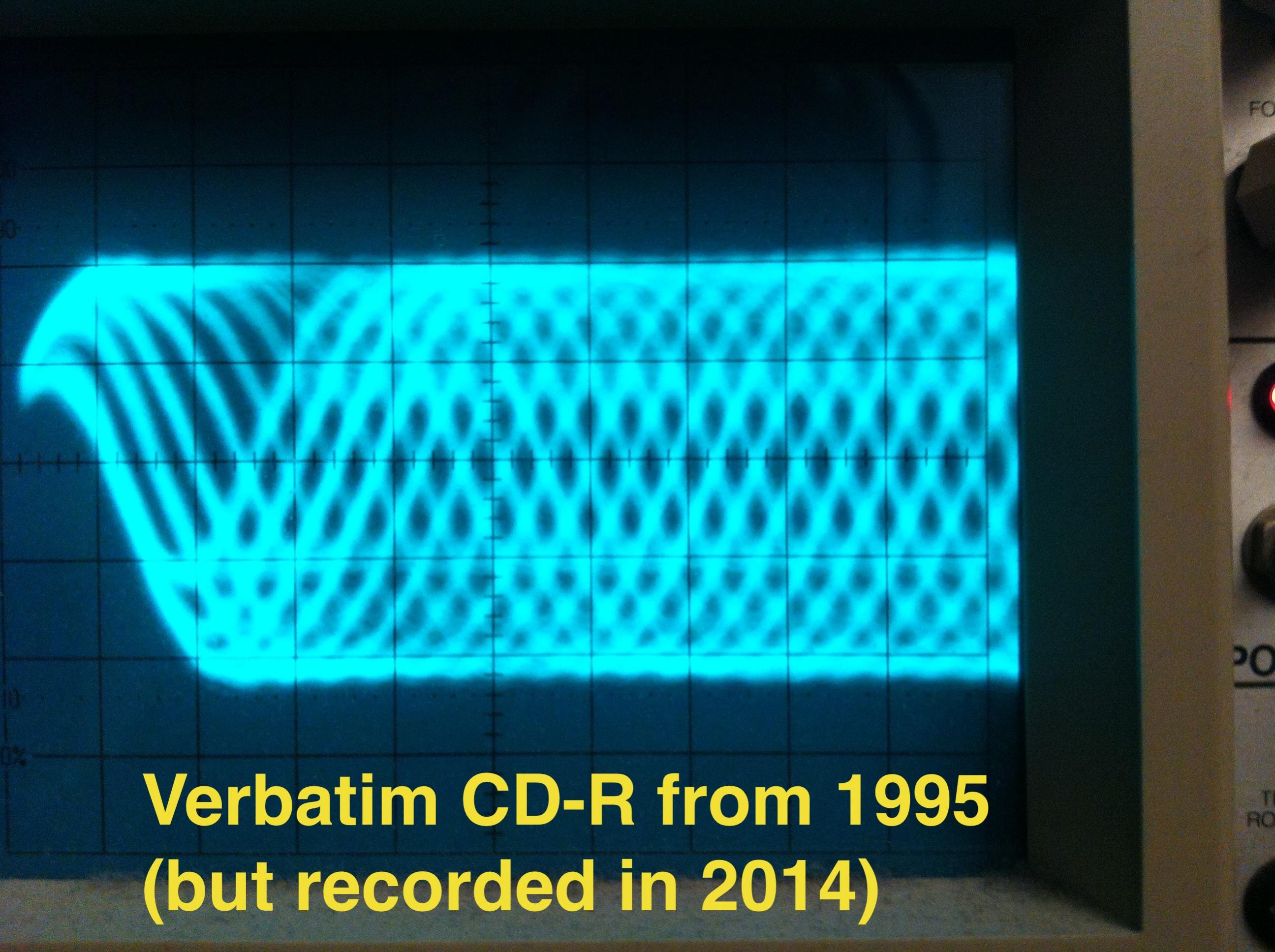

Also very interesting: The Sony YEDS-18 Test CD for player alignment is more wavy than a CD-R and some ordinary pressings from this millennium.
Also very interesting: A CD-R I bought for about $15 in 1995. (Not for 50pcs. For one CD), I found it unused in the cellar in 2014 and burned it.
On the Philips today, it shows a much better eyepattern than its successor from 2010.
Still, the Philips will not play the outer tracks of any burned CD-R without slight dropouts. Something to explore. BTW, I did not change any electrolytics yet or played with the tracking gain.
So I hope there are still some improvements to be made.
Some photographs of the eyepatters. I did lower the voltage to 1Vp-p as stated in the service manual.

You need to play with the plate´s screws a bit. Fastened enough for grip and still allowing movement. Again movement means fractions of a millimeter here.
I got to a point, where I even did not feel the plate moving with my fingers, but noticed the change on the multimeter.
A scope is for controlling sharpness of the eyepattern. But a sharp pattern should be a logical result anyway. Finally, the turntable height can be adjusted as well until 0V offset are obtained.
Finis - I hope!

You´ll have to try out. I think pushing left -with the font panel facing to me- was a good starting point to me. It is a little bit pushing, a little bit turning.
Took me almost an hour to find the sweet spot. At least I could not do the work with the player upside down like in your photo.
The player has to stand in normal position between chairs or piles of books
You need to move the laser along the two imagined lines:
a) one that connects start and end positions of the pickup, as they have to be in the same plane, i.e. at the same distance from the disc surface
b) line that connects the pickup midway position to the pickup axis center.
The start, midway and end position would form a triangle in which each corner point should be on the same plane or at the same distance from the disc.
Departing from this, determine which moves of the shin would accomplish this.
