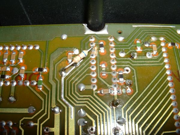

Today I removed the SAA7030 as described earlier in this thread. It works perfectly. The sound seems to be bit more open, more detail, just more present (more piano). But, this is all impression, I did not compare to a non-modded 104. My reference is still the modded Marantz cd53.

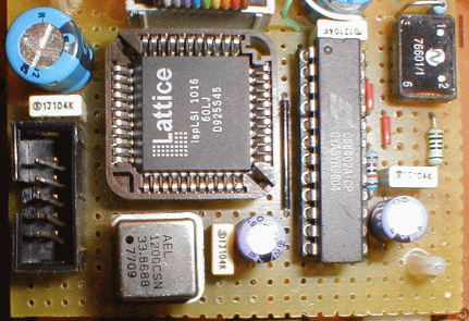

The audio board is not so empty anymore.
jives11 said:
wow - makes my do I / don't I thread about a single choke look a bit silly.
Is its as simple as desoldering the filter and putting those jumpers across or did you have to change any components underneath
Almost; desoldering the filter, putting the jumpers in ..... and disconnect pin 16 of SAA7000 from earth (I scraped the track, there is just 1mm available, be careful!!) and put a 1K resistor between pins 16 and 18.
I want to fit all in the case so no high voltages... hence the minitubes.
Is that I2S? Sorry, I do not have the experience to recognise components.
Andy : I will now certainly try the Thorsten version, uhhh.... a hint for the kathode resistors?
Hence the digital output. A lot more options when there are no space retrictions.
LSB justified data not I2S. The ispLSI1016 is a CPLD, basically a large PAL. The CS8402 is the SPDIF transmitter. Both parts have been obsolete for a while and are best avoided. I used them because I had them and there was no need to lay out a board. Another reason not to use the CS8402 is that it unnecessarily complicates matters in this instance, it being a 2Fs device in a 3Fs world.

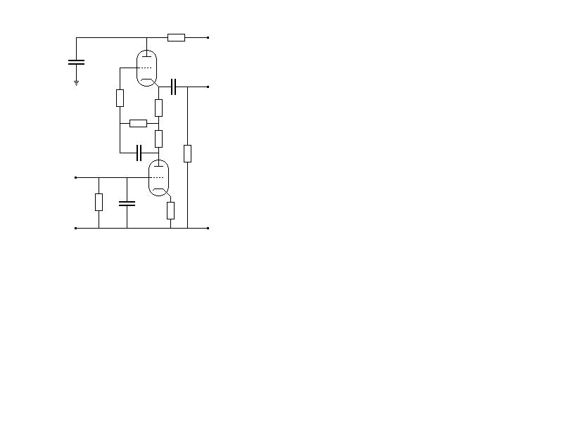

On www.triodedick.com I found an article on a mu-stage. This mu-stage would be an improvement over the above mentioned circuit. Interesting is that the second triode could be replaced by a MOSFET. Not sure about the size of these MOSFETs but this could mean a smaller (size/volume) circuit with just one twin-triode and two MOSFETs. From the transformer we could get 100V through voltage doubling of the 50V output, perhaps this would be enough. Started reading John F. Rider again as I could not even find the load in this mu-stage thing.......
Any clever ideas are welcome.....
I just bought five 6021's from Ebay. :)
