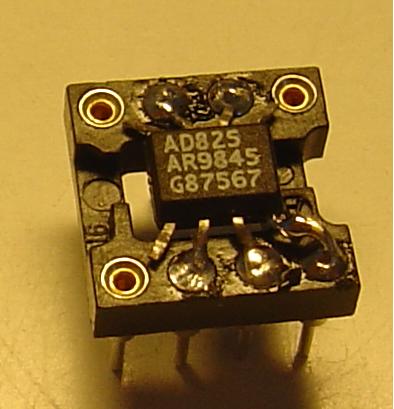

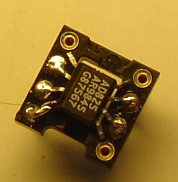

OK. Soldered four AD825 opamps in two hours :magnify:
CD960 has new opamps and play... Sound is good... :drink:
