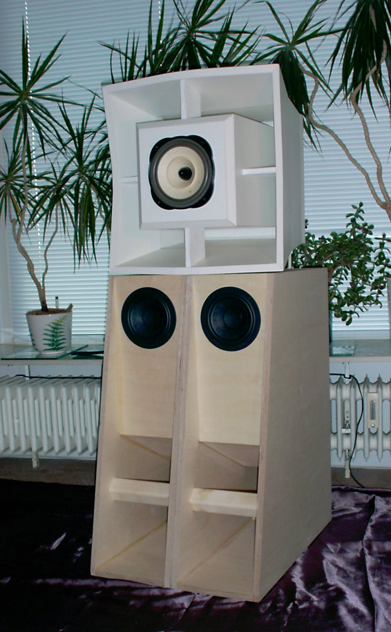

Hello,
look my sat horns:
Horn, Trumpet, Schalmei
and the double horns;
Saxophon, RDH 20, Posaune XL

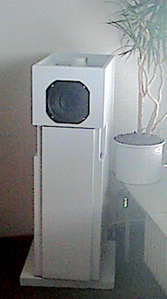

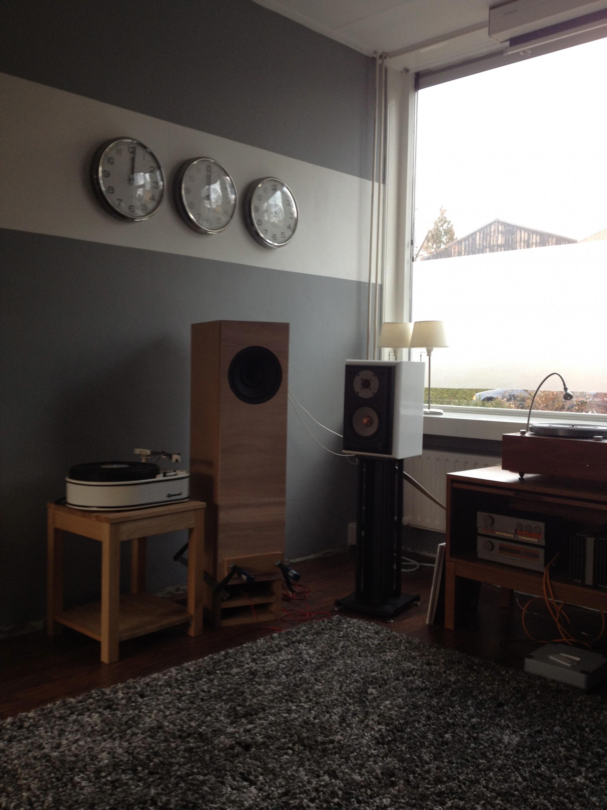

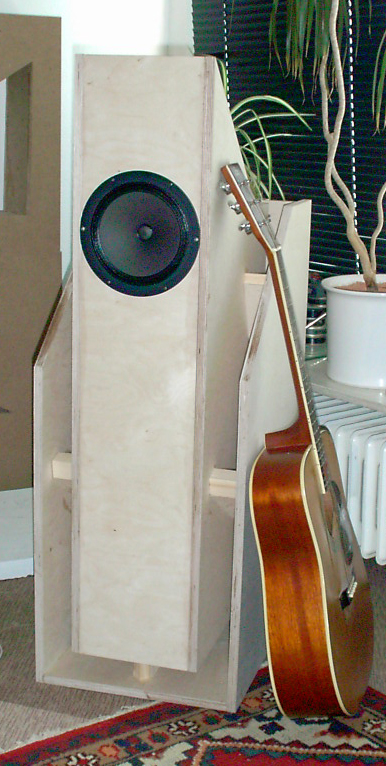

i build a TQWT with the 9710/M8 as driver and i just love it and it is just 26.4 (cm) wide.

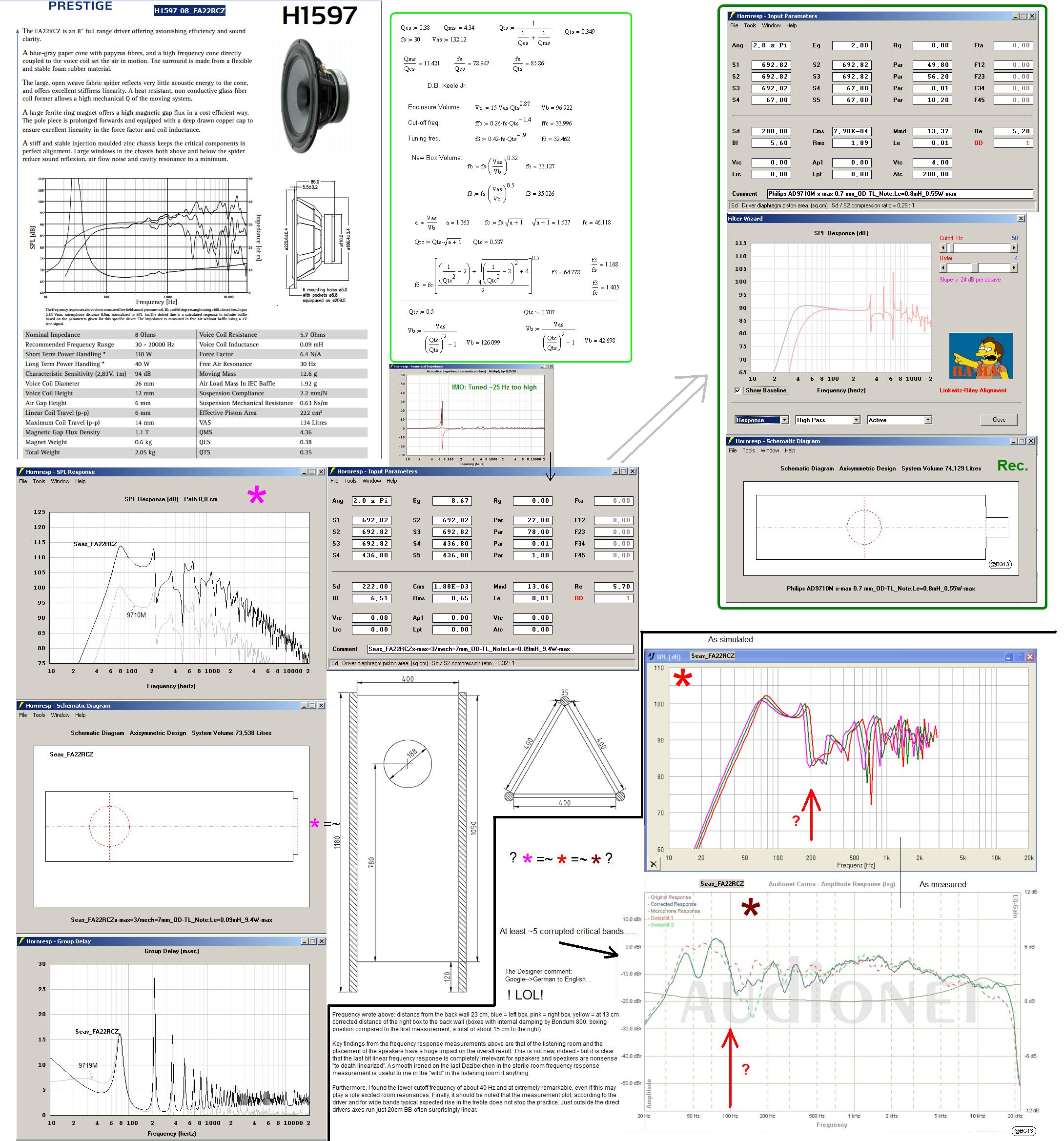

Hi Xerxes,
Your design is IMO the way to go,way better than the suggested 'German' box proposed here-above:
The design is IMO a Lemon Design...
Luckily the opinion what's an acceptable FR is very varied but if ignoring to present an acoustic load in the vicinity of fs is a method I never have encountered before..
I've used 9710M in more than 50 build since 1968 and all were survivors ...over time.:D
b :)

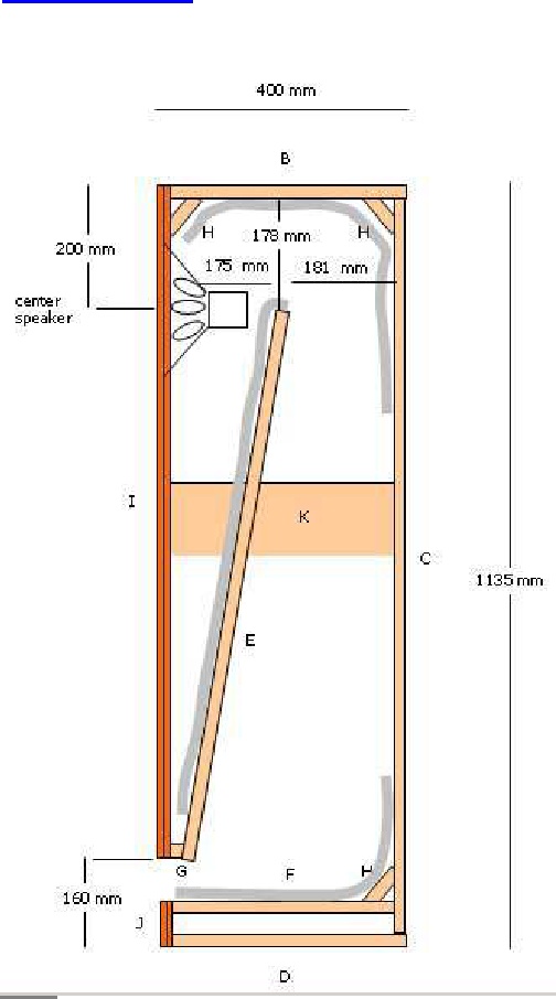

Well i wrote that i would sent a PM but maybe there are more people who want something like this. so in the attachment there is a quick drawing i made just now.
I filled the bottom with fine sand for stability and all the sides (except the baffle backside) with under carpet. There is no filter or BSC.
all the panels except the baffle are 22mm MDF the front is 24mm (or 2x12mm) plywood.

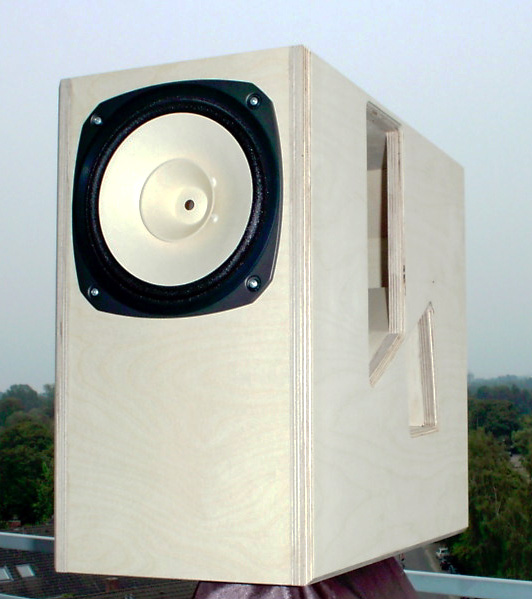

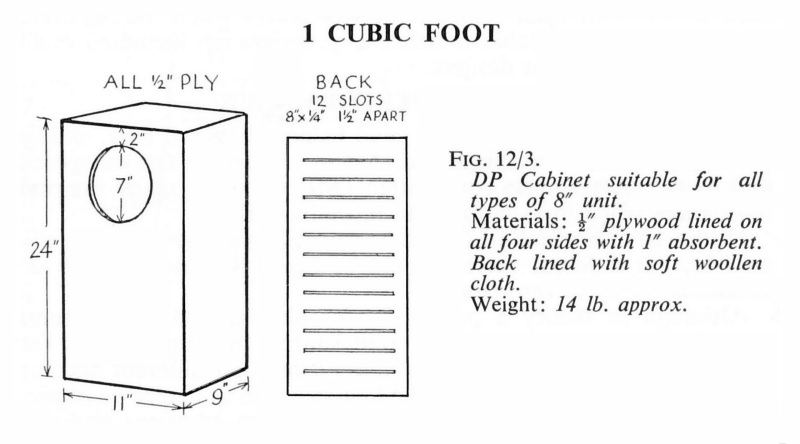

but if you are limited with space you could build a small Briggs cabinet (see attachment) this is simple, small and sounds great.
  • tqwt.pdf
