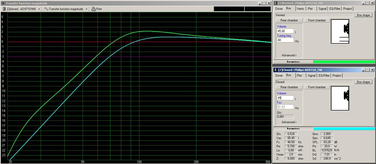

what about a box with following dimension:
W: 30cm
H: 50cm
D: 30cm
total volume would be ~45L :rolleyes:
what is the proper size of the port for this enclosure?
Here is the 45 liters box simulated as both vented to 40Hz (green) and sealed (blue).
attachment.php
May I suggest golden ratio dimensions of 22cm x 35.5cm x 57.5cm for this enclosure? It's better to avoide the two 30cm dimensions, at least in theory. :) I don't know what is easily available to you for making ports, but I'd go with a 3" ABS pipe, which would require 5.25" of lenght, or a 4" pipe that would then need to be 10.325" long.
