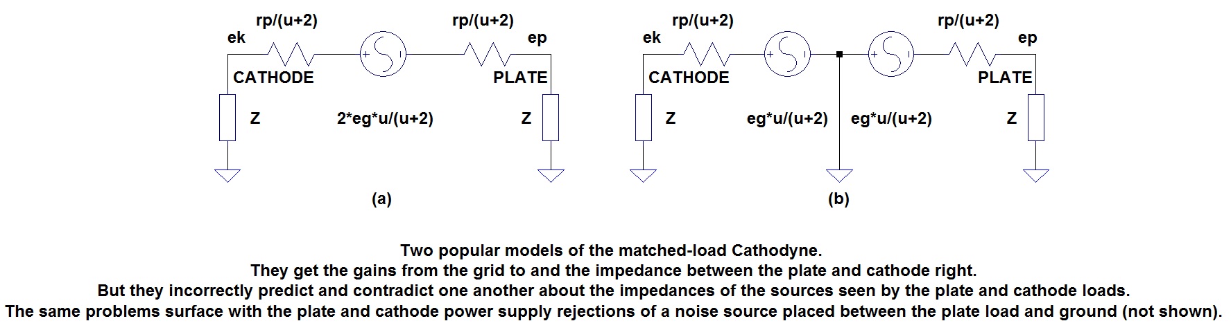

Those who retain an interest in this thread may wish to read “One Model to Rule Them All” in the March 2016 issue of audioxpress. This article presents a single “Unified Model” for predicting the gains, frequency responses, impedances and power supply rejections of three separate triode circuits: the voltage gain stage, the cathode follower, and the Cathodyne.
The Model’s derivation starts with the schematic of a triode with plate and cathode loads, grid bias and plate supply voltage. All component and parameter values at this stage are arbitrary. The triode is replaced with a small signal source using the parameters μ and rp. Kirchoff conservation of current equations are written at the plate and cathode, taking AC grid and power supply noise voltages into consideration. All DC signals are set to zero (courtesy of the Superposition Theorem), allowing us to concentrate on the AC audio signals. The equations are solved to produce one for the plate voltage and one for the cathode voltage. Each describes a circuit of its own: one from the point of view of the plate, and one from that of the cathode. Readily apparent with no further computations are the impedances rp + Zk•(μ+1) of the source driving and seen by the plate load Zp, and (Zp+rp)/(μ+1) of the source driving and seen by the cathode load Zk. These expressions can be evaluated by substituting parameter and component values from any particular circuit of interest, including a matched-load Cathodyne (MLC). For such a circuit, neither impedance is well-approximated by 1/gm. The complete equations and circuits are available in the article, along with confirmational bench test results and other discussions which relate to this long thread.
Those folks can rest easy who believe that the characteristics of an MLC cannot be determined by tests which disrupt that match. Nothing about the Model at any point connects anything to, removes anything from, or modifies the circuit being analyzed. However, it should be noted that the application of Thevenin in a manner which does disturb such a match yields exactly the same results as the Unified Model describes above.
A final section discusses the problems with the currently popular models of the MLC (see attached). For any matched load pairs that you might choose, the models give contradictory and incorrect predictions of the impedances of the sources seen by the plate and cathode loads. As confirmed by a straight forward bench test, the same problems occur with power supply noise rejections at the plate and cathode when a simple noise source is inserted between ground and the plate load.
I hope that the approach described here and in the article can serve as a step toward a resolution of The Great Cathodyne Impedance Debate.

Well, doesn't the output impedance on both sides of the cathodyne stay the same with no current being drawn? That's my understanding. Isn't that the main impediment for getting exactly inverse voltage out from upper and lower. Also, everything being equal with other types of phase splitter one gets 2x voltage out for the same input voltage into the cathodyne.
Actually I misspoke. The impedances are different according to Morgan Jones. (Just reviewed what he wrote). Rather, if there is no current drawn in either upper or lower loads then there will be no voltage drop across both upper and lower (different) impedances. So, it won't matter and the output voltages will be equal. I'm not confident that one can keep grid current out of conventional tube loads on max signals. That's why I argued for a source follower. Both together is my favorite combination for the previous reasons.
I am very interested to hear that Mr. Jones is saying that the impedances are different, a claim with which I agree. I am more familiar with his claims to the effect that they are both equal and about 1/gm. In what reference does he say that they are different, and what does he say that they are?
Identical cathode or source followers buffering each cathodyne output will render its differences in output impedances pretty much inconsequential. But it won't address a bigger problem I'd be happy to discuss after you advise what Mr. Jones has to say.
Technically, you are right about him saying it's 1/gm on both. But he's only saying it for the case of no current draw on either load. I'm cutting him some slack because if you agree with him, or you don't agree with him, the effect of having no current draw has the effect of making the impedances on both loads equal, in that there won't be voltage drops on either impedance. So in my case I don't really care.
In the case of the second condition, current draw on the loads, he's saying the cathode load impedances and the anode load impedances are quite different. That's what I was quoting and that's what I care about.

Thing is, it's easy to demonstrate that the impedances on both sides of the cathodyne are very different and very much unequal to 1/gm (even though the voltages are equal and opposite) even if no current is drawn by the output tubes from the cathodyne. This can be demonstrated simply.
So if it is your understanding that the impedances are equal if no current is drawn, I must disagree.
