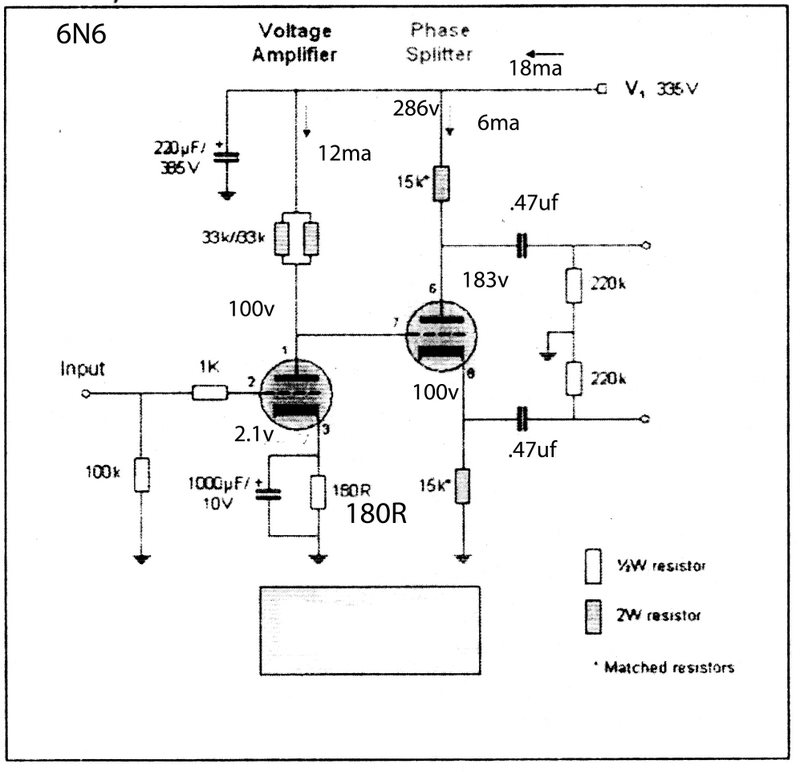

Would this Phase splitter work OK.
Phil
Probably, but its not quite optimally biased.
Prefer equal 1/3 rail voltage across each triode
when direct coupling. That shows 100V across
your first triode, and only 83V across the second.
Triodes really want slightly over 1/2 rail voltage
for best linearity and headroom. But then coupling
between them requires added parts, maybe a cap.
Could be worse than any theoretical improvement.
