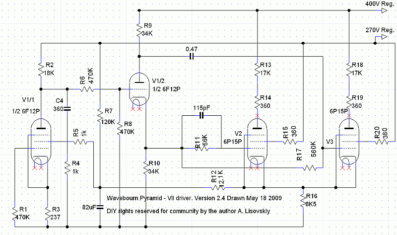

Because he is already limited by conditions to measure properties of Concertina phase splitter. Only and only when loads are equal it is concertina. If they are unequal it is an amplification stage with resistors in cathode and anode.
Edit: as I mentioned before, another term is Split-Load Phase Splitter. That means it is a Phase Splitter when load is split in half. If you add some load to anode, or cathode only, it is no more split in half. That means, your measurements are destructive, and can't be used to measure parameters that you alter by your measurements.

Hence in my 200W amp design I diverted from the traditional circuit design thoughts and instead designed around the normalised transient response analogy.
Yes I use a concertina. I like it but am aware that it really behaves as see-saw, that is unbalance one half output and the properties tip. One avoids the undesirable after-effects by Williamson buffering with a fixed voltage CCS in the common cathode and using low capacitance video pentodes (conf as a triode). That effectively wraps the main problems up.
The last problem is that the anode side of the concertina on a Bode plot shows a HF pole that drops steeper than the cathode side. As the anode isn't really part of the 100% concertina grid/cathode feedback structure and proof of this is to put two perfectly compensated x10 scope probes one on the anode and the other on cathode and pump through a fast square wave and compare. The anode side will show a slew compared to the cathode as tube capacitances begin to interact.
It's not uncommon to see oscillations esp on some high ft tubes when termination becomes misbalanced. The ECC88 will oscillate given the chance.

I more than insist, I use it in certain conditions, getting desired results: please see schematic attached to one of my previous posts.
Here it is, again:
