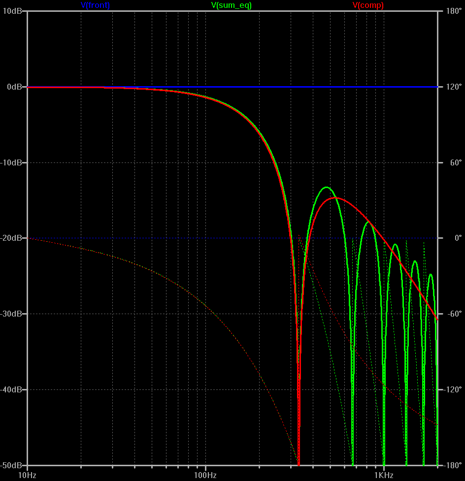

I did a simulation of Dave's scenario, using two point sources, 3ms delay and polarity flip, then EQd to flat with a pole at 1Hz.
This was compared to a mag and phase curve fitting done with minphase elements, 2nd order lowpass and notch. Actually group delay was used for fitting.
See plot #1 :
attachment.php
The close fitting of the curves up to the dipole notch is noticable. The dipole group delay settles in at 1.5ms, half the delay time.

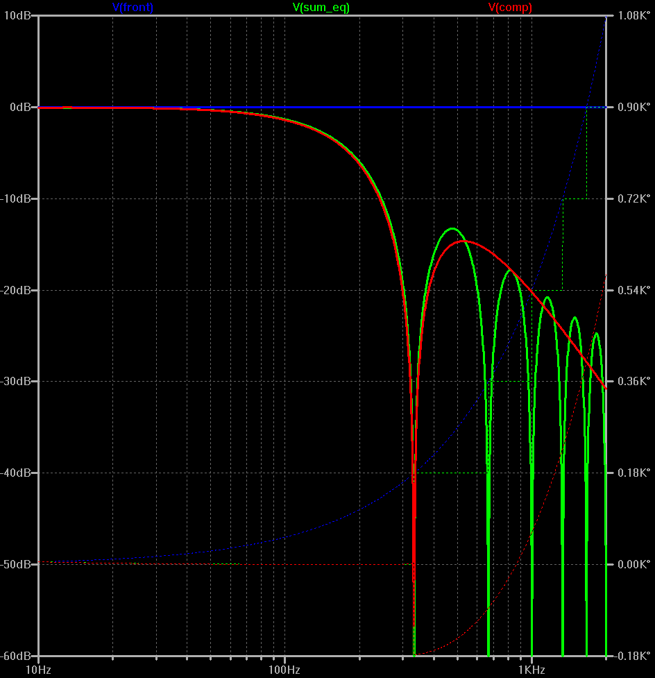

Same thing, with phase this time :
attachment.php
Note that the phase is plotted unwrapped. The "jumps" (discontinuities) are only 180°, not 360°

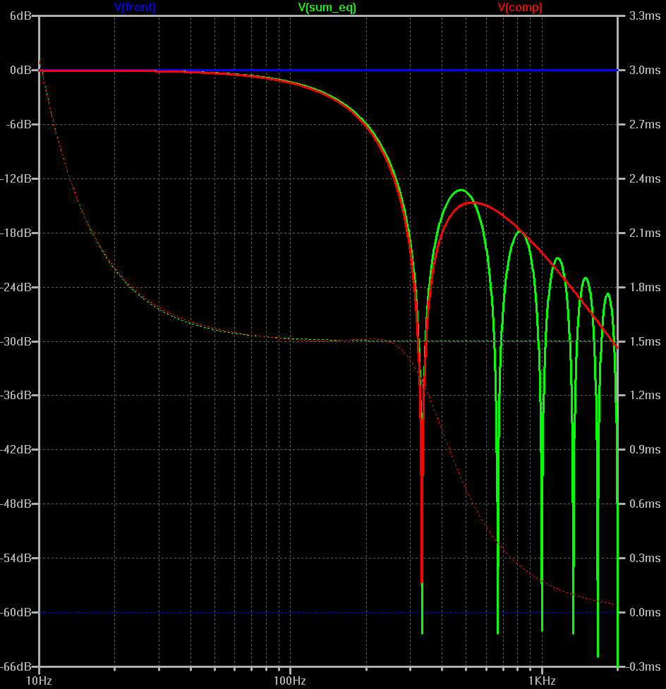

Now, the time reference was moved "midway in between" the sources :
attachment.php
This time we get an unwrapped phase "staircase" for the dipole, while the front source and the minphase model have unwrapped positiv phase rolloff, indicating negative delay. Wrapped phase would result in a "square" phase like seen on John's earlier plot.
(Group delay looks the same as above, only offset by 1.5ms.)
