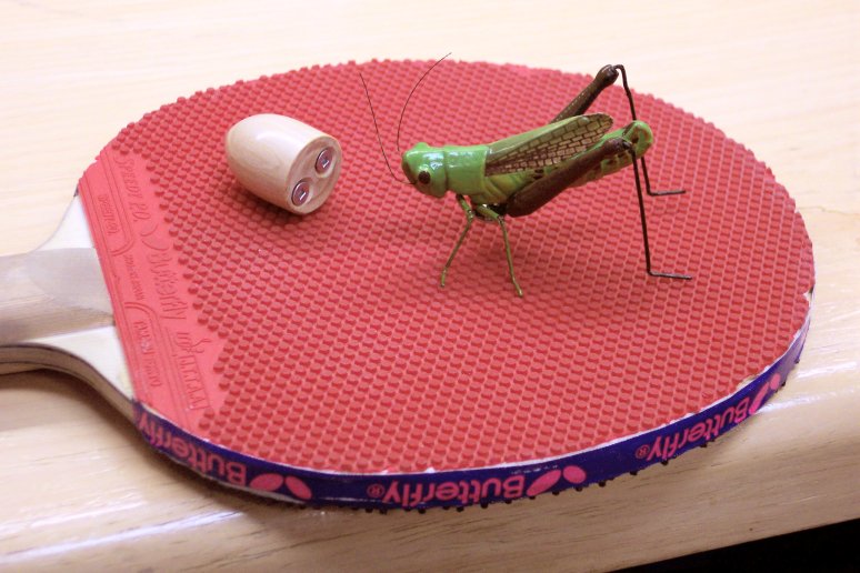

Ha ha ha. I just had to try it. I pulled the wooden phase plugs out of the FE107E's. I then pilfered from the company tool box two 9/16" sockets, which fit perfectly. Hey, they sound just fine. I'm not sure whether I'll be able to get them out or not. They really slammed in there, I'm here to tell you.

My first impression is that the metal may sound better than the wood (with metal screws). But I have not done a double blind or even a fast A/B. (It's hard to get those sockets out of there!) I *think* I may hear a reduction in high frequency raspiness. But we're talking very small differences now. At least the metal sockets didn't mess up the sound in any obvious way.

I set up an A/B test for the wood plugs and the metal plugs (socket wrench sockets) . I've decided I cannot tell the difference. I also cannot tell the difference betwee Husky and Craftsman sockets.
So the bottom line is that plugs definitely improved the sound of a couple of dammar-treated FE107E's, but it would take an ear more golden than mine to tell the difference between a metal socket and a wooden plug with a couple of metal screws in it.
The biggest difference seems to be how firmly they attach. I have to use pliars to remove the metal sockets.
