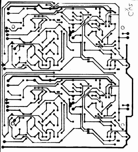

I am a PL model 700 fan and currently have 2 of these sweeties. I am looking for anyone that may have made a copy of the main pcb on these units as I have one in which I would love to replace the old beat up one with a new one. I read with great interest the rebuild of the Crown 300 amp but have not the experience to make copies of the original as did the gentlemen who did the fine rebuild on the Crown. Any suggestions/guidance would be most appreciated.

Hi Gibbi,
Take pictures and strip the parts out of the old board. Cut another to match and place the old board on top. Drill all the holes using the old one as a guide.
Now, clean the new PCB and "connect the dots" with a resist pen. Etch and you have a new PCB.
-Chris

Here you go for what its worth.
/Hugo

Hugo,
Nice job. That must have taken forever!
-Chris
Ok guys, now that I have the layout on paper, how do I tranfer that to the PCB? I've no experience with creating PCB's if you haven't gathered.
The draw on the PCB method I understand, but if I can use the layout it would seem that I could do a more professional looking job by transferring it the PCB.

Gibbi,
I honestly don't recall how I transferred that layout to PCB.
I think that a local electronics shop did the deed as a service to his customers. I gave them what I posted above and a week or so later I had the PCB. Had to drill the holes myself.
Now, again, be careful if you use my layout. I believe there is one small mistake but I have to open up the amp to find it. Also, this is not EE work but was fun to do in these days.
/Hugo
