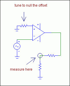

Well, this is the open loop response with the gain measured from Vout (since Vfb is of course very attenuated) and the phase at Vfb. There isn't much difference between my closed loop and open loop charts.
Ok... so this should be something like 95 deg phase margin right and stable right?
Danny
Danny

I think you misunderstood me. You should input the signal to
the feedack network and measure at the amplifier output.
This way you measure the so called loop gain and its phase
behaviour. The loop gain is the feedback gain (which is usually
less than one) multiplied by the amplifier gain. See the Intersil app. note that jackinnij linked to earlier in this thread and which
gives a rather good explanation on why this is what you should
measure.
You could in principle skip the feedback network and just
measure through the amp, but then you have to scale the
gain plot according to the feedback.

You are right Christer, in many cases opening of the loop will significantly alter the DC points. But this can be solved by putting the signal source at one and the resistor to ground at the other input; you should find the necessary impedances that will provide acceptable DC points. Or better, keep the zero impedance of the source, and find what input should have a higher impedance for zero offset and put and tune the resistor at that input (for most NPN input amps this means the source should go to the inverting and resistor to the non-inverting input – pic below shows this).
Results I had this way relate well to those I got using the method suggested by Intersil. Usage of it in SPICE is described here:
http://www.spectrum-soft.com/news/spring97/loopgain.shtm

The “problem” exists in the SwCAD as well as in the MicroCap. If you run V(x)/V AC analysis of the loopgain.asc file in the SwCAD (that Andy mentioned above) you will see exactly this. Vary the load (or feedback values) and both the phase and gain will be altered. Is this a real word event (hardly, I’d say), a pitfall of SPICE or problem with the measurement method?
Measuring the amp in the real open loop with the resistor at the other input for the offset trimming, I got the results almost undependable of the load. And yet, just as it should, gain usually starts to fail at some point (going with higher loads).

Calculating Gv = V(x)/V in the loopgain.asc isn't the same as calculating the loop gain. It's an approximation to the more complicated Middlebrook expression that's referred to in the comments of that file, which involves both Gi and Gv. If you plot the full Middlebrook expression per the comments in the example, it should give the expected results with variations of load. The approximate expression V(x)/V becomes exact only when the current in the voltage source V2 of the example is zero. Since it's in a low-impedance part of the circuit, it's a bad approximation in this case. Maybe a better place would be in series with the inverting input right at the op-amp.
So it's a problem with the measurement method I guess.
