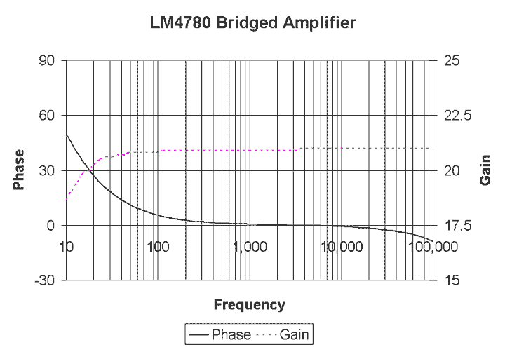

low F phase shift?
hi jackinnj and all
Is this thread covering also the low frequency phase accuracy?
I notice that this phase-gain plot indicate almost a 30 deg phase shift at 20 Hz...
jackinnj said:a real example -- phase-gain plot of the bridged LM4780 amplifier
hi jackinnj and all

Ah..... It is happening in low frequency too. Makes the problem more difficult nowIs this thread covering also the low frequency phase accuracy?
The curve have "S" shape. does all phase curve is like this? Always shift phase in lower and upper frequencies?

MikeB said:This phaseshift in low frequencies is caused by DC-couplingcaps.
Mike
yes but what should be the "best" compromise to select the low frequency pole to get a low phase shift but enough immunity to sub-audio frequency (cap for the feedback path) caused by large signal handling of amp?
Two solutions.
1] Remove the feedback cap and use pure DC coupling with optional DC servo for offset correction, and use a 30Hz high pass 24dB/octave filter using an opamp at input to get rid of subsonic frequencies.
2] Simply use the amplifier in Inverting mode and get rid of high value cap at feedback.
