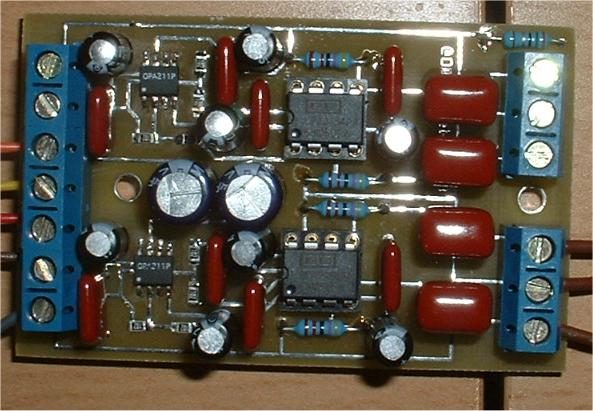

XLR to RCA converter
The OPA211 based XLR (balanced) to RCA (single ended) converter.
Shown below while evaluating with OPA2134 as buffers. Final implementation uses LM4562 input buffers. Chip resistors around the OPA211 are 1K 0.05%. Board is 2.8"x1.75" two layers. The bottom layer is almost entirely a (power) ground plane. All electrolytics and small film caps are power supply pins decouplings.
Sites will be updated with the full schematic/Gerbers/measurements/etc... ASAP.
