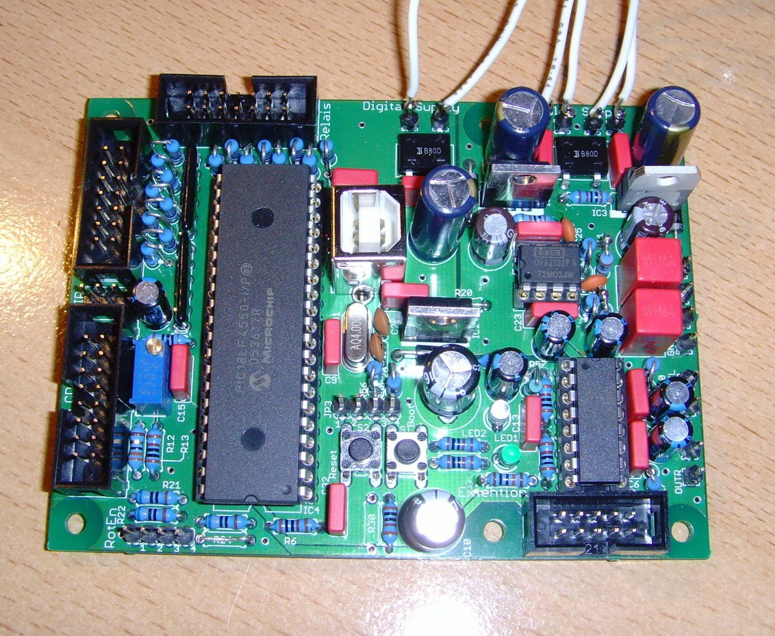

My PGA2311 - build did not show emotion, did hide most of the bass, sounded: dull!
I stepped back to the ALPS Velvet-Blue, then to LDR ,...
The PAG2311 chip is located on the bottom right side of the attached PCBs image.
Best regards - Rudi_Ratlos

I don't know, guys, everything sounds ands works great over here. I went over dozens of threads before taking on this project and found none of this type of criticism. Were these your own designs/software or were you working with someone else's?
In my experience the sound qualities are determined by the pre or post buffers. For example poor bass would likely be a bad input filter.The PGA231x is just a R2R ladder but it needs a good source and no DC on the input for the zero crossing circuitry to work.

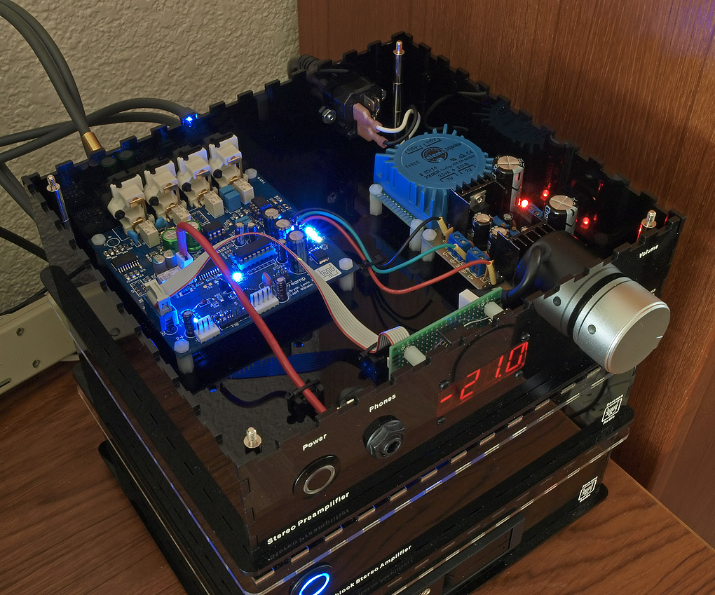

I did a layout with Linuxworks that he used or last years Burning Amp festival. It wasn't what I would consider a "high end" design with simple op amp buffers in a very compact design with onboard CPU, input switching ect. and it actually sounded and measured excellent. Nelson Pass used one of those preamps in his display as well. AMB Laboratories DIY Audio • View topic - TI PGA23xx solid state volume control chip support

This hasn't ever happened with me, after six years, so it is probably the control circuitry. It is no reason to blame the chip.
