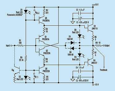

I have some OPA627 that I could use. Otherwise a simple buffer with bipolar transistors, or maybe the borbely jfet buffer based on the white cathode follower might be good. But the jfet buffer is probably not very good driving low impedance loads.

I have been using an OPA-627 (with a four transistor unity gain buffer INSIDE the feedback loop) in my amp for years and years. There might be better and cheaper op amps by now. I believe the AD797 (of the "old" league) might be a better choice here because
a) being a bipolar cascoded device, it might have even less common mode distortion
b) you'd be driving it from near zero virtual impedance, so its excessive current noise does not hurt
All in all, DAC op amps have to work much harder because of all the HF junk, so selection is much more critical there than for a volume control buffer.
The problem with the PGA is that you have no access to the feedback loop. So if you use any of these buffers which have no overall feedback loop, you have the worst of both worlds, i.e. a mediocre opamp with low open loop bandwidth and lots of feedback and a "no-feedback" buffer which has considerable residual distortion. This is going to satify neither school of thought...

Well.. One alternative is to forget about the PGA2310 and get an LM1972 instead. The LM1972 have no internal opamp, and should have a buffer at the output. Or run the PGA2310 without external buffer.
However, why can't I place an as you call "no-feedback" buffer after the PGA2310 if the buffer itself has low distorsion without feedback? I have seen some designs that have the outputstage (buffer) outside the feedback loop.

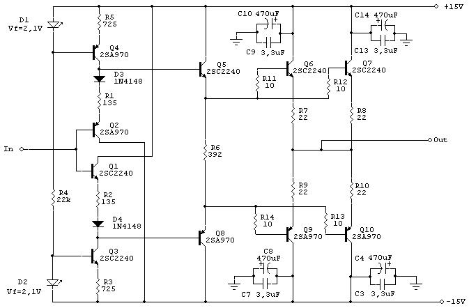

But it would be very simple to make an active attenuator with high perfomance swithes and a discrete I/V converter with no feedback and a discrete buffer.... should be very easy to get sub -80dB THD.... When done right...
:devily: the sims shows it... just have to find some time to do real life tests....
just wanted to post some FFT but even in zip-file the size is 170K
so i am only going mention the results
at 1KHz :
350mVrms - 2nd : -105dB - 3rd : -150dB
700mVrms - 2nd : -100dB - 3rd : -135dB
2.000Vrms - 2nd : -90dB - 3rd : -120dB - 4th : -150dB
IMD 19k+20k 350mVrms each :
all other components is 100dB below 19k+20k.
so total IMD is like ~ -92dB..
This is a discrete I/V without feedback.... and without the buffer...
so if you can live with that you can use a discrete No global feedback I/V or add a buffer and make the VAS node high impedance add a 33pF cap to the node and add a feedback resistor... and there you go... :nod:
