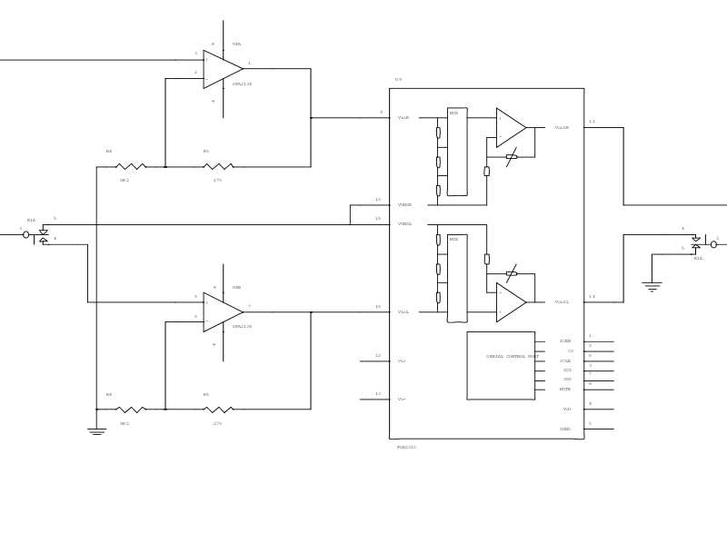

PGA2310 in balanced config?
I was wondering if anyone has run the PGA2310 volume chip in a balanced configuration? I would like to use a relay to switch one part of the source (either the ground or the negative source in a balanced input) to ground in the case of the unbalanced input or to the second input on the PGA2310 for a balanced input - same with the output. I do not have any balanced components to test this myself but want to be able to switch each input to balanced/unbalanced.
I hope this makes sense.
Thanks for the replies - I think I will go ahead and wire it up this way and try to borrow a balanced source to test it later. Devil_H@ck, I do have a relay to switch the second leg of the source to either the 2nd input on the chip or to ground to allow a per-source selection of balanced/non-balanced.
