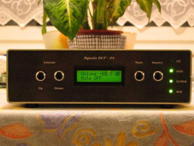

After 3 month I've finished my PGA2310 based preamp. Some technical data :
Digital part :
- PIC 16F628 running at 4MHz for volume and mute control and driving LCD display
- PIC 12F675 running at 1MHz for input selector
- 16x2 LCD with backlite
- PGA 2310
Analog part is based on the schematic from
This page . The only difference is that I used OPA2134 for input and output buffer.
Here is the front view

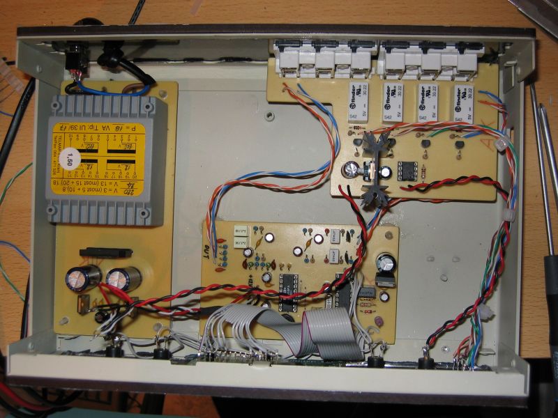

Hi bostjancek,
Good job, looks good.
One thing: those unshielded cables should not be close to each other, it creates crosstalk.
Most critical I see there is the output cables, separate them widely, or use shielded cables there, they are also close to the PSU.
The input buffer could left out, or just buffering the tape outputs.
To Nordic - the Led which is not ON shows the input which is active. Yes I know is strange but this is caused because of the relais which are normaly closed (I have it - so I used them). This setup is only temporary. In the future I plan to use a Burr-Brown MPC508 which are 8 channel single ended analog multiplexer (I've got samples ;) ).
Cheers
To carlosfm - the unshielded cables (twisted pair from CAT-5 cable) which are close together are used for leds in front pannel and for buttons. The twisted pairs for input and output - I'm planning to change them with shielded cable as soon I will make a new input selector with MPC508. I'm also planning to change the main board because I will use just 1 PIC micro (16F76 which have 28 pins) for all digital controls. I will also add the support for RC5 IR remote control.
