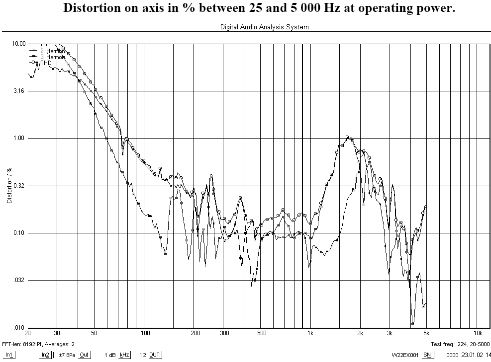

Ok I understand now. You are changing from 4 x L22RNX4P to 2 x W22EX001 + subwoofer
I think that's a good idea. Music may be ok, but for home theatre the W22EX001 would benefit from assistance below 100Hz. For real HT entertainment we could all do with large high excursion woofers :D .
Linkwitz supplements with 2x W22EX01 with a quad of 10" XLS woofers in his Orion, for music. Then for home theatre he calls for additional 12" monopole subwoofer(s).
Let's make it clear that without a subwoofer, in the bass department, 2 x W22EX001 will not be better than 4 x L22RNX4P. The quad of L22RNX4P have higher volume displacement by a factor of 2.8 times, as well as a slight sensitivity advantage. This means both lower non-linear distortion levels and greater SPL in the bass.
W22EX001 distortion attached:
I'll be using subs with music too, without I'd expect that dynamics would be limited and too much pressure would be on that single 8". Best to use stereo subs and keep the rest of the range focused on low distortion.
There's absolutely no question about the subs being included, I've redesigned the whole thing around the need for more bass, lower distortion and extra lower mid range clarity. The W22 will be more than enough from 80hz up to the cross to the ATC.
I'd agree that without the sub things would look pretty poor bass wise though. Afterall 2 x 8" were weak and still unsuitable for HT, so subs would have been mandatory with those too.
The effort I've gone to this time around with regards to a clean lower mid range & bass is quite extensive:
The cabinet which houses the Excel bass driver has 18mm + 9mm MDF walls and the top and bottom walls are 36mm thick. Also rather than using large panels I've subdivided the largest sections to keep panel size down in order to minimise resonances. Along with this there's also some of the most extensive bracing I've done.
Another considered effort was that there are no parallel walls to keep standing waves to a minimum.
I've also double up on dedshete panels and have fitted an Auralex 4" Wedge directly on the wall behind the driver to absorb and difuse some of the back wave. The baffle for the W22 is also 3" thick with a magnet brace .
This kind of construction requires a fair amount of effort but the results speak for themselves - the knuckle test on a nearly finished cabinet shows them to be very sturdy with virtually no resonances. This is clearly a very good foundation to hear the best from the W22 without colouration, the next step would have to be something like aluminium, concrete etc.
W22EX001 distortion attached: [/B]
Thanks for that, the THD numbers from 80hz to 400hz(the range I plan to use) look excellent. They are less than 1% at 80hz and around 0.1% - 0.3% throughout the rest of the range. Those are enviable THD figures by anyones standards.
