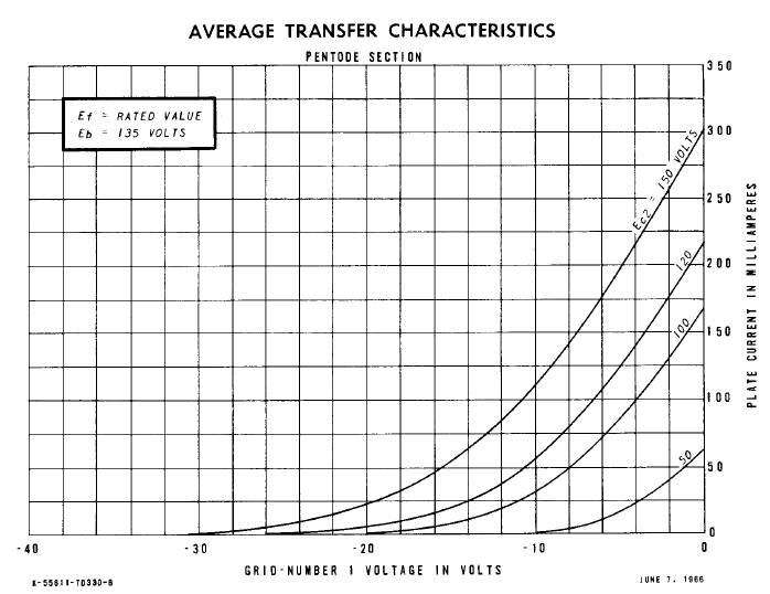

The data usually comes from the datasheet, but sometimes, the data comes from traced curves from actual tubes, the formulas then try to describe in mathematical terms how to best describe the tubes' properties (not always successful though).
You are being too modest, you are not a beginner :D uramp(x) = x if x > 0, else 0. I'm not sure if SIMetrix uses it though, in any case, the Ayumi pctube library contains all the models in SIMetrix .MOD format, so you can use them directly.
That's actually the hardest part - around the knees, as shown by Robert in this post.

Unfortunately, the tubes datasheets sometime give very few specifications and it is impossible then to make very accurate models, specially for pentode. Sometime, the model are made for a specific screen grid voltage and their current is not correctly modeling, when the plate voltage is under 100V, the screen grid current suppose to raise very high but in most model, this current is linear for any plate voltage.

Last week, I decide to find out by myself how to design pentode models because I am not satisfied by most of those I have in my library. Particularly, their knees don't fit very well the datasheet curves and the current model of the control and screen grids are not accurate. A good pentode model should permit to simulate a screen grid drive amplifier with an appropriate driver or a triode connected pentode ...
I was first thinking some conditionals functions can be used to reproduce the complex curves of a pentode and I made many test with them, some work nice except at the point of transition of the condition. The link between two part of the curve was not smooth.
Then I decide to test every maths function working in my SiMetrix simulator to see what kind of curves I can get with them and here's they are :

Now, it is time for me to tell you about my first pentode model experiment. I read in this thread the hard part is modeling the knees, so that's where I start and the mathematical operations I develop will be the base of all my pentode modeling tasks.
I create a special device with 8 pins that can be use to pass any argument to the models I am working on and believe me, this is perfect for "fine tuning" jobs. We often said in Quebec "an image worth thousand words" so here's the image :
You understand the voltage of every battery are the argument I pass to the model. For my first tests, I use the 6L6GC because there is a lot of documentation available for this tube, in the GE datasheet, there is ten useful curves graph for plate, control and screen grids currents.
For my first experiment, I choice the necessary argument to make a very accurate curve for a control grid voltage of +24V and a screen grid voltage of 400V. I adjust the curve to get the following IAK/VAK target points :
70 ma for 20V, 250ma for 50V, 530ma for 100V, 600 ma for 135V (in the middle of the knee), 630ma for 200V, 650ma for 400V and 670ma for 700V.
After I finish adjusting all the parameters, I measure the GE graph with a very handy on screen measuring application named "ScreenMeasure.exe" ... and I get 670 x 470 pixels. Then I adjust the zoom and the X,Y ratio of the curve made by my SiMetrix simulator to get the same size and I copy the window image using the "Alt PrintScreen" short keys. I open "MS Paint" with the GE graph image I get the same way from the PDF file, making the background transparent, and I paste (Ctrl V) the SiMetrix curve on top of the GE curves to see how well they fit ...
How about that ! :D
The curves are fitting almost perfectly at every points.
Of course, I am still far from a complete pentode model but I think this is a very good beginning. I have hard time to find how to position the knee in the X axis and adjusting is sharpness, also how to make a slightly curved slope after the knee. The next step will be making the curves for any value of control and screen grids voltages and this will also not be easy ... but I like this kind of challenge.
