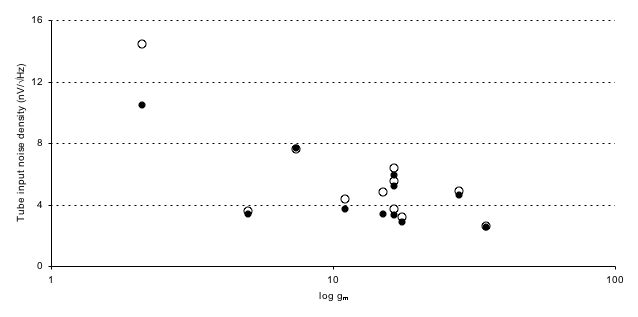

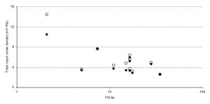

For interest, here is a scatterplot of equivalent input noise voltages for Frank Blohbaum’s sample of pentodes (on the Y axis) against the log of the datasheet gm. The open circles are for the pentode, the dark dots are for BestPentode. For this chart, I estimated output noise voltage from all other sources at 15μV to derive an estimate for the pentode alone. It would be better to have actual excess noise and gm for each measurement.
While the correlation is not sublime, the data indicate that noise falls for higher gm pentodes. The partition-noise estimates followed a similar pattern, as did the triode estimates.
