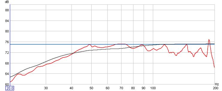

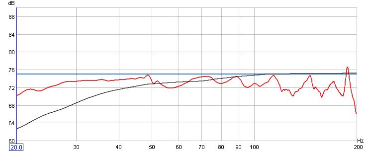

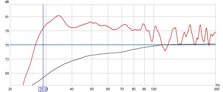

Here you can see some measurements I have done in my home cinema.
The first is one 830500 + 2x 830548 (425gr each) in a 49L box
The second is one 830500 in 45L closed box
And the third is the same as no two, with +6dB "bassboost"

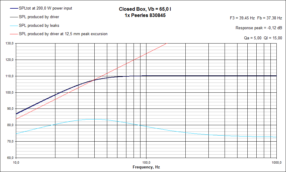

In fact I have two 830845 borrowed from a friend, but they need a large enclosure (80 to 90l) due to its high Qts. I was thinking in something a little bit smaller...

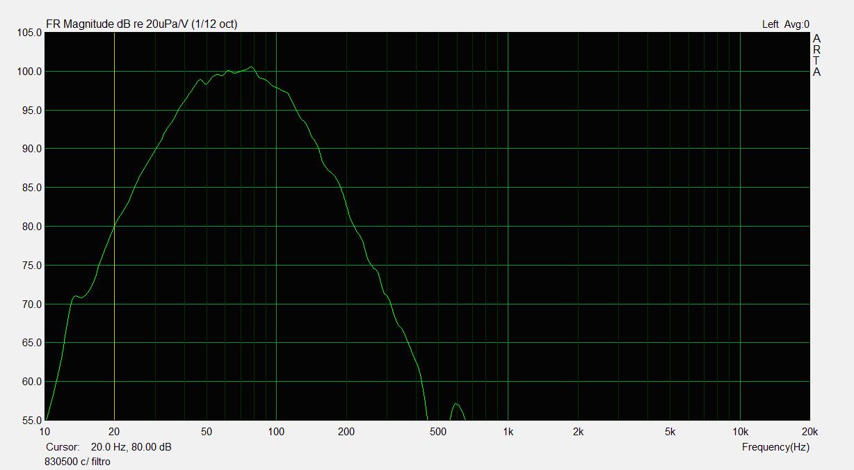

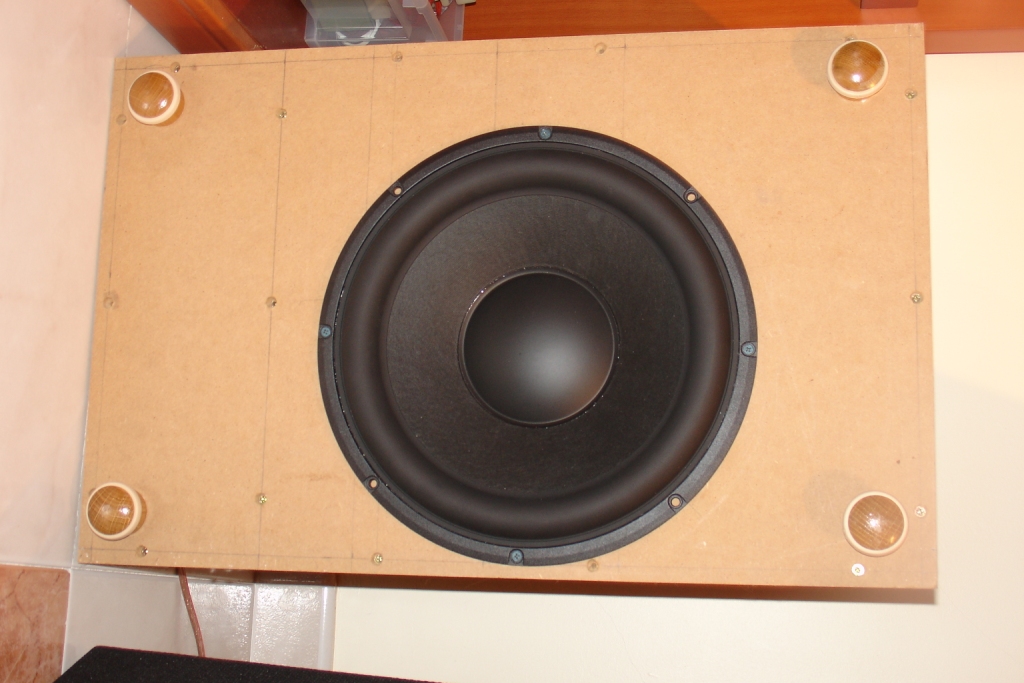

Here you have the test box, simulation and measurements for the 830845!
The measured response is near field (in front of dustcap) and with low-pass active filter.
