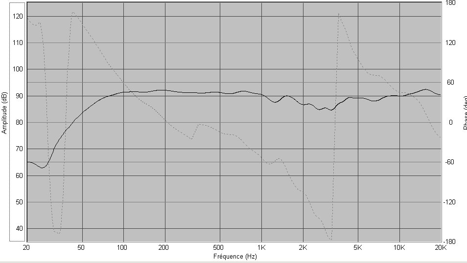

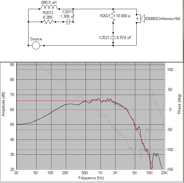

Hi Peter,
I've done few simulation for the high pass of the Nomex, you can have a look on my blog :

Hi Peter,
Any news from your tests ?
On my side i've add a 12" sub connected via high level lines of the plate amp and crossed around 50 hz (not measured yes).
Ouhah ! Very very nice result !

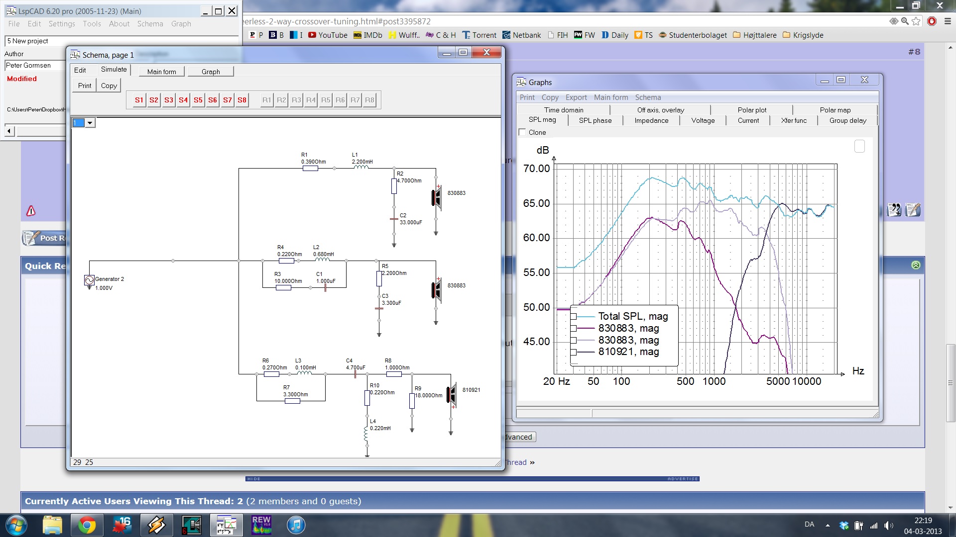

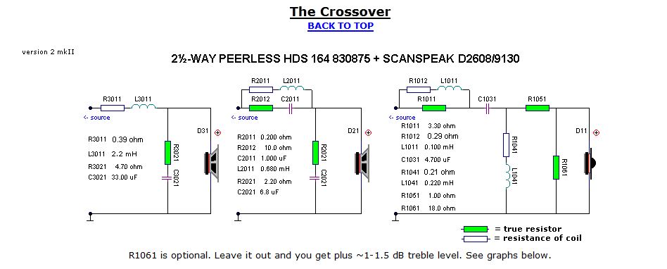

Hey Pascal! Must admit that I haven't tried it yet :/ First I'm going to change the Zobel capacitor to 3.3 and see it that has any effect, and also try 1/18 ohm L-pad while I'm at it. I tried comparing the slopes of my midwoofer to a 3.3 kHz LR4th order, and it actually seems to match rather well (see the pictures). (This is with the crossover completely as Troels') When I change the value to 3.3 uF I get something not really close to LR4, but it might just be what I need since it raises the output at 3.6 kHz some 4-5 dB.
