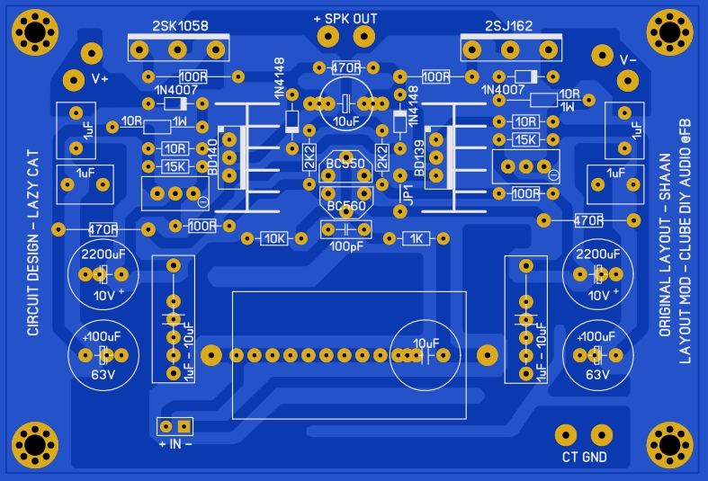

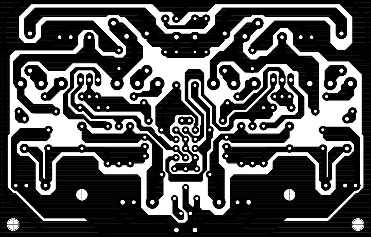

The speakers just for fun :D has build it long time ago
So here the PDF but no value cos I don't have it :cool:
please send me PM if someone want the .dip file(I use diptrace)
board size : 100mm x 64mm
I need someone that build it too :);)

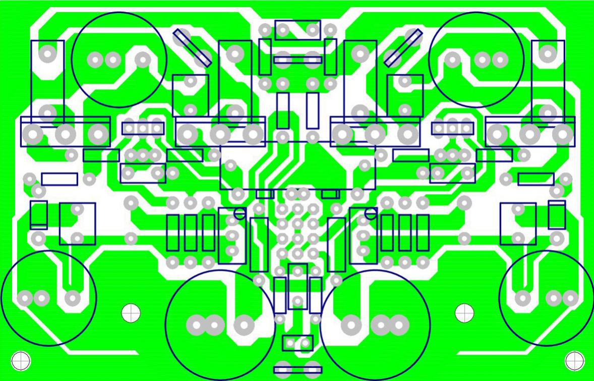

last version
Here the latest version, some tweaks and fixes. The spaces are great for those who want to use polypropylene capacitors, but can also be used small electrolytic capacitors.

Hi efragnani.
Nice design.
If you want to use this thread for posting your progress then please don't post any layout with parallel capacitors in feedback network/resistive bias/CCS in the circuit. You can modify the rest of the circuit in any way you want.
Please read the first post thoroughly, specially the 'Important' marked paragraph, before posting future designs.

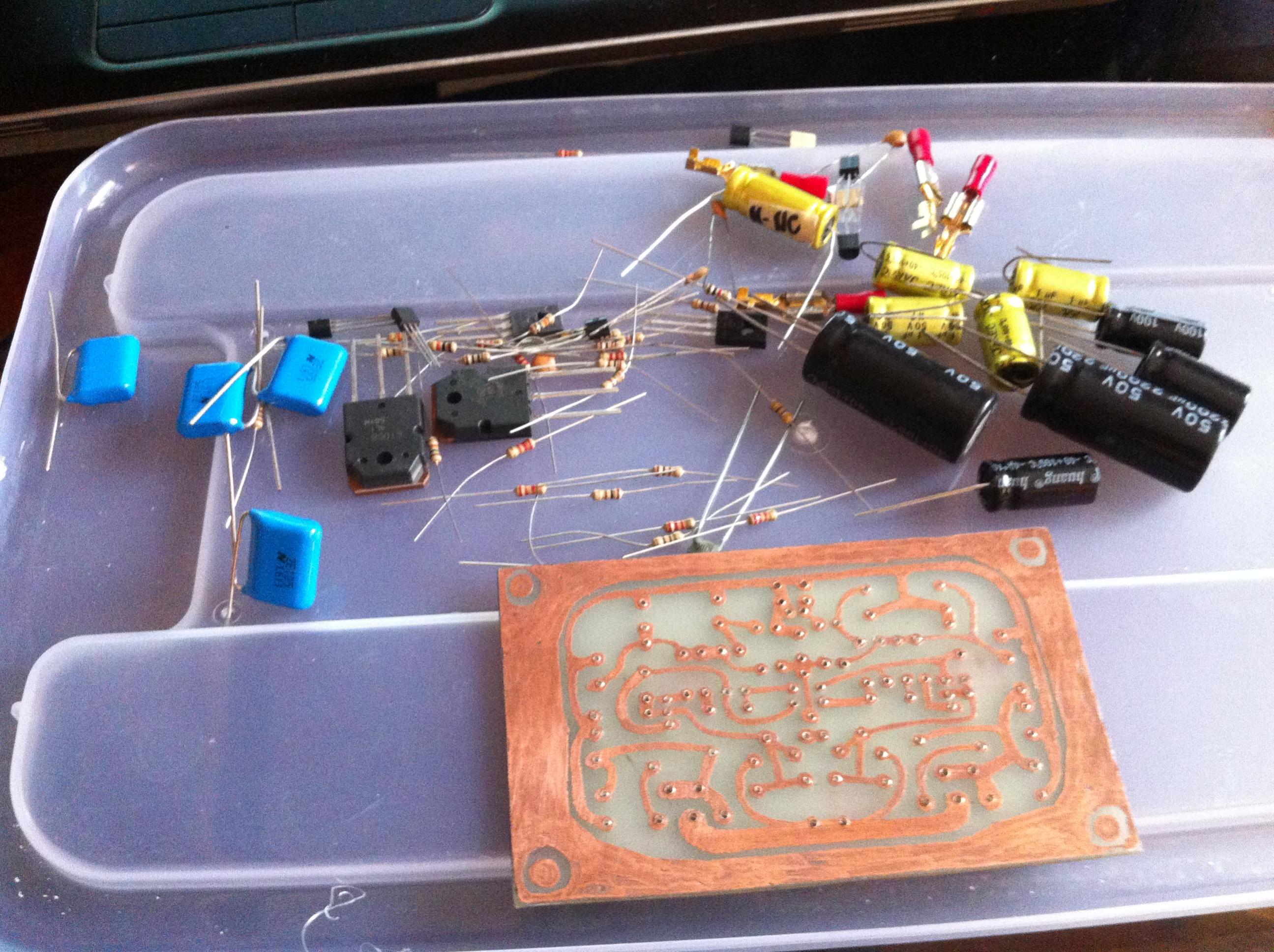

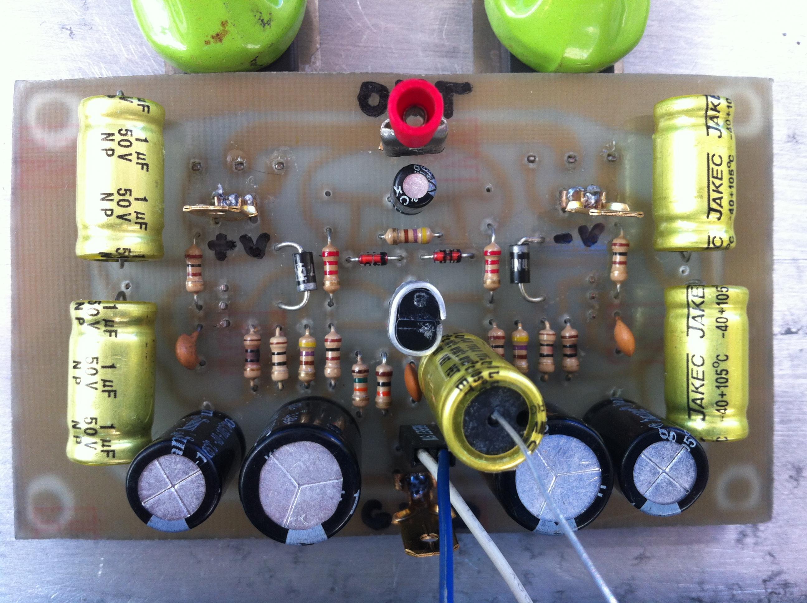

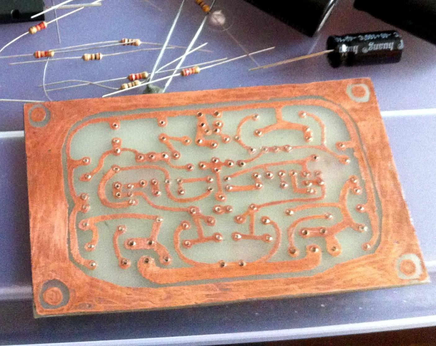

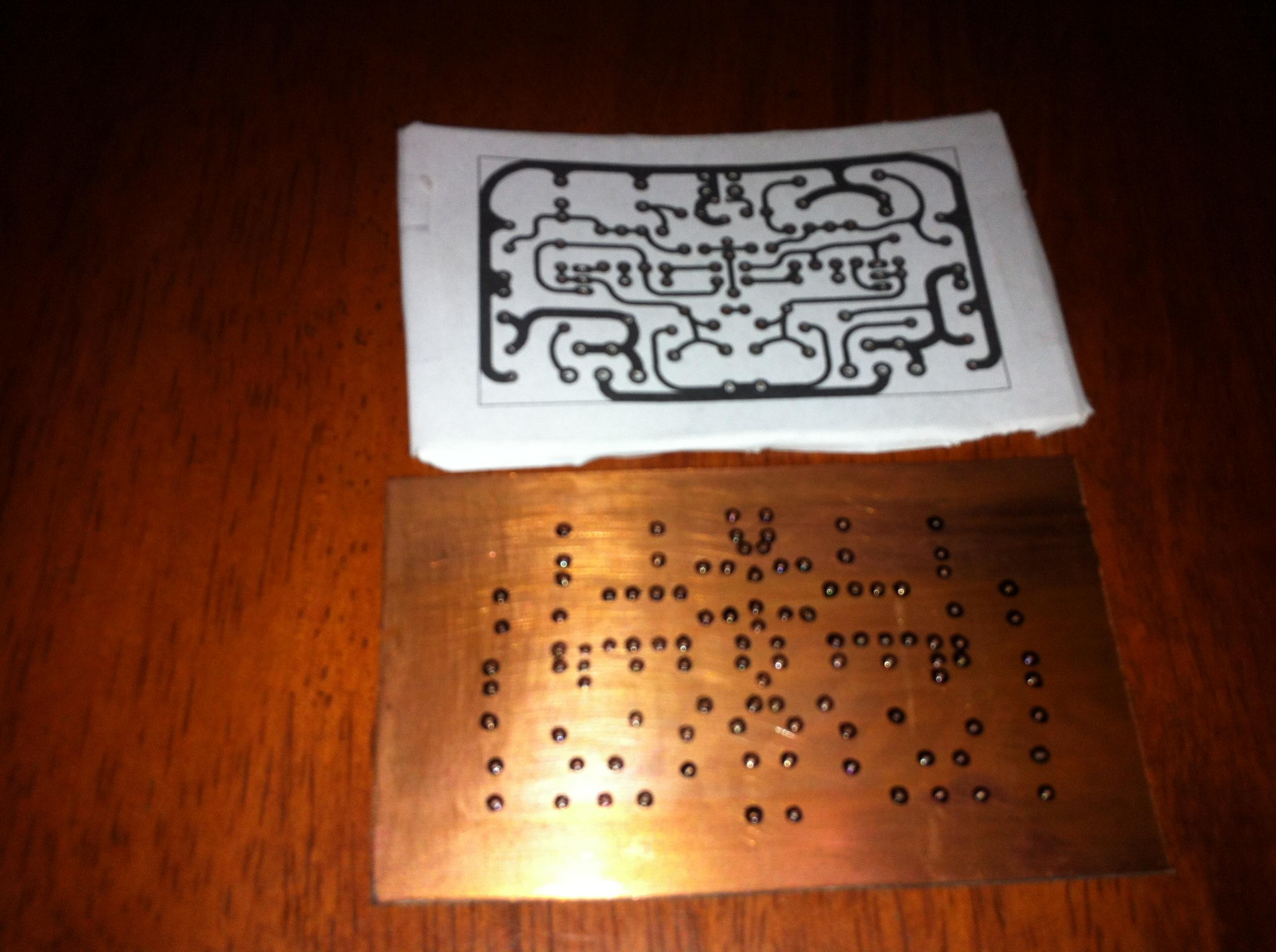

PeeCeeBee ala John Bali style
Built PeeCeeBee using John Bali PCB layout.
Parts used:
BC547B/BC557B because BC560C was not available (I think this product was discontinued and replaced by BC556C?)
all 1uF caps, input cap were all non-polar caps (JakeC brand)
all resistors were regular carbon resistors
rail DC was +/-25V.
first on, i burned 10R resistor while the other 10R became 6.6R:mad: found the problem. cause was swapped input transistors.
second on, output DC was somewhat unstable, so i put VAS compensation caps of 24pF.
third on, offset DC was high at 82mV. i tried to parallel 15k with 150k, offset DC became -82mV. i tried another value 330k, and the offset was 2 mV. :)
satisfied with above and was pretty stable.
sound was clean and loud. i liked the bass, mid, and high and suited my taste.:)

Built PeeCeeBee using John Bali PCB layout.....satisfied with above and was pretty stable......sound was clean and loud. i liked the bass, mid, and high and suited my taste.:)
Hi jaagut. :wave:
Congrats! Nice build.:cool:
We will be delighted to have a detailed review on the sonics of your boards. Especially because carbon resistors are used throughout the board and low noise input transistors weren't used. How good the soundstage is with a stereo setup is one of the most important points and also the reason why one amp sounds better than another. Have you compared its sound with other amps yet? What do you feel different/better or different/worse(if any) with PeeCeeBee?
Sorry for so many Qs. ;):D;):p
Please give it a good week-long listen and kindly report afterwards.
Thanks.
shaan
