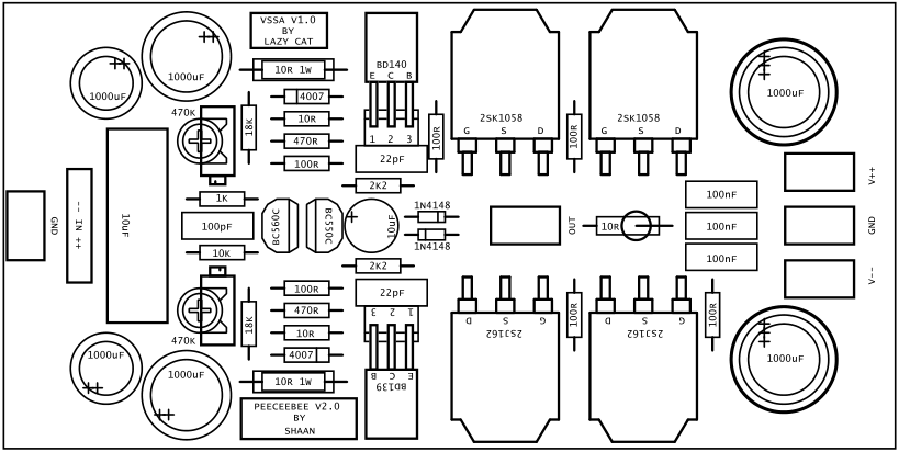

And here is the corrected Silkscreen for PEECEEBEE V2.
  • PCB-V2-SILKSCREEN-REPAIRED.pdf
Oops,My bad!
Btw ,why do we have such huge capacitors for feedbacks?
Coz the gain setting resistor is such low; 100ohms only. Plus better ripple filtering of the input bias current from the PS rails.
What are we feeding
Emitters of the input transistors. Symmetrical AC feedback signal from the output.
I couldn't find the schematics for it yet-new arrival.
Apologies, if I am going OT.
Check the first post. There is the schematic. :up:

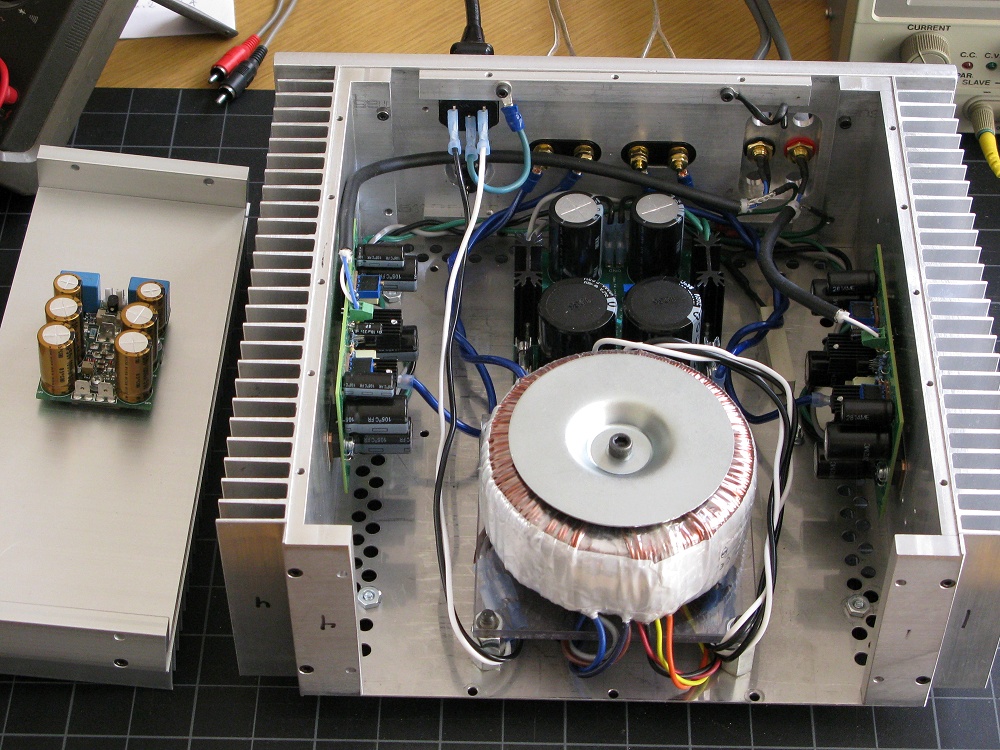

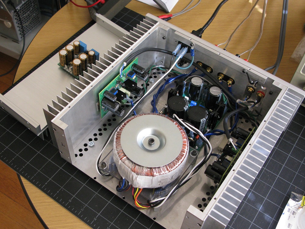

The pics below show my most recent test configuration, with LazyCat's original SMD VSSA module on the left of the PeeCeeBee Chassis, for comparison.

Very nice build PMI!
