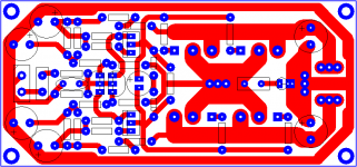

Double-Output PeeCeeBee Draft

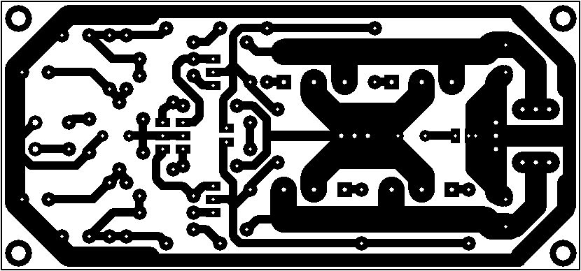

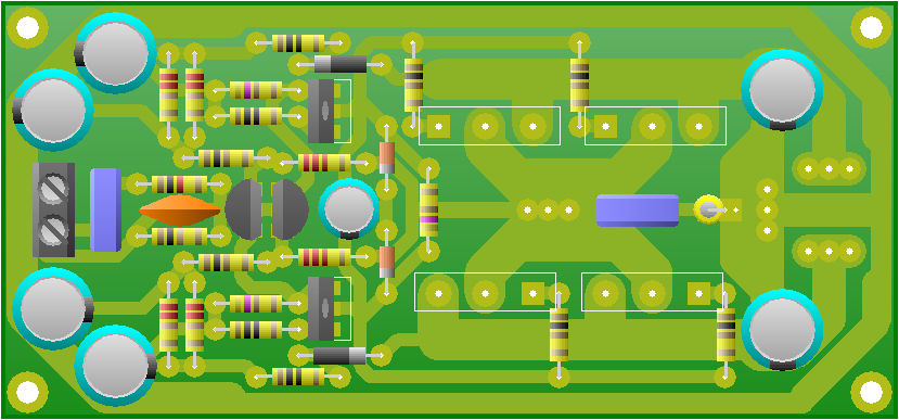

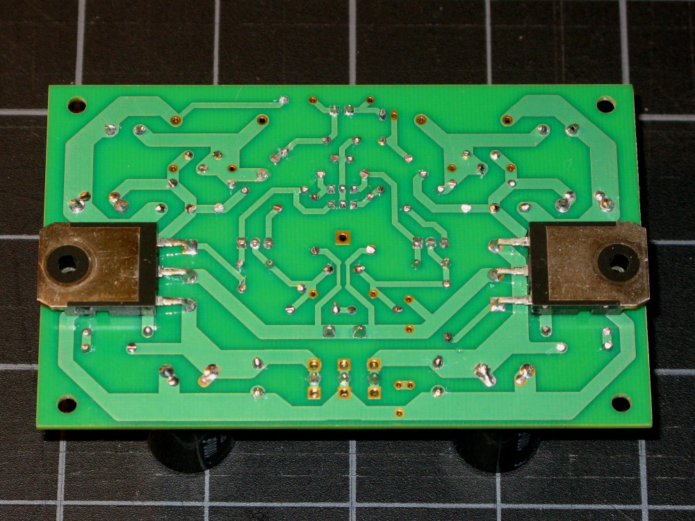

This is my plan...
Dimension: 4.3" x 2"
Please comment.
Thanks.
shaan
edit: Underboard FET mount. ;)

I like it very much. Nice and compact and I like the power connections together like you have done.

Shaan, please ada optional compesation cap. on vas incase somebody want to use ksa/ksc/sa/sc transistor.
Okay. :)

Shaan what is , other than price and availability, choosing 2 // latfet per rail than a double die as ALFET ALF16N16W with background off place saving and no matching needed?
Marc
Better dissipation, more space between FET leads, ease of drawing amateur layouts, peace of mind etc. You know, we average diy-ers often make bad thermal coupling and demand most from the least. Makes us different. ;) :D

It seems that the Exicons are a slightly different package/pin spacing than the Renesas parts. I am planning to make a small revision of my circuit board, and I was hoping to accomodate that package, but there is another small issue. As far as I know, those parts do not have internal protection diodes, so those should probably be added to any layout.
I believe that those parts, just like the Alfets, are intended to be used with a faster pair of drivers (at least the Profusion web site seems to suggest that), so I think that would also mean compensation resistors, and carefully chosen gate resistor values. I have done some of that on my board already, but it seems not to be necessary if one is to follow Shaan's schematic and logic in chosing parts.

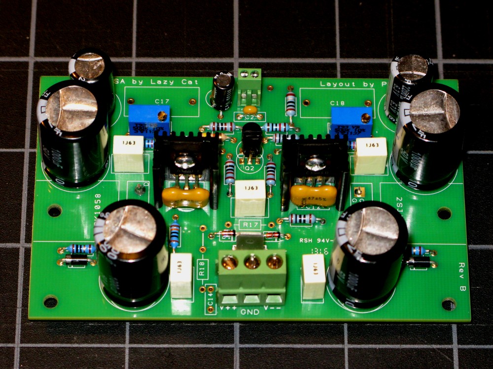

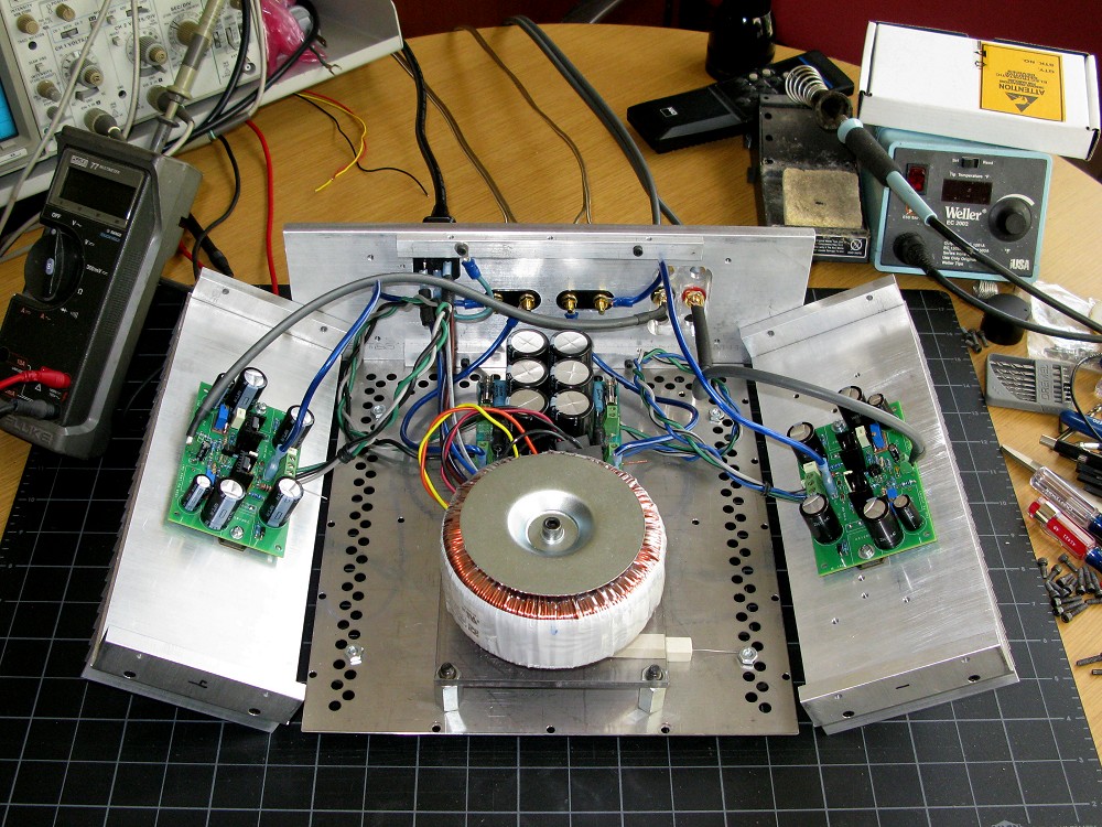

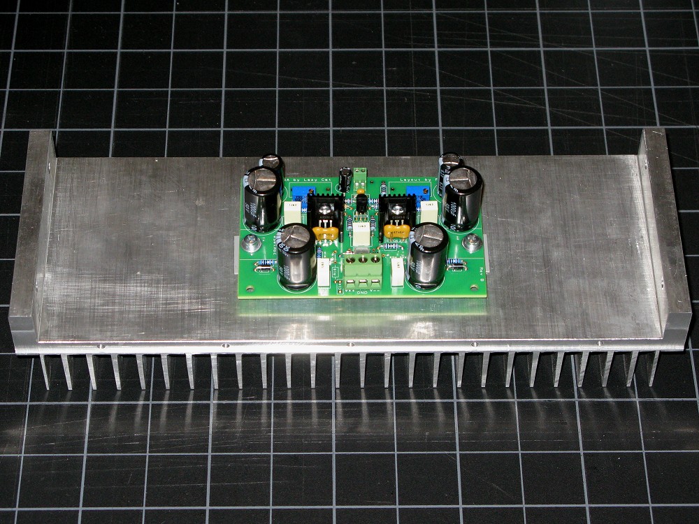

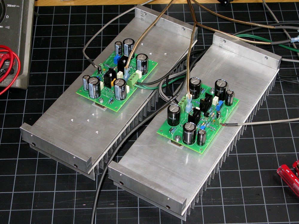

Hey! I may have made bad thermal coupling decisions in the past (well, I am pretty sure of it), but I am "in recovery" now. ...and btw, I am quite proud of my 12-dollar heatsinks. I'll be a bit sad when I finally have them anodized, it will spoil the industrial look... ;)
I would also say that even though I have made a few changes to my test board set over the last few weeks, the version I listen to almost every day is pretty close to the original schematic published here, and with a smaller heatsink than the one shown below.
I plan to use the same heatsink, 0.65C/Watt with the VSSA modules from Lazy Cat. Although the chassis may look slightly different, the heatsink corner pieces allow it to be thermally coupled to the front and back, so the overall dissipation will be about what LC specified, despite the compact chassis and smaller/cheaper heatsinks.
