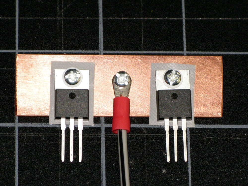

@Paulo: If the U-shaped heatsinks do not fit your choice of transistor, you could try a flat strip of copper or aluminum, especially with TO-220 package.
It is a little more complicated, because you have to use an insulator, and you probably need a grounding jumper for the heatsink. If you look carefully, there is an unused drill hole and pad in the center of the board to use as an anchor point for a common flat heatsink.
I thought about using one even with the smaller package, but it did not turn out to be necessary.
