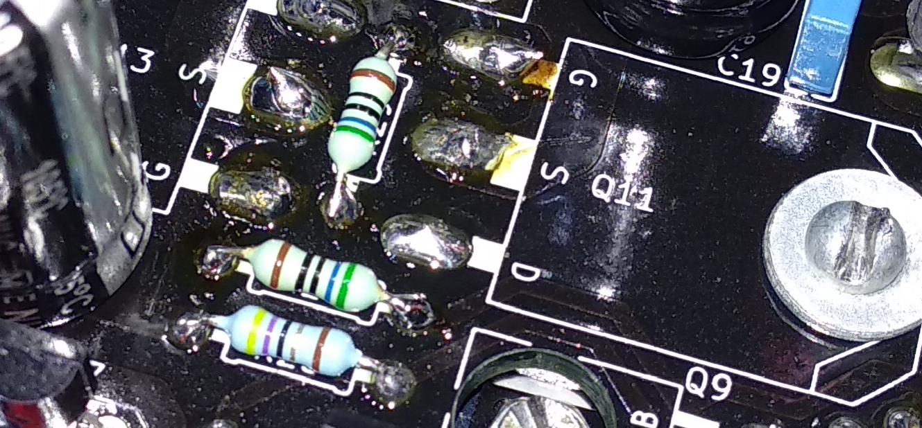

R27,R29 and R28,R30 i.e. the gate resistors (initially 330R and 220R), all increased to 560R (and gate-source capacitors removed).
Now there is absolutely no parasitic oscillation in any of the channels, that tested 8 pairs of old and newly bought non-matched Renesas MOSFETs, and are perfectly stable for any signal level. Unlike the capacitor trick this solution has zero footprint, is symmetrical and works consistently. So I will update the original design with this one. If anyone is facing the same problem with 2S MOSFETs then please replace the 330R and 220R resistors with 560R. If biasing and offset trimming was done already then don't worry, DC operating conditions won't be affected after installing the four resistors.

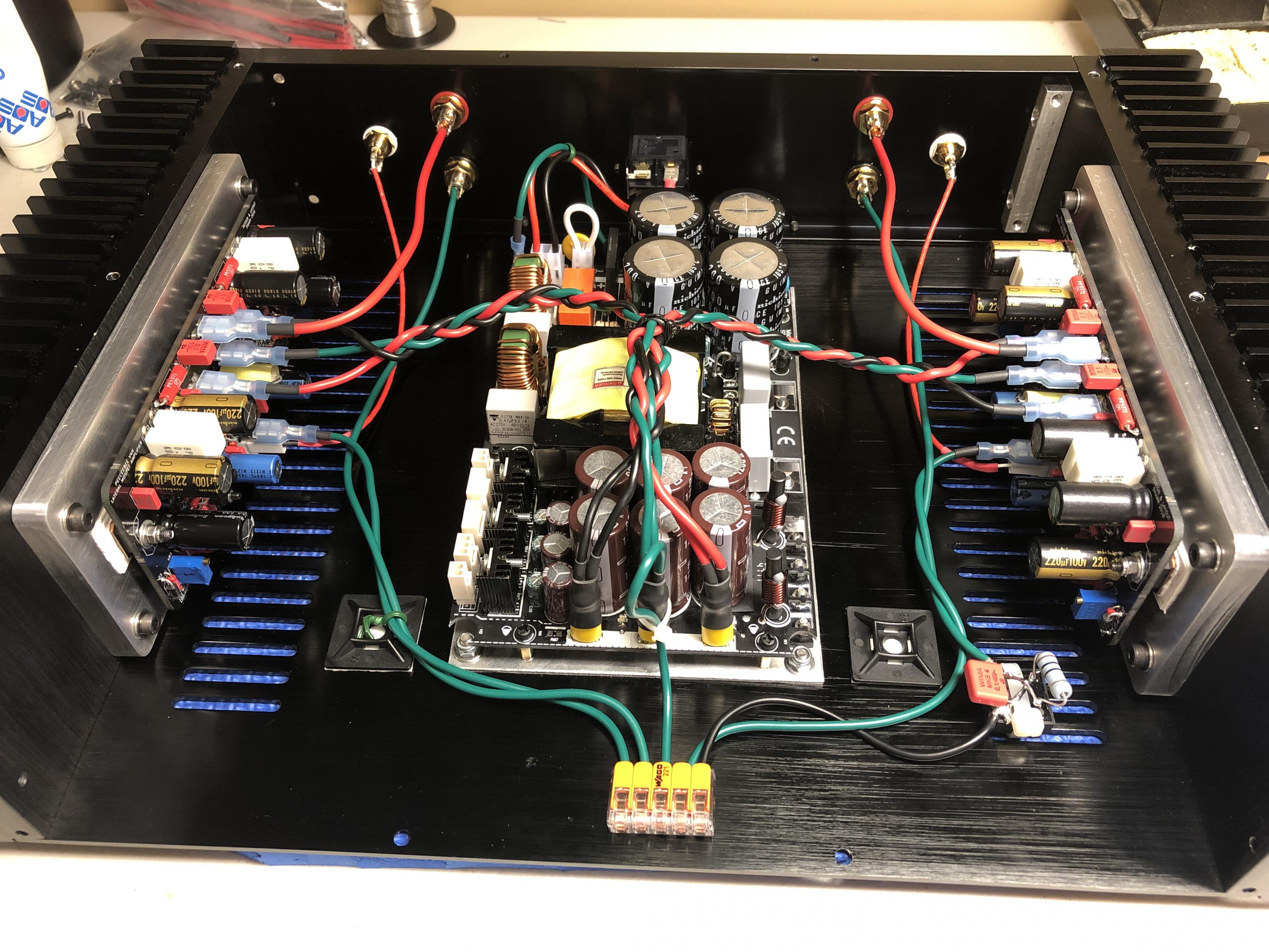

For the past two days I’ve been enjoying my fresh new V4H.
Today, after several hours of playing when the preamp volume was decreased to low level listening the V4H started to act strange. The left channel would drastically reduce in loudness, almost muted. When the volume was turned back up no problems at all, it has only happened when the volume gets turned down low. Then I read your last post that oscillation could still happen even with the 270pF caps I have installed. First, is this a symptom of that very problem? Should I stop using the amp until this is fixed?
Vunce

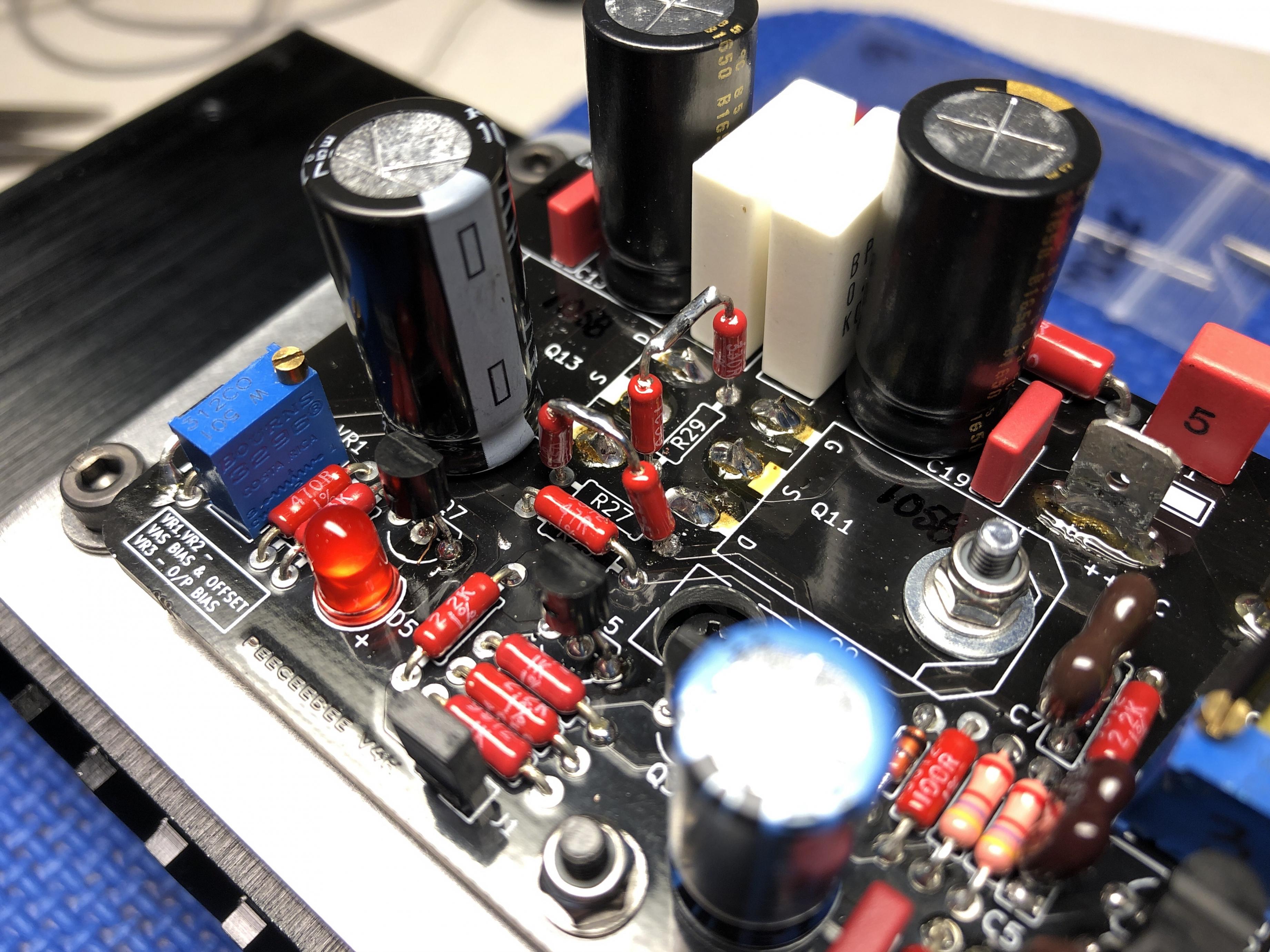

I’m using my AKSA Lender preamp which has a stepped attenuator, no carbon wiper here. This has not happened with the other amps I use. I will dig in again today to swap resistors as per Shaan’s suggestion.

So I’ve been using the V4H constantly, approximately two days, since R27-R30 were increased to 550r. I’m happy to report: No funky behavior! I’ve used different preamps with high gain, low gain and no gain(B1 buffer). In my system the B1 works very well with the V4H.
Thank you Shaan for sharing this fine project:)
